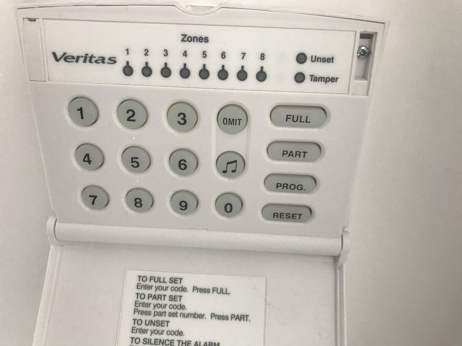

Hi guys, I've got a failed keypad for our alarm system. Everything else is working fine plus there is another keypad that is also working.
I have a feeling that it failed due to lighting a while ago but am only getting round to looking at this now.
Attached is a photo of the unit.
Can someone please talk me through the process to replace?

Firstly I would check voltage at the keypad, should be about 12v.
Secondly I would swap the two keypads to see if the fault follows the keypad, this will prove its the keypad or cable at fault.
sound advice.
if the keypads are the same ie,the other keypad is another remote led keypad rather than part of the main control panel, I would be surprised the lightening didn't take them both out as somewhere along the line they are connected together.
Perfect thanks for the help. Do I need to power anything down prior to swapping? Also trust there will be no reprogramming needed when I replace? Many thanks
just need to make sure the address is the same as the unit you replace, if it needs replacing.
its always best to down power, if your panel has glass fuses you could just pull the keypad fuse, if you have it live, you may short the new keypad out if its shorted against a component.

Update.
Okay I've swapped the two keypads over and for some reason they are both working for me now :)

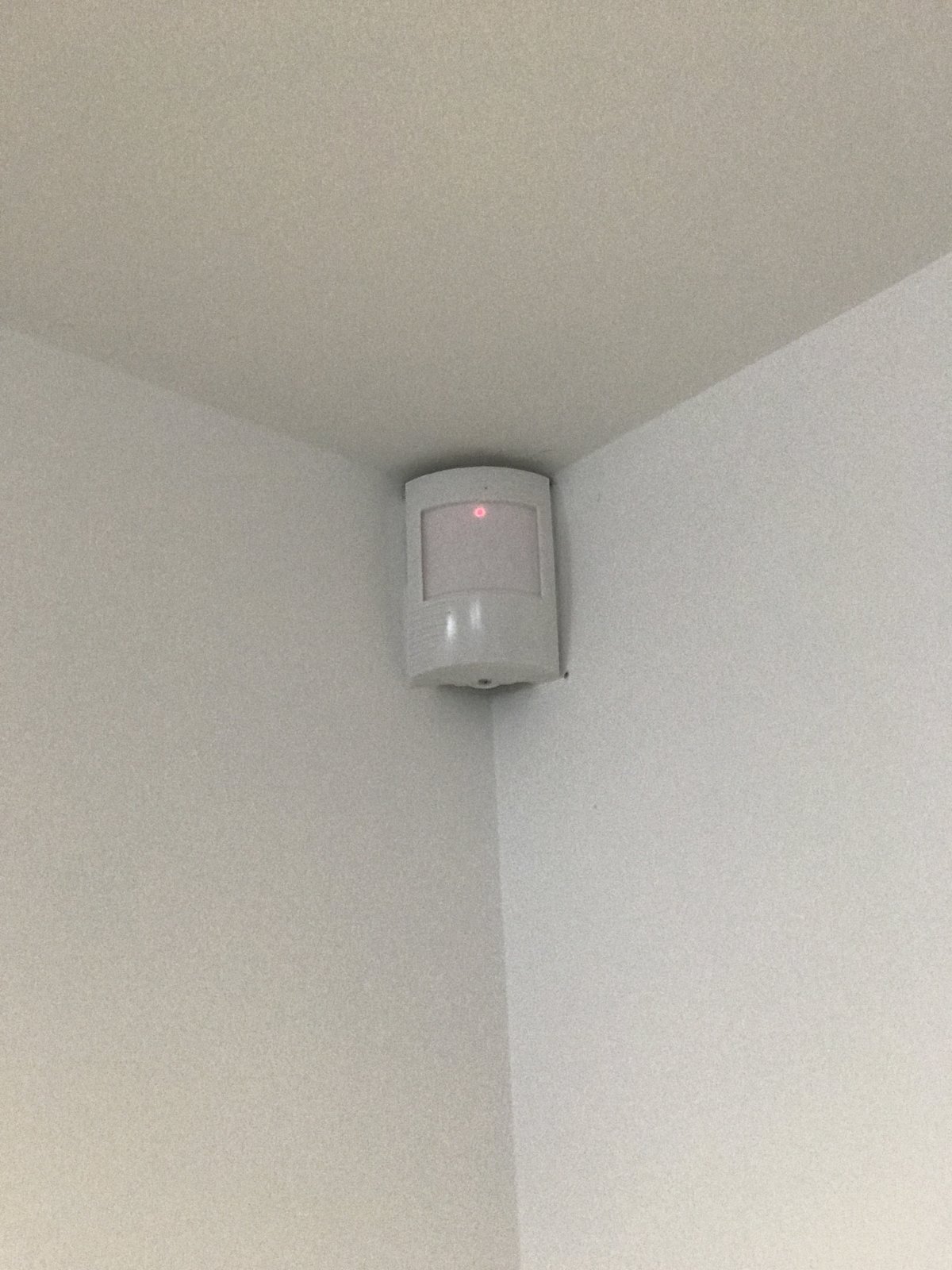

However I've noticed that when I try and arm the alarm prior to leaving the house it doesn't actually set but continues to cheep. One of the zone lights is permanently displayed as red on the keypad and when I checked in that room the PIR is permanently active with the red light being displayed. I trust this is the reason that the system will not arm? How do I fix this?

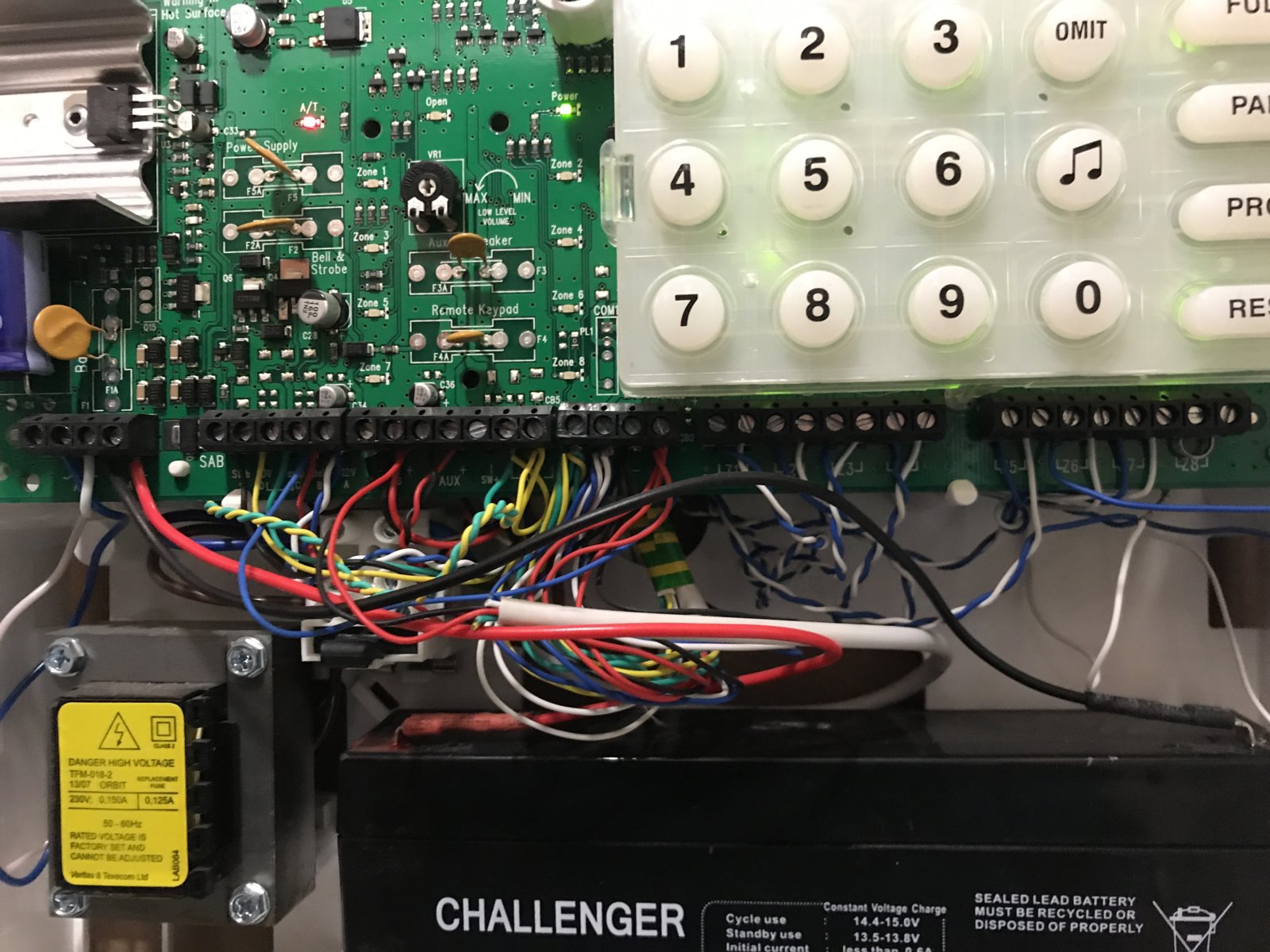

Thanks for that, would you mind explaining how I power it down? Cheers, Devs
I've removed the blue and white wires for Z6 within the control unit but the PIR still appears red. Trust I should be doing something else to power the sensor down? Thanks.
firstly what led is illuminated on the keypad (6)?
removing wires from a zone doesn't doesn't down power the pir, remove the pos or neg from the power terminals that the detector is wired into.
before that you could of started the arming process and omit 6 prog to see if the system started setting. If it was 6 led that was illuminated.
Hello mate and thanks for the reply. Yes its zone 6 with the issue. I'm not sure where the pos or neg are for zone? Below is a photo of what I can see:
The red or the black in the aux , below the remote keypad fuse
Post picture of pir with the led on , if it's a Pyronix colt/ magnum replace it
Many thanks I powered down the PIR and reinserted the wires and it just came back on red. Trust its a PIR replacement. see below:

There is no fuse ....just remove the positive wires in the aux , never seen a reflex led stick on , have seen a medusa with the led on , I would check the voltage at the detector as you have had a keypad issue , it may be a voltage problem
