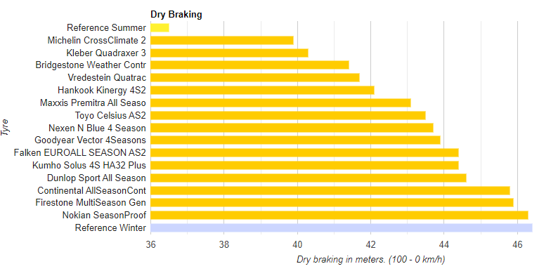

Better wet and dry braking is the main one, I think. Also better handling, if that is something that is important to you. Summer vs AllSeason example:
In a laboratory or under laboratory test conditions with perfect tread, perfect pressure and every other thing perfect including the driver.
But in the real world its just subjective, as they make no real difference otherwise there would be a requirement to fit them.

Summer tyre rubber compounds are geared to working best in warmer temperatures, just as Winter tyres work better at very cold temperatures. The best solution would be to have a spare set of rims with Winters and swap them as the seasons change.
All-season tyres have a mixture of characteristics that perform well in both seasons. They are not as good as swapping rims, but they are a good compromise.
And obviously you only need one set of wheels/ tyres.
And as time goes on, all-season tyres are getting better and better.
Here is a link to Winter tyre tests:
Here's a link to all-season tyre tests:
