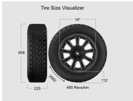

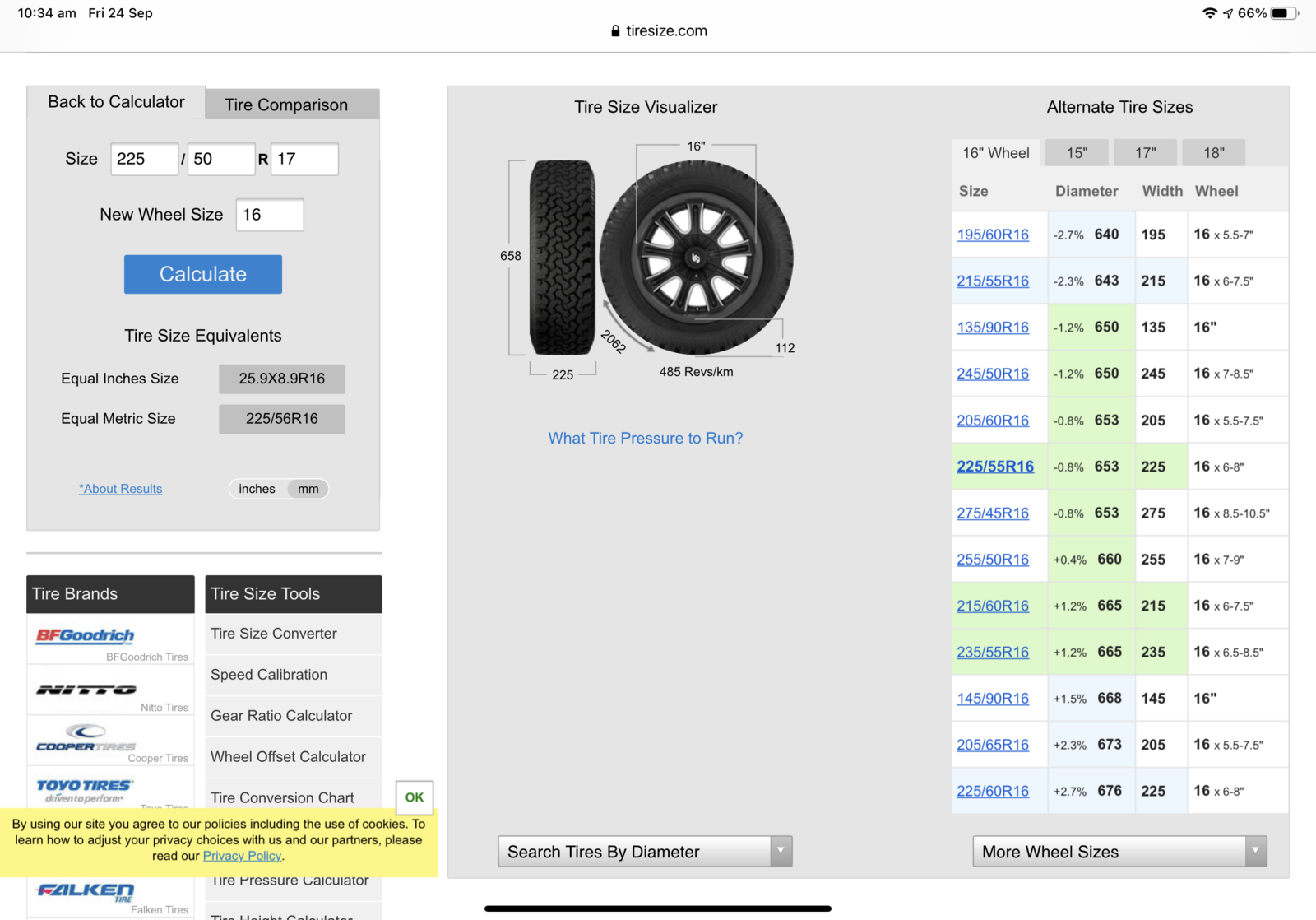

Are there any alternative sizes that will not alter speedo reading etc...?
What did you have in mind SS?
Not an expert, but arithmetically -
50% aspect ratio of 225mm. width = 112.50mm. height (rim to edge of tyre)
So if you calculate 11250 / width, this will give you the percentage required for the same height.
Therefore 11250 / 205 = 54.88% - so 55 would be the same.
However, I read that you can only have 195 to 225 on 7J rims and , obviously they don't come in infinite varieties.
She's had steel rims with winter tyres fitted and I wanted to check they were the right size.
Sorry, forgot to add the new steel rims are 16 inch.

Showing my ignorance here. If 225 is the width of tyre and R16 is the rim diameter, what is the 50 after the 225?
It's called the Aspect Ratio...the distance between the outside diameter of the rim to the outside diameter of the tyre.
