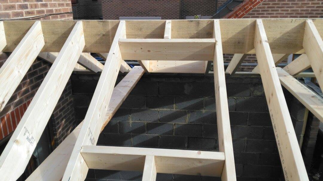

how long it takes has.been decided by the people quoting the job.. that is not in question here. from. what I am reading it wouldnt be plausible fit a joiner and his mate to complete it in 2 days.. so what I have is 2 skilled competent joiners doing a lot of work in a 2 day period. so with that in mind is a skilled competent joiner expensive booked out at 375 a day cash in Yorkshire or is that reasonable? 1 of them already did my vaulted sun room roof in less that a day with a mate. see pic... horizontals went after ridge beam set on padstone.
I am no expert but shouldn't the the trusses around a velux be doubled up!
