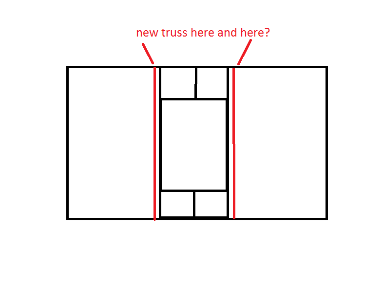

I am no expert but shouldn't the the trusses around a velux be doubled up!
Yes. These can be added after.

Now - are you guys saying my velux need extra trusses?
like this? or something different?
It just needs the rafter doubling up either side of the Velux.
I went away and had a read on the subject and all the hits are regarding when you cut through existing rafters.. this is not the case. My rafters are full length and made to fit the velux inside them. The velux weighs less than the roof tiles so why is the doubling up needed. I have the wood and dont think it will be a problem, just dont want to make work for myself unnecessarily. Also my rafters are 45x195 so not exactly little-uns.
Because based on your 400 centres, you roof strength has been cheated out of one rafter: the one that should be running right through the middle of the Velux that's now been trimmed.
doesnt it have a bearing that my joists are c24 and 50x195mm - at 600 centres c16 can span 4m! my span is about 2.4m
