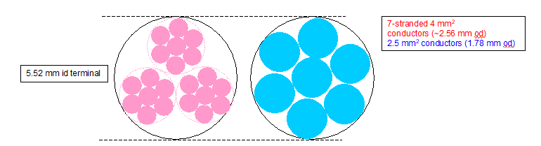

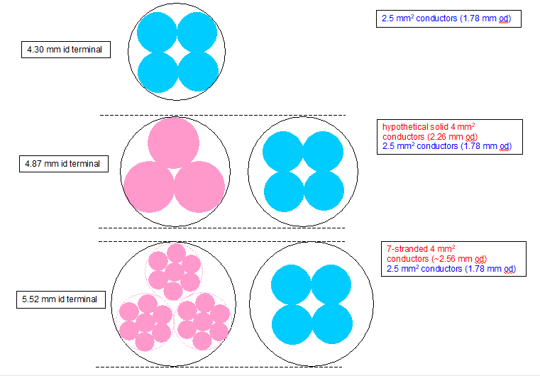

As others have said, you need to investigate why there are four cables there as it is unusual. You cannot use the socket you have bought. You do have four earths; one of the sleeves has two wires in it, and the bare wire is also an earth.
