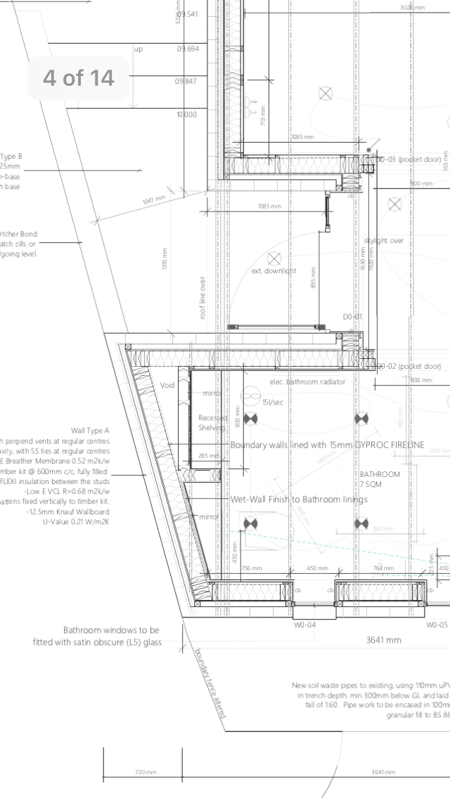

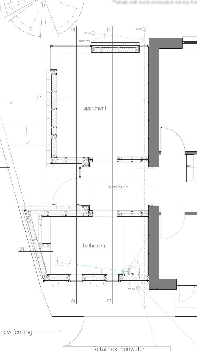

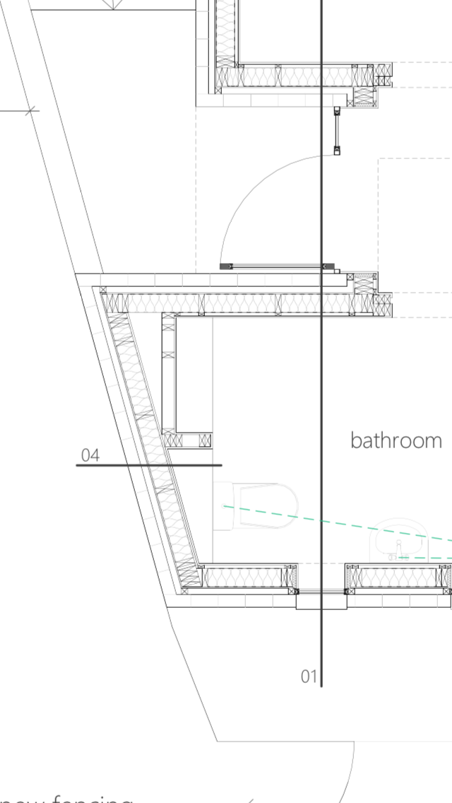

Looking for some ideas on building these two corners. As the customer doesn't want a birdsmouth. Am I looking at running a straight joint right up with ties in it??

Use cut and bonded brick,your merchant can order these using your face brick, make a template to suit.
Straight joints look shoddy.

The cuts need to be really accurate to make them yourself. You need a clipper rather than an angle grinder. The acute angle might present a few problems.
Aye Stuart it was that one I thought I was gonna have the most bother with. I've got access to a clipper so that's no an issue just never had to do it before so no wanting to make a pigs ear of it.
It hasn't got a straight joint, looks better than OP first idea.
I would use cut and bonded by specialist about £5 each, the sharp angle as Stuart says would be awkward to do yourself.

Ideally, external angle bricks as shown in your earlier photo are the answer.

Cheers for all the replys lads got in touch with the architect and he's gonna price up getting cut and bonded bricks made.
