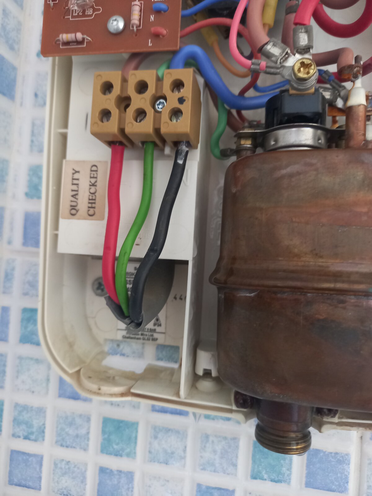

Current 8.5kw electric shower has expired. Like everyone, I would prefer if possible to be able to upgrade it.
I'll be honest, I've no idea what the current cabling is or fuse rating etc. What I do have is a picture, if anyone can decipher any info from it.
My question: assuming the current cabling is NOT suitable for a 10kw, what max can I put in? Can I put in a 9.5kw or even an 8.7kw? Or does it have to be a like for like, max 8.5kw?

The maximum load on a radial circuit is dependent, not just on the cable size, but other factors, like the fuse or circuit breaker rating and installation factors like the presence of insulation, grouping with other cables and length of the cable.
The commonest cable sizes used for electric showers are 4mm² (used on older shower circuits), 6mm² and 10mm². 4 and 6 can be distinguished by the fact that the earth wire is a single conductor. The 10mm² earth wire is stranded, IE has more than one conductor.
In theory, the fuse/MCB/RCBO size should have been selected to protect the cable, but it depends if the original installer followed the rules? I can't work out size from the picture, in the main I work out size by trying 6 mm², 10 mm², 16 mm² etc crimps on the cable and see which seems to fit, so will not fit blue and loose with yellow likely 4 mm² and tight with yellow 6 mm² in theory can use a micrometer or vernier but in practice not easy.

Green earth sleeving. Suggests it's over 45 years old.
Hmmmm.
The cable could be 4mm2, as was common for showers back then.
You need to determine the cable size.
I would recommend buying a 1 metre length of 4mm2 T+E, and a 1 metre length of 6mm2 T+E, strip the ends, and closely compare.
4 square is hardly a common size for a shower. In fact I would suggest that it's vanishingly rare to come across.
It was very common in the days of the first electric showers, which were often sub 7kW. I have seen loads of shower circuits run in 4 Milli and installed by Norweb (as was then).
Many were Dolphin Showers, installed in the 70s. Sometimes they had a Dolphin shower enclosure ( you had to have a bob or two), or more often installed over the bath.
