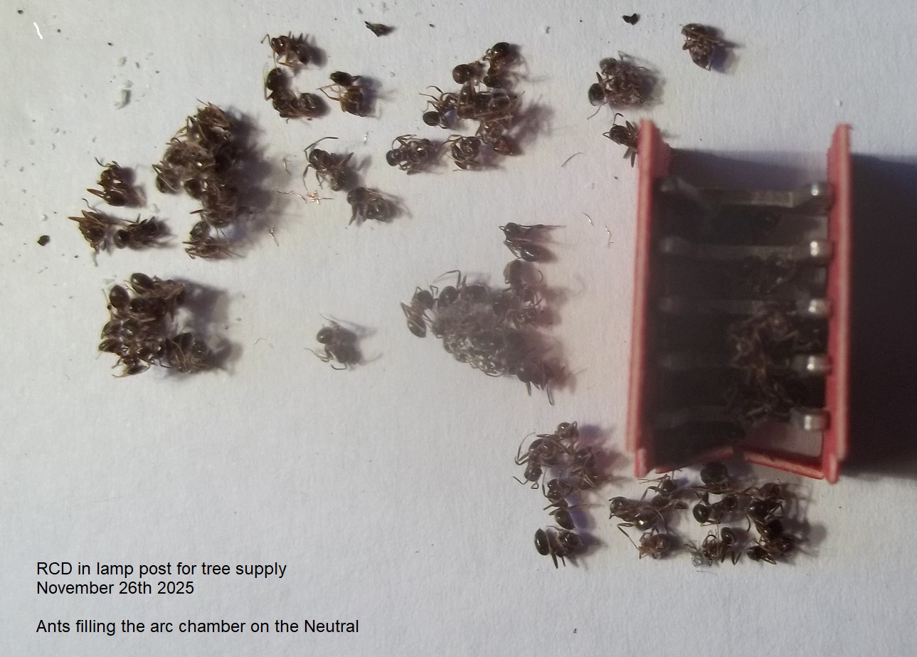

Checking the electrical supply for the village Christmas Tree. Found there was150 volts Line to Neutral due to the Neutral from the RCD being high impedance.
This was found when the RCD was taken apart.
Checking the electrical supply for the village Christmas Tree. Found there was150 volts Line to Neutral due to the Neutral from the RCD being high impedance. This was found when the RCD was taken apart.
It must be my old age again .... can you explain how 'what was found' explains the 'explanation' you mention ? ;)
The remains of ants on the contact pads of the switch prevented metal to metal contact for the Neutral
I recall now that a similar attack was made on the same lamp post in December 2020
Do not let it become such a nuisance that you decide to become ANTi-RCD will you?
Perhaps the ants ANTicipated N being Closer to E in terms of voltage differential, they are intelligent you know!
Oh, I didn't realise that there were 'switch contacts' in that chamber.
However, if the ants managed to get between the 'contact surfaces'of the contacts, they presumably must have 'got in' whilst the contacts were open. That would be very rare, and very brief, for most RCDs in domestic installations, so was this perhaps an RCD which is 'switched off' for most of the time other than around Christmas?
I is permanently connected to the supply ( all year ) in the lamp post but only switched on for the duration of the Christmas period. The rest of the year it is acting as an isolator.
