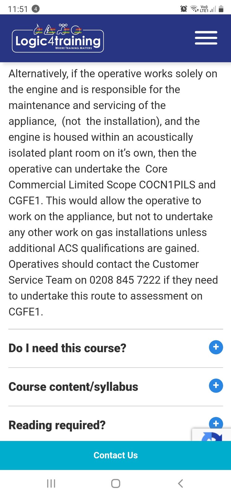

You might not need to do the full commercial core
https://www.logic4training.co.uk/course/cgfe1-gas-fuelled-engines-course/

If the engine is under 1.8MW then It’s covered by gas safe legislation, as such your engineer will be expected to hold either limited scope commercial core and CGFE1 as long as the engine is within its own enclosure, if the engine takes its air from within a plantroom your engineer will be expected to hold full scope commercial gas core and CGFE1
above 1.8MW is out of gas safe scope and you need to prove competence either through OEM approval or IGAS.
