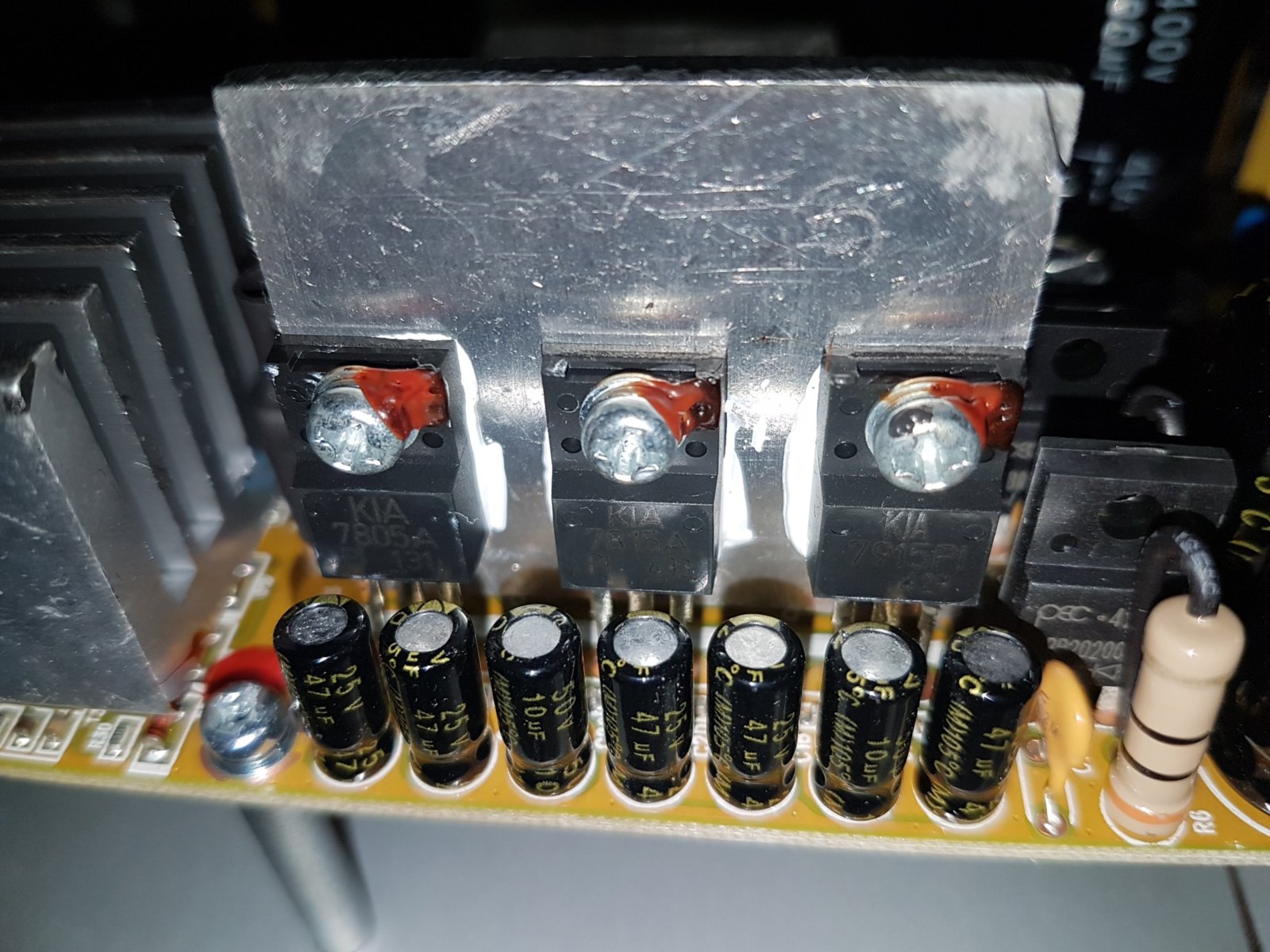

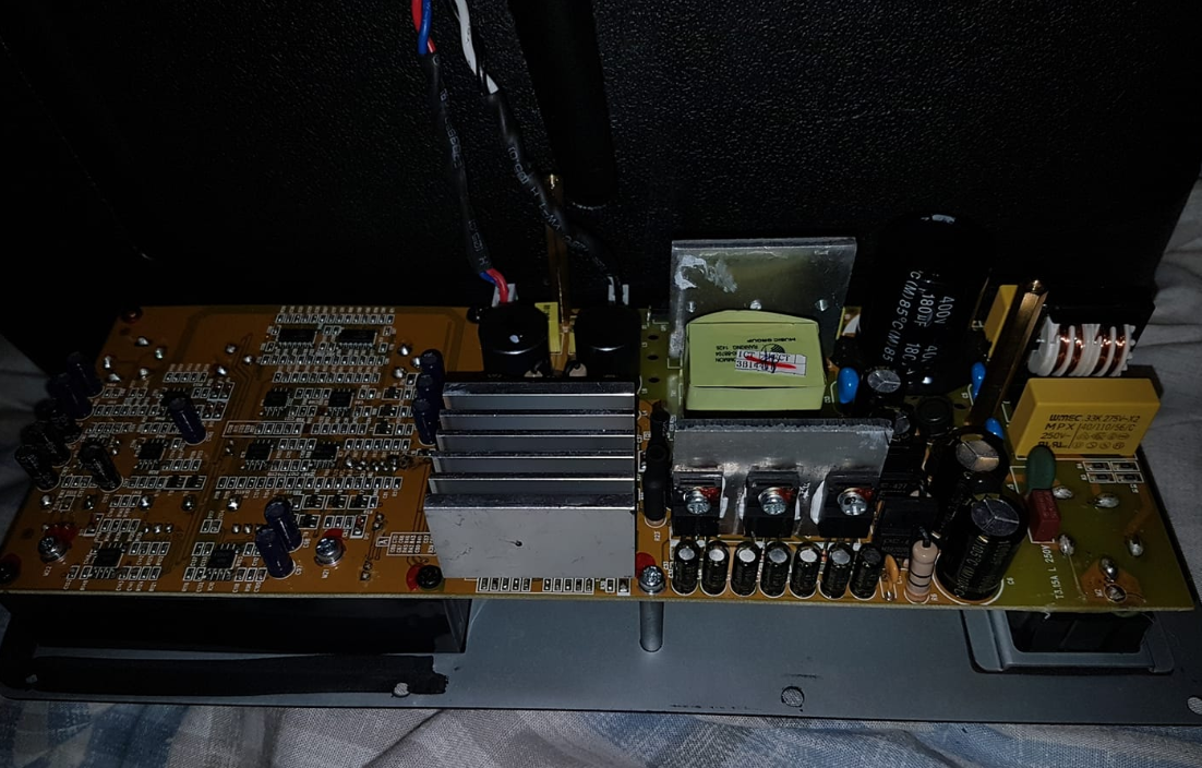

anyone good with Class D amplification? I have an active speaker here, it powers on ok, i must had overdriven it as it did get a bit hot at a gig one evening, anyone know what the most likely part of it to fail would be if it's overdriven?

The packages marked 7805 and 7915 are +5VDC and -15VDC regulators. If you have an oscilloscope you can check their output is stable. Or they're so cheap you can replace them anyway (don't forget to remake the heat management if you do).
Nozzle
thanks so much Nozzle, is it possible to advise on the items? where to purchase, im just scared I buy the wrong regulators, I don't have a scope but I can certainly change them, the paste, is it just normal thermal paste I apply?

If the amplifier stage itself has failed, you can't repair it unless you can solder SMT, forget about it. If the power supply has failed (the through-hole components to the right have a fault you'll have better luck). You can go to somewhere like CPC Farnell, Rapid electronics or RS Components. Or ebay.

If I had to guess***, I'd be looking at the four switching devices already mentioned by BG. This is because these are likely to be the most stressed parts, and therefore possibly the most likely to fail. The devices mentioned by Noz might indeed have also failed, but they wouldn't be my first guess.
Once you have found them (it is not clear from the photos where they are) I would replace all of them. I would even try to identify and use higher quality and/or higher-rated but otherwise equivalent parts.

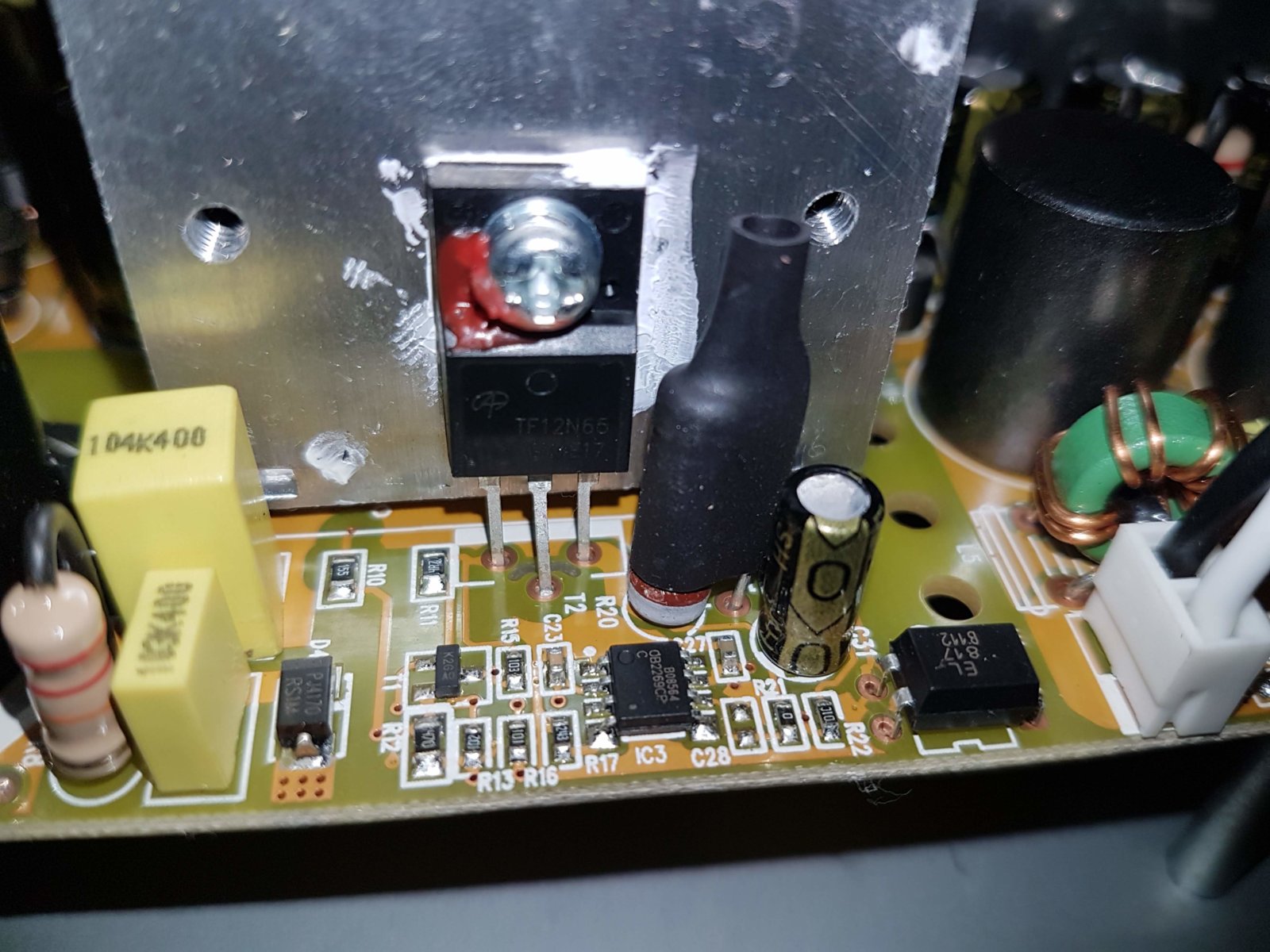

@ OP - are there any signs of any devices near that heatsink in the middle of the board?? Any chance of more photos from that area including the large all black cylinders? Both sides of the PCB please.
Also if any of those electrolytic capacitors (the cylindrical shaped things with the metal ends) show any signs of distress, and particularly any signs of bulging (e.g. at the ends - like that middle one of 7, maybe), then these need to be replaced too.

My money would be on the main switching devices being in/under/attached to the big finned heatsink in the middle.
Assuming no schematics available, it'll need some tracing out - difficult on double sided boards where tracks disappear under components, and all but impossible on multilayer boards.
I'd be looking at the main output stage and seeing if the power to it can be isolated - I've cut tracks on boards to do this in the past as a "divide and conquer" approach. If disconnecting the power to the driver stage allows the rest to operate then that points towards the main switching devices.
Alternatively, simply remove those devices and see if the system will then operate. In either case, you'd need a 'scope to see if the input and converter stages are working.
