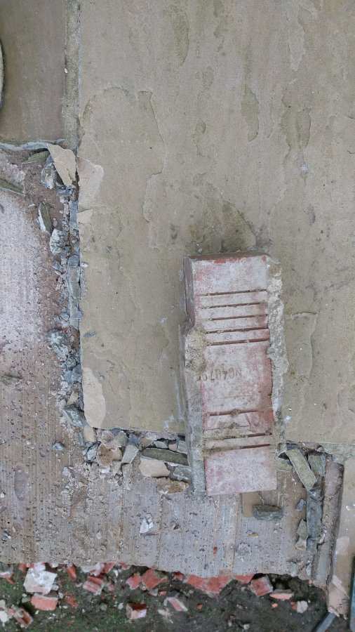

I am trying to find out of this brick is from the 50/60s.I don't think it is but wondered if anyone could have a guess? It's got round holes in middle with a smooth red face. The pic shows the back end it it.
I realise its such a rough guess but trying to discount something

It's a guess based on the machine grooves, which tend to be a modern ish thing. But looking at your question again (I read 50's :(), it is potentially a 60's brick, which could be late 50's.
So wait for some other more certain comments.
It is imperial size isn't it? ie about 73mm high. The other two dimensions won't matter.
I'm pretty sure LBC, and presumably others, were making bricks with the grooves intended to hold plaster better, in the late 1940's. I saw them documented with "Phorpress" which were popular in the 1930's. IIRC the grooves or channels were wider than your example, half and inch or so. Have also seen them in the London Underground on walls that have been tiled. The station I'm particularly thinking of was started pre-war and finished post-war.
It's 21cm by 6.5 cm high.

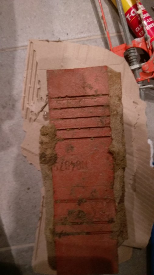

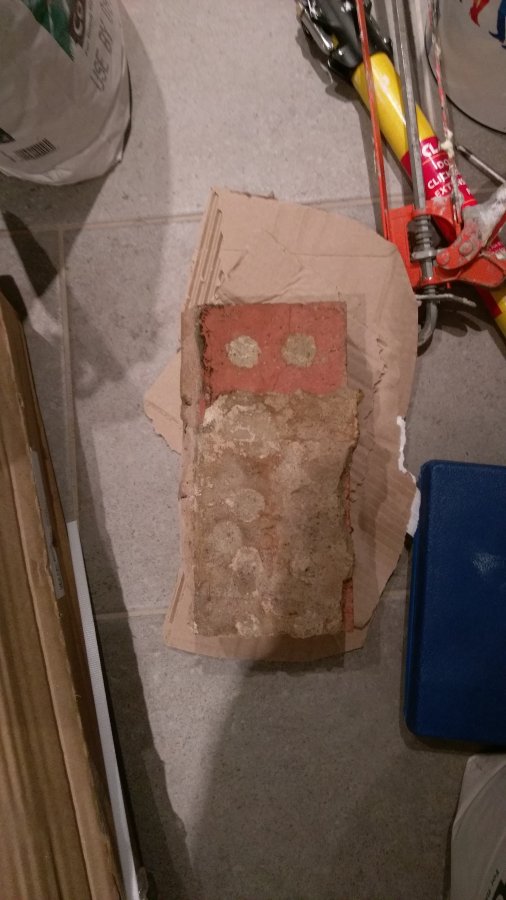

The groves are the back end of the brick. Smooth Faced. What do you mean markings in the frog? There are some numbers written on the back to
marks like
No nothing like I have put a photo of the top of the brick. It has those holes all the way along. And number written on side which I have taken another photo of

Metric bricks came in round 1974 (215x65x102.5). Before that from 1965 they were 8 5/8 x 2 5/8 x 4 1/8. Before that there were a few different sizes.
Yours looks like a metric common extruded brick.
the holes suggest it is a more modern extruded brick. Don't know when they came out. The grooves I think are to improve plaster or render retention. Why do you want to know? If you want to match it, try a local salvage yard.
