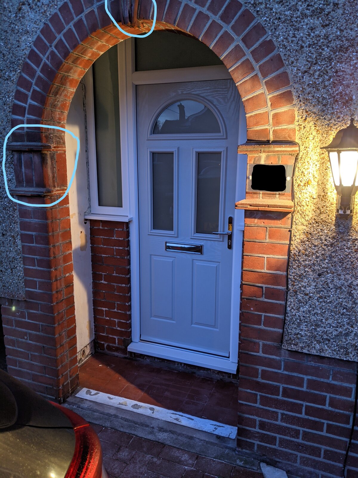

Just had a new door installed and an outside door in the arched doorway was removed. Not sure why people have 2 doors to be honest...
As you can see from the photos the thin decorative bricks have been cut away to make way for the door which has since been removed and I would like to refurbish the arch to it's original state.
Can anyone tell me where I can find those thin 12mm thick bricks / tiles (not sure what they are called) and the best method to install them.
While I'm here... what would be the best product to clean those bricks up with, no that I have removed the plaster?
They are clay roof tiles. Snap or partly cut out with a grinder. About 50mm worth of tile, not all of it.
Cleaning product could be detergent and wire brush

To replace those roof tiles, you would need to add in a temporary timber support for the arch, similar to what was used when it was built. Maybe a chance to install some sort of figurine from a reclamation yard.
I think brick acid would clean the bricks up, but see what others suggest - but take suitable precautions!
