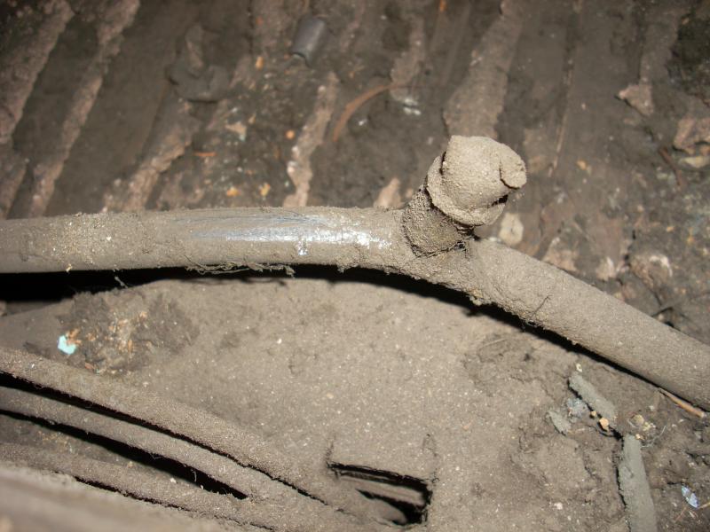

Been in my house (Victorian terrace circa 1900)for three years now. Upon moving in I removed quite a lot of unused lead piping from the cellar, which I had assumed was from the old water supply.
However - now decorating the upstairs back bedroom and lifted a couple of floorboards to find that there is more lead piping under there, which seems to lead to an old (unused)outlet by the fireplace. From this I assume it was a gas pipe as why would you have a water supply going to an open fireplace?
Anyway - assuming that, and the fact that the lead pipe is safely beneath the floor and unused - is it safe or should I rip it out?

If I can find an open end to the piping upstairs then I guess it must definitely be disconnected!

If it is an old compo gas pipe it will be roughly the same diameter as copper pipe and as it is thin walled can be easily moved/bent. It looks totally different from a lead water pipe, which is heavy.
You will probably find old lead gas pipes under the boards of every room as old houses had gas lights. It is unlikely to be connected to anything but if you are not sure get someone to check it for you.

Its a gas pipe probably dead. Wipe the dust off the top of the tee part where it is cut.
sorry cant tell if the is an open end or not.....u look !!
also, look at the meter...if the gas pipe just goes outside in copper to a boiler/cooker and u cant see it going through the wall anywhere else then may be ok (ie dead)
It's definitely disconnected.
