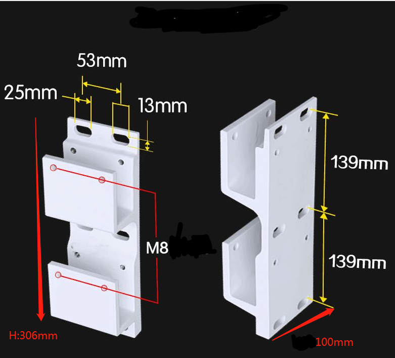

Hi, the plan is to cut out render/insulation to reach the wall, properly thread the rods in with resin/epoxy. Use 2x stainless steel plates 10cm apart as guides to keep the rods true and straight. Properly backfill the hole I made in the insulation and cover it up. The wall is 20cm thick made out of hollow bricks. Given that the M10 rod will be 15cm in the brick and 23cm in the open, will 36 rods be able to hold 400kg? Attached pic is of the awning's bracket that's supposed to be attached to the wall, there's 6 of them and each one takes 6x M10 bolts to attach to the wall. Does this read like a sound strategy?

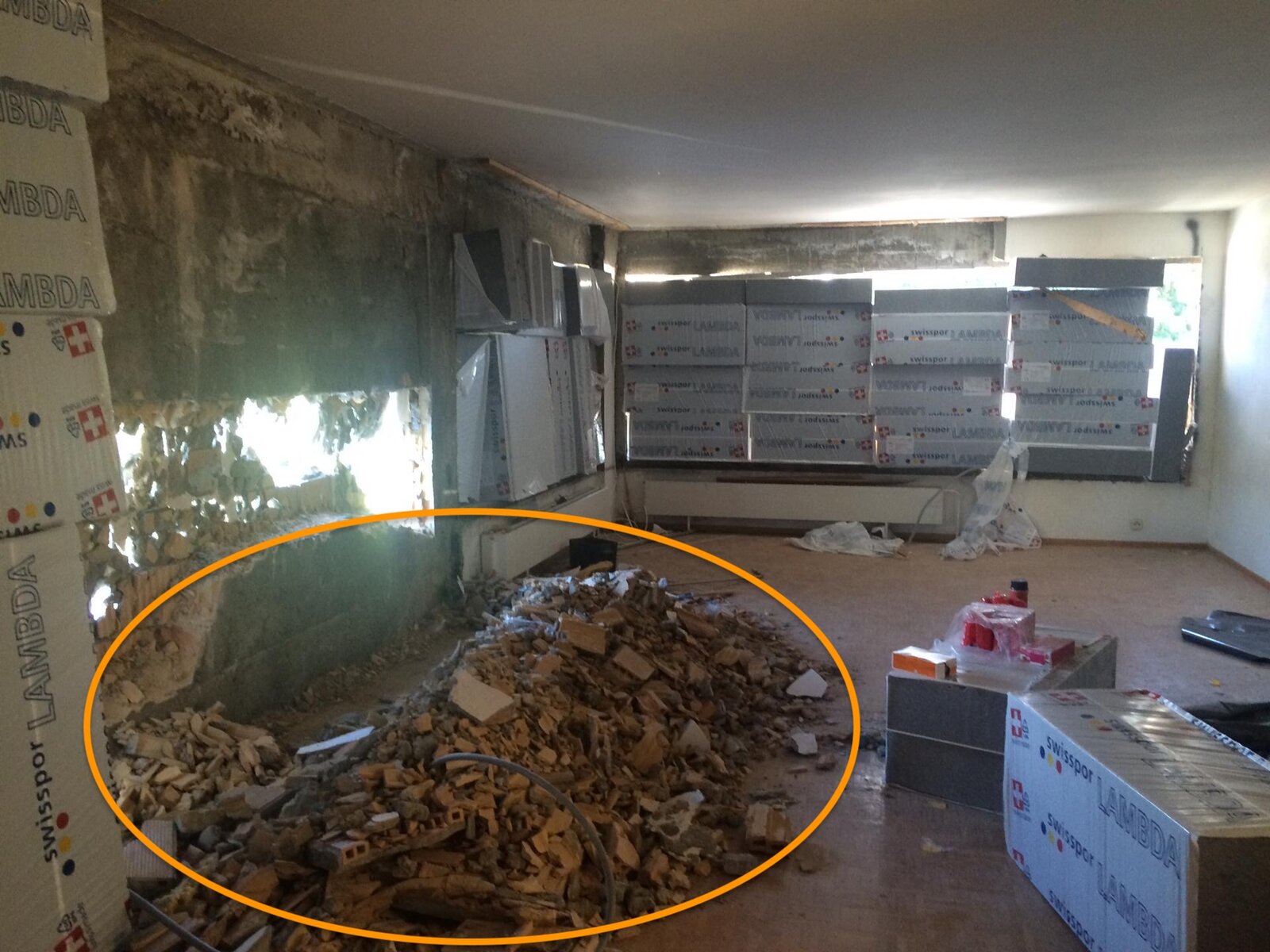

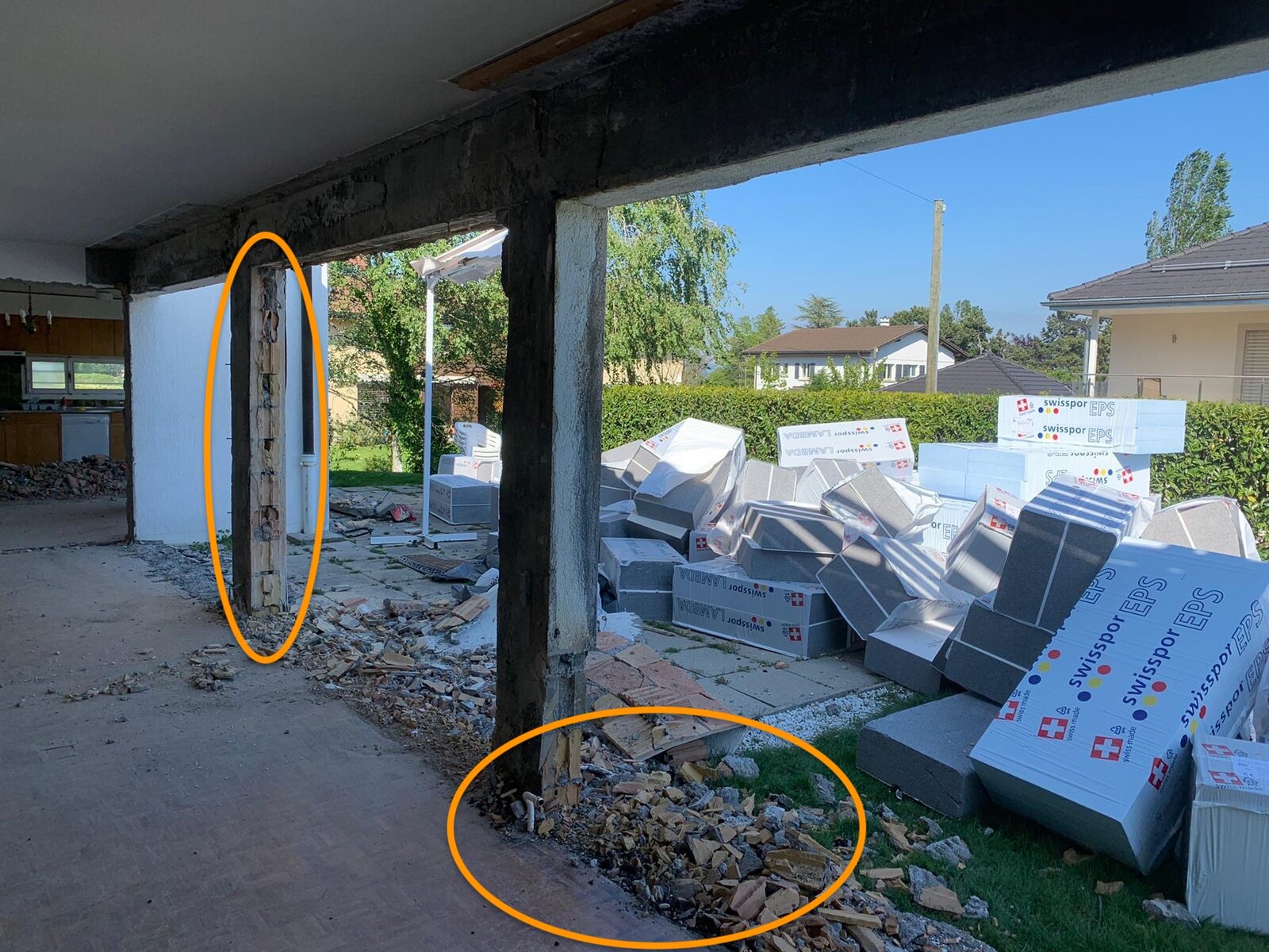

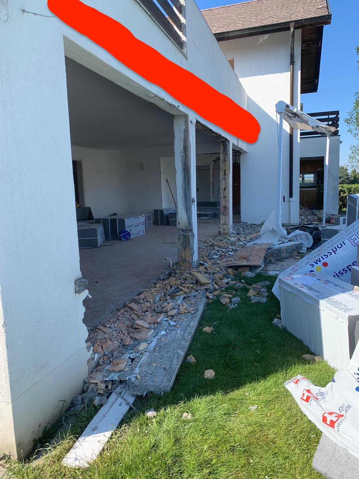

I found some photos from when we were renovating. Picture one shows where the awning will be attached to the wall. This pic is before the insulation was put on. Picture 2 shows the hollow bricks to give you an idea what kind of bricks have been used. Picture three also shows the bricks used in construction. Plus you can also see that if I were to drill straight through the wall then it'll be visible in the lounge.
