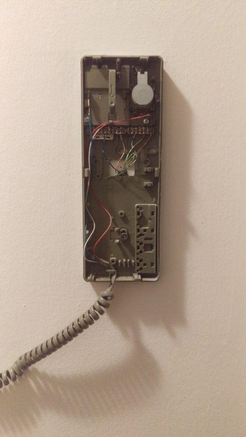

My flat has an Urmet door entry system and I want to perform some automation depending on how the caller outside presses my buzzer .
Essentially if I forget my keys outside of service hours I could hold my buzzer for 30 seconds and it will just let me in. Ideally more complex rules could be used to make it more secure, for example buzz between 5 and 7 seconds then buzz between 2 and 5 seconds then buzz again between 20 and 23 seconds.
There is space behind my Urmet 1130 telephone handset for any further hardware that could monitor the signals coming and provide its own dooring opening response if the correct pattern in matched.
It looks like I will need to find the wires that relate to the door buzzer and door lock then convert those electric signals into something that can be read by a computer program so it can perform some logic to determine whether to provide its own response while at the same time relaying all original signals to the handset.
Can anyone advise how this could be achieved? I am comfortable working with the software side of things but I am not sure how to get there in the first place.
