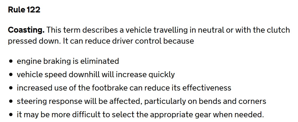

I think it's actually illegal.
Highway code...
So, it's not recommended, indeed, but it is not illegal (or it would say "you must not" and have a link to the relevant legislation below, which it doesn't).
