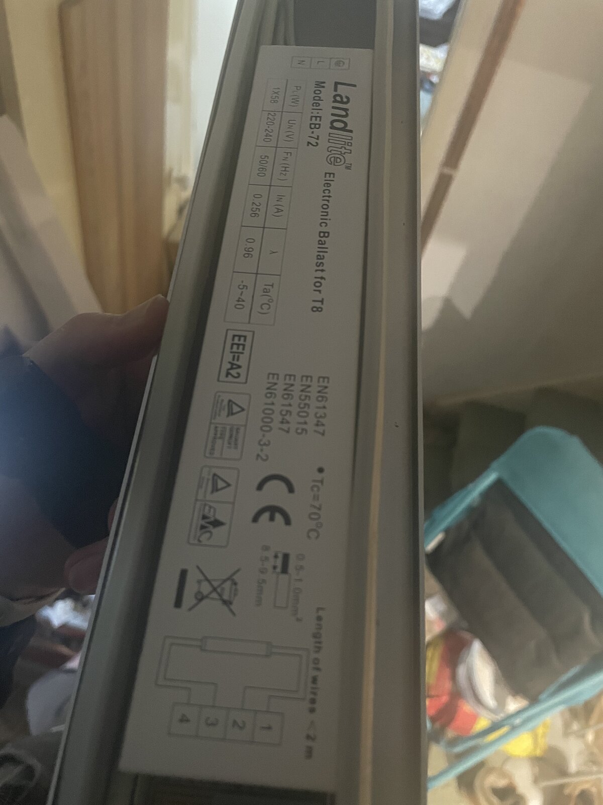

I have a T8 ballast to replace in my strip light. I took it down hoping to replace it with exactly the same part. However I don’t seem to be able to locate the particular one that’s in there. I’m not sure which spec I have to be careful to match to ensure it’s the best alternative and make replacement as easy as can be.
Can anyone offer guidance on this please? Pic attached. Thanks in advance.
As someone said earlier its the fixing centres that may be important, a shorter ballast may involve extending the wires, and as its special wire you may not have any.
A longer ballast will also do the job but may involve redrilling the fitting to fit and that is not always straightforward if the existing ballast is mounted on studs.
The knightsbridge is long for a ballast, whereas Tridonic is a lot shorter.
Measuring the fixing centres would be a good start
