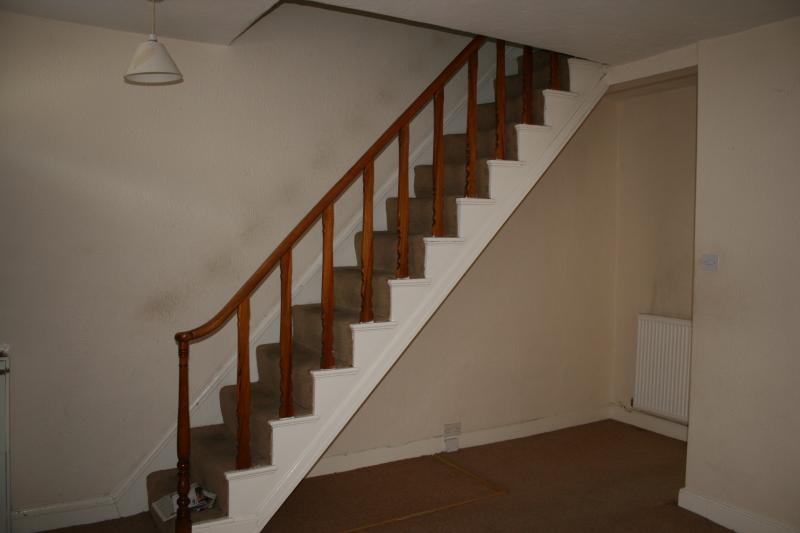

I am the landlord of a house that I rent out.
A new tenant has just moved in and is complaining that the balustrades (uprights) of the stair bannister exceed 100mm according to the Part K of the building regs.
None of the past tenants have mentioned this before.
As this balustrade was like this when I bought the house 8 years ago I was wondering if building regs were retrospective or they just apply to new builds?
ie they would apply if I ripped this balutrade out and replaced it with a new one but do not apply if built before the regs came into force.
I am also having trouble finding part K regs to download off the web - all the ones I found seem not to load for some reason.
Could anybody point me in the right direction for a good copy that I can download.

As the house is an old terraced, well over 120 years old, I doubt that building regs even existed then (or did they?)
The original spindles (better name than my balustrade) have been replaced at some time with 1/2" timber cut into shaped spindles and varnished.
I suspect that this work was likely done around the 70's as it is that sort of style.
I like your suggestion of just boarding it over.
I am not quite sure why the new tenant is complaining of this as he does not have children and he certainly could not fit his head through the existing gaps.

If this works it should be a photo of the stairs
The spindles appear to be slotted into each stair tread and, as you can see in the photo, there is one per stair tread.
Having seen the photo i need to re-phrase.
Get it sorted before a child falls through one of those enormous gaps! :shock:
There are usually two spindles per tread!!

The top of the stairs is a small landing with 3 doors. The only spindles are what you see in the photo.
As I mentioned earlier, the house is 120 year old and there are probably numerous things that do not meet modern building standards.
For instance, I believe that modern stairs have to be a certain angle with a minimum of headroom to the ceiling with the steps a specific width.
These stairs certainly do not meet modern standards as they are very steep compared to modern stairs and the steps are a lot narrower.
You almost have to duck when going up them.

As Hertsdrainage suggests, bang some hardboard over it (on the stair side) so that it doesn't look nice from below but satisfies safety issues.

if a repair[like for like] takes place then the regs as appropriate when fitted apply
by this it means the origional stairs unalltered but repaired in the origional fashion will be the regs at time off build
if its an alteration the regs applicable at time off alteration is applicable
if its a remod/alteration/bring up to date then up to date regs apply

Sorry big-all but that's cobblers. Whilst landlords have a duty of care they are not obliged to bring everything up to modern regs standards.

I will certainly go down the boarding in route as this seems to be the easiest to solve the problem.

Big-all is correct.
Whilst b/regs do not apply retrospectively and there is no requirement under the Building Act to bring property up to new regulations, this is irrelevant when it comes to other legislation.
The Building Act is just one of many laws, all safety related, of which there needs to be compliance. As I mentioned above, the DPA 1972 is just one of several other statutes, which can puts a much greater onus on the building owner, to ensure the property is safe.
The fundamental part is that whilst the b/regs may not require the banister, or any other part of the house to be compliant with the latest regulations, other legislation may require conformaty to b/regs standards. Even when the b/regs do not apply, they can be, and are used as a minimum standard for other legislation
