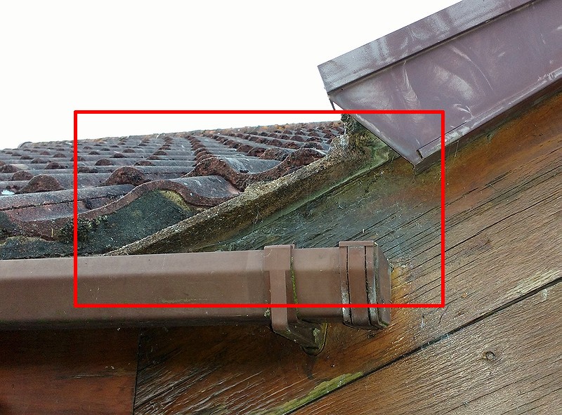

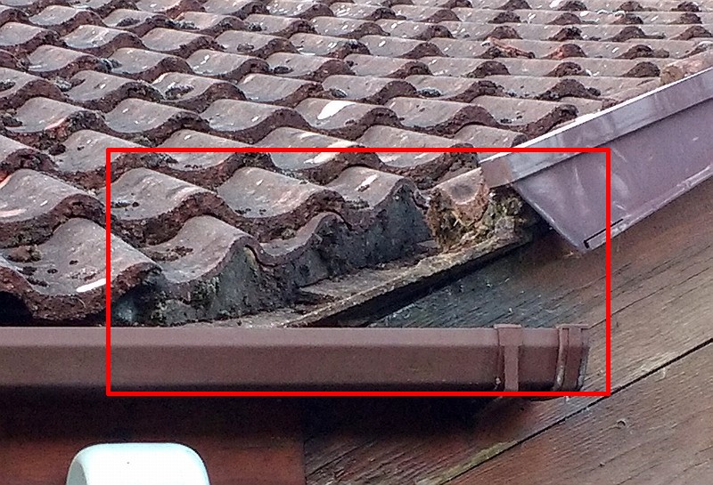

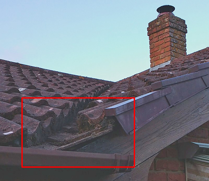

Recently moved and noticed that where our garage and bungalow roofs meet just above the guttering, there appears to be a cover or something else missing on the end tile - underneath the tile looks exposed to the elements so just concerned that with rain and a strong wind, water will get blown under the tile and cause internal damage. Photos attached, area marked red. Any pointers greatly appreciated!

That is a crap detail.
We build this particular junction so that the valley finishes a course or two tiles short of the gutter and spills onto the tiles on the opposing elevation - via a lead soaker. Easier to do with a dry valley and regular valleys - not so easy with a tiled valley.

No I haven't and I did scratch my head the first time I came across it. I've done a few since and they look and perform a lot better.
It's the unique junction where you have a valley terminating at a gable verge.
In the OP's image the bottom course on the left should have been kept whole and extended across so that the valley ran onto these tiles and then into the gutter.

Thanks everyone for all the insight. Question is, is it fine to leave it as it is - underneath of the tile looks very exposed to the elements!
The original picture Shows the bottom of the valley and verge detail.
Its not normally finished like that at all.
Before the valley tiles were cut and fitted a lead saddle should have been fitted this would have protected the timber and also diverted anything from the verge into the gutter.
How ever, it wont be too long before the valley fails and will need replacing. Then it can all be corrected along with any timber rot.
