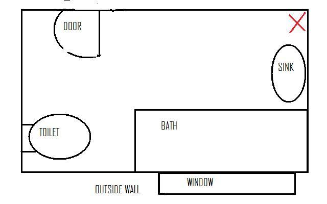

Can anyone tell me where I can locate a ceiling extractor fan? would it work sufficiently where the red cross is. I can;t put it directly above the bath as it is a sloping ceiling.
The pic is quite small so the outside wall is the bottom of the picture, the bath is on the right hand bottom and the door the top left. The bath is located beneath the window.
