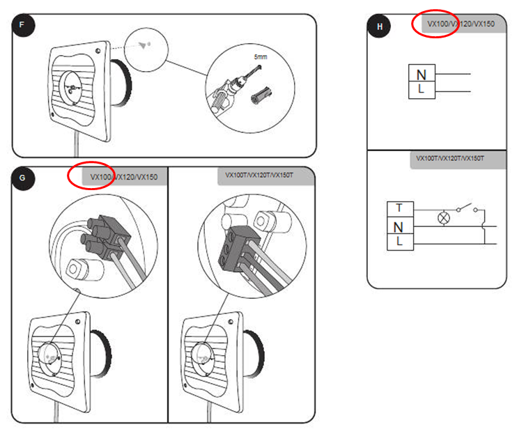

I should have paid attention to how the old extractor was wired in but I didn’t. I’m now finding that my extractor is running continuously.
It has 3 terminals: L,N,T
I have 3 wires in the supply side: live, neutral and switched live (connected to light switch)
I put the live into the L terminal, Neutral in N and Switched Live into T.
Can you please advise on where I’ve gone wrong.
Thanks in advance

If that were truly what you'd done, you would not have done anything wrong - but, as above, are you sure that you have identified the conductors correctly?
If you had 'swapped' live and switched live, the extractor would only be on when the light was on (with no timed 'run on'). About the only way (provided the extractor is not faulty) I can think of that might result in the behaviour you're describing is if you had connected the neutral to L, the live to N and the switched live to T (i.e. if you had 'swapped' neutral and live).

Your connections are correct. Either the timer needs adjusting or the timer/fan is faulty?
I've just checked and realised that my extractor does not have a timer function. I purchased this:
https://www.toolstation.com/xpelair-vx100-100mm-extractor-fan/p36701
The above wiring is correct as I tested it with a testing stick before connecting to the fan: live, neutral and switched live (connected to light switch). Dos the switched live need to connect to the Live terminal and the Live into the T terminal perhaps?
Then it doesn't have a T terminal.
So how can you have connected wires to L, N & T?
Those things are so unreliable as to be useless for this. If you relied on what it told you you could easily have misidentified the conductors. You need a proper 2-pole tester
No.

I definitely have a terminal for T but there is no wire going from this into the device. In the light of your response above, any cable going into the T terminal is just being terminated into that terminal joint? In my case, this is the switched live.

Put the permanent live into T, as it is not required. The switchline and N into L and N, the fan will now run only when the switch is ON.

You really, really should replace the fan with a timer version.
Thanks @Taylortwocities. I will also swap the fan out for a timer version.
Assuming this, does my switched live then go into the T terminal and permanent live into L?
