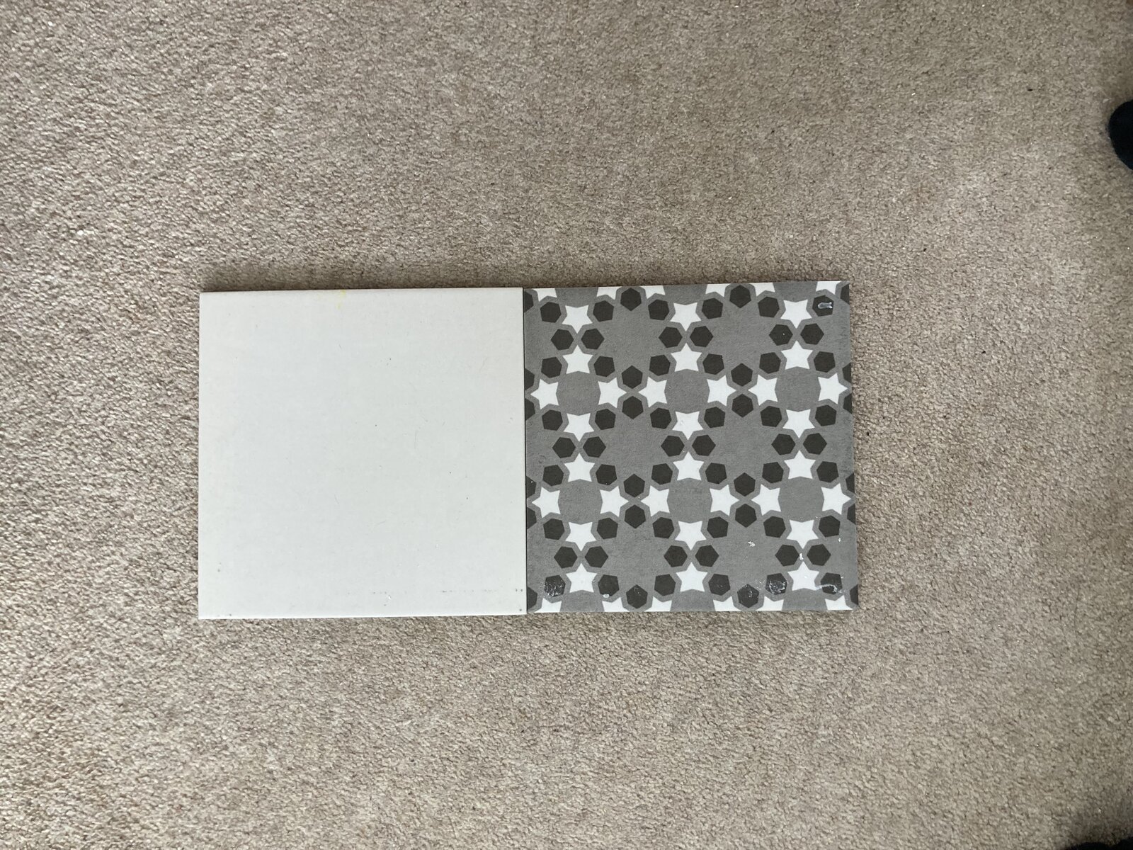

Bathroom fitting…when to comment?!

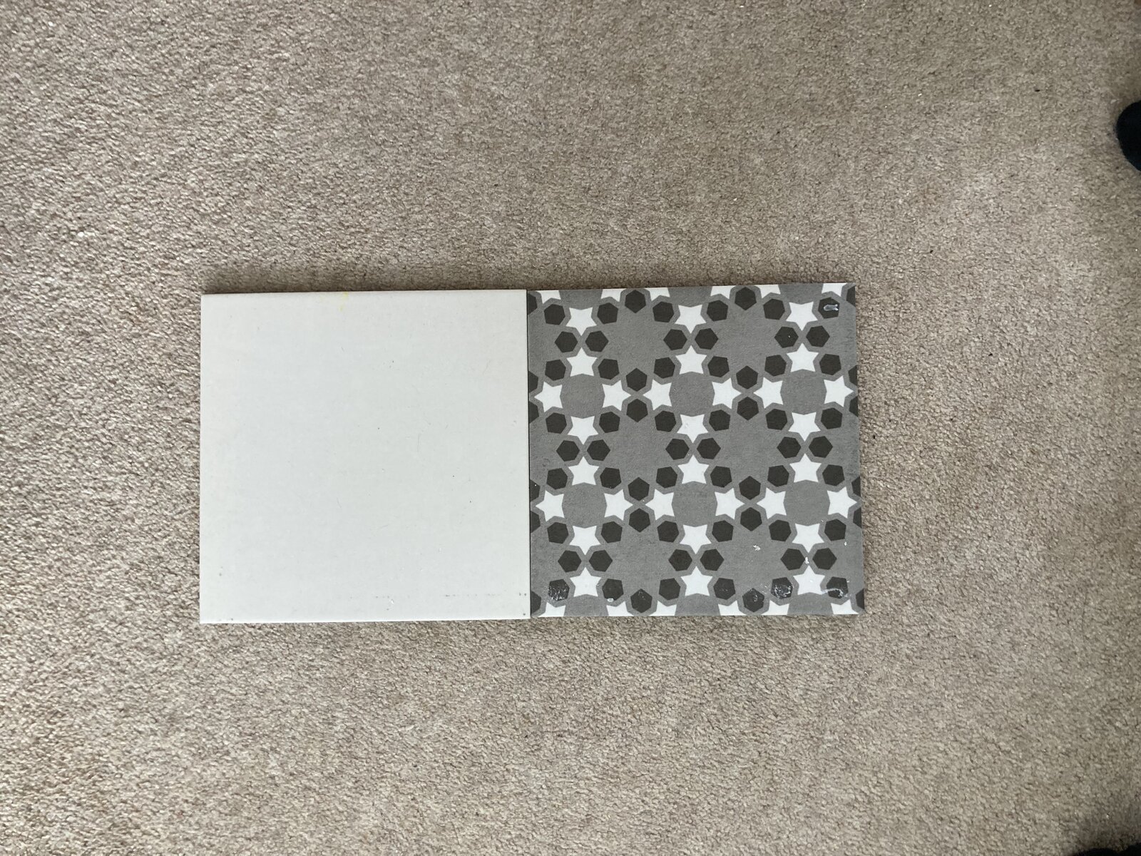

Assuming that he used the same tile spacers, surely the tiles are not all the same size? that said, yeah he could have used wider spacers.
Tiles are the same size (image below)
The overhang at the edge of the basin- is it supported?
Not supported!

The tile on the right looks to be about 2mm smaller. Did he tile the patterned wall first. If yes, I have sympathy for him, if not, then he should have used bigger spacers.
The shelf may well fall of the first time that someone applies pressure to it. Is he ultimately responsible for planning the layout?
I don't mean this with any disrespect, it looks to me to be the quality of job a semi-competent diy'er might be content with, not a professional bathroom fitter.
I don't expect you to share financial specifics on here, however did you get a very good deal on the price overall (i.e. a bargain) or do you feel you paid an amount that should have resulted in a quality finish throughout?
And were things not fully discussed beforehand? e.g. it seems as though the shelf at the side of the sink was a surprise to you?
You would need to butt together say three or four of the same tile to get a comparison, not just compare one of each tile. It's how we check bricks for size.
There may be a small difference, but tiles are from the same manufacturer (same range) with the same dimensions on the box (so there may be some tolerance difference)
I ordered the items (which having seen the room and the room plan, I shared the order with him) , and explained the layout, but he ultimately decided things like the overhang and the gap between units. I was at work, but my partner was at home and he didn’t discuss with her.
The impression, is the finish is a semi competent DIY’er (having tiled some kitchen spaces even I Managed to keep tiles aligned).
Other stuff I’m just confused at, the sink as an example… the pipes come from the floor and are actually to the left of centre of the window… but the sink is offset to the right of centre of the window. He’s put in the (damaged) panel to shift the sink to the right. So he chose the position of the sink.
The reason for the overhang/ shelf of the worktop?! Well that’s the standard length that it came out of the box (he could have move the top and filled to left of the toilet if he didn’t want to cut it.

*top of tiling on wall above the bath. Big gap… left open… needs filling as a minimum, but surely he should have adjust the gaps between all tiles to ensure there was no gap at the top.
If he had the adjusted the gap, then the grout lines would have not matched the perpendicular wall (which they don't anyway).
*poor finish for grouting by the door.
Agreed, it would have taken him a couple of minutes to mix up some more.
(Also note tiles at the eaves, small gap).
That is subjective- I suspect that he has run the tiles level.
