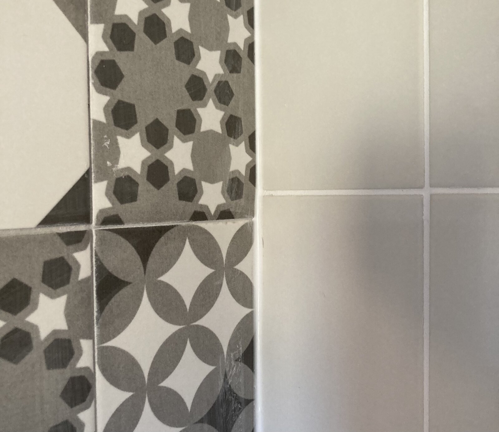

Bathroom fitting…when to comment?!
Those tiles don't look exactly the same size to me, but they look close enough to have made a better job than this bloke. On the other hand, if you chose the tiles and he was having difficulty co-ordinating the joints, he should have said so before fitting them to the wall.

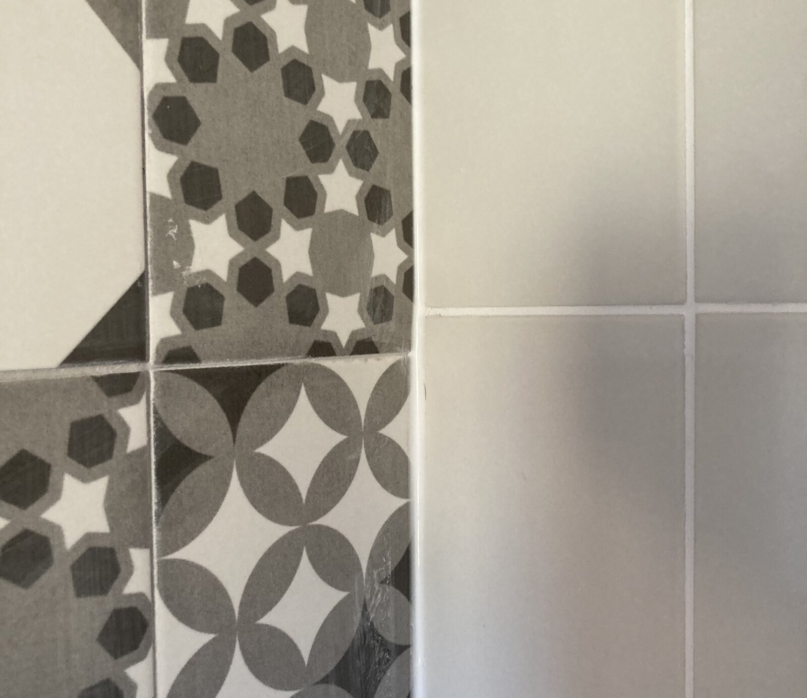

If he had the adjusted the gap, then the grout lines would have not matched the perpendicular wall (which they don't anyway).
Agreed, it would have taken him a couple of minutes to mix up some more.
That is subjective- I suspect that he has run the tiles level.
Thanks yeh, the grout lines don’t match already, any wonder one side gets gradually higher than the other?!

So bit of an update, called him round the other day to discuss, says the tiles were far too different to match up, and he used spacers, having popped him after he had gone one of the nights he was doing it, he seemed to have some of the small white crossed, and others that looked more like bits of card, he admitted he hadn't spotted the massive gap between the ceiling and tiles.
For the cabinets (my personal opinion is he made a school boy error, he fixed the cabinets in place BEFORE the floor was put in, so he had no idea what height they would be at).
* The gap between floor and units is 195mm, the height of the plinth is only 180mm!
* First he claimed first that the floor was wonky, he got a length and pushed one end down to show the other end going up about 1cm (clearly if there is a small bump one end and you follow the line it will exaggerate it) I got the tape measure out and showed that the gap was +/-2mm along its length.
* He then claimed plinth could not go any higher and was designed to have the gap at the top! So I then had to point out his shoddy workmanship, as the unit carcasses are 640mm high, the panel he inserted between the cupboards (which was damaged) he had cut to 647, and the end panel he cut was 655!!
* He then took the panels off to show they didn't make a difference, it clearly did (it also showed the gap was the same along the entire length!), at which point he then told me they were designed to have a gap under to stop water soaking the panels, at which point I literally put my fingers into the gap and asked him if it was really right, so he then claimed they would have a large rubber thing underneath to stop the water.
* He blamed the floor fitter for the damaged door, and charged for radiator valves (he told me he would be fitting TRV, but they are normal straight valves (£25)), I read the delivery invoice and they should have been included with the delivery though.
* He did accept the damaged panel (and suggested he would pay for that), but didn't know how that had happened, when he took the panel off (after the discussion over the plinth gap), it was clear he had just put a screw in too close to the edge, all the others were central. And he had missed the grouting/ caulking round the toilet, on top of part of the skirting board etc.
I was a bit exhausted at discuss the worktop overhang, or the excessive gap on the toilet panel (as he had moved the panel over to cover his atrocious sharks tooth cut on the plinth).
Partner is still not happy (though she conveniently disappeared when he was here!), wants the whole cabinet redone and tiles redone
If the floor was unlevel, why didn't he charge you to level it. Regardless he should be able to scribe the end panels and plinths to compensate for such eventualities.
He sounds like a BS merchant.
Assuming that he used a cement based tile adhesive, after this long, I don't think you will get those tiles off without breaking the tiles and damaging the plaster/substrate.
Even as a diy'er, this alone confirms he's a muppet. Personally, I'd cut your losses and wouldn't get him to do anything remedially. Do it yourself or if not your skillset, seek someone else. Keep this 'bathroom installer' well away.
