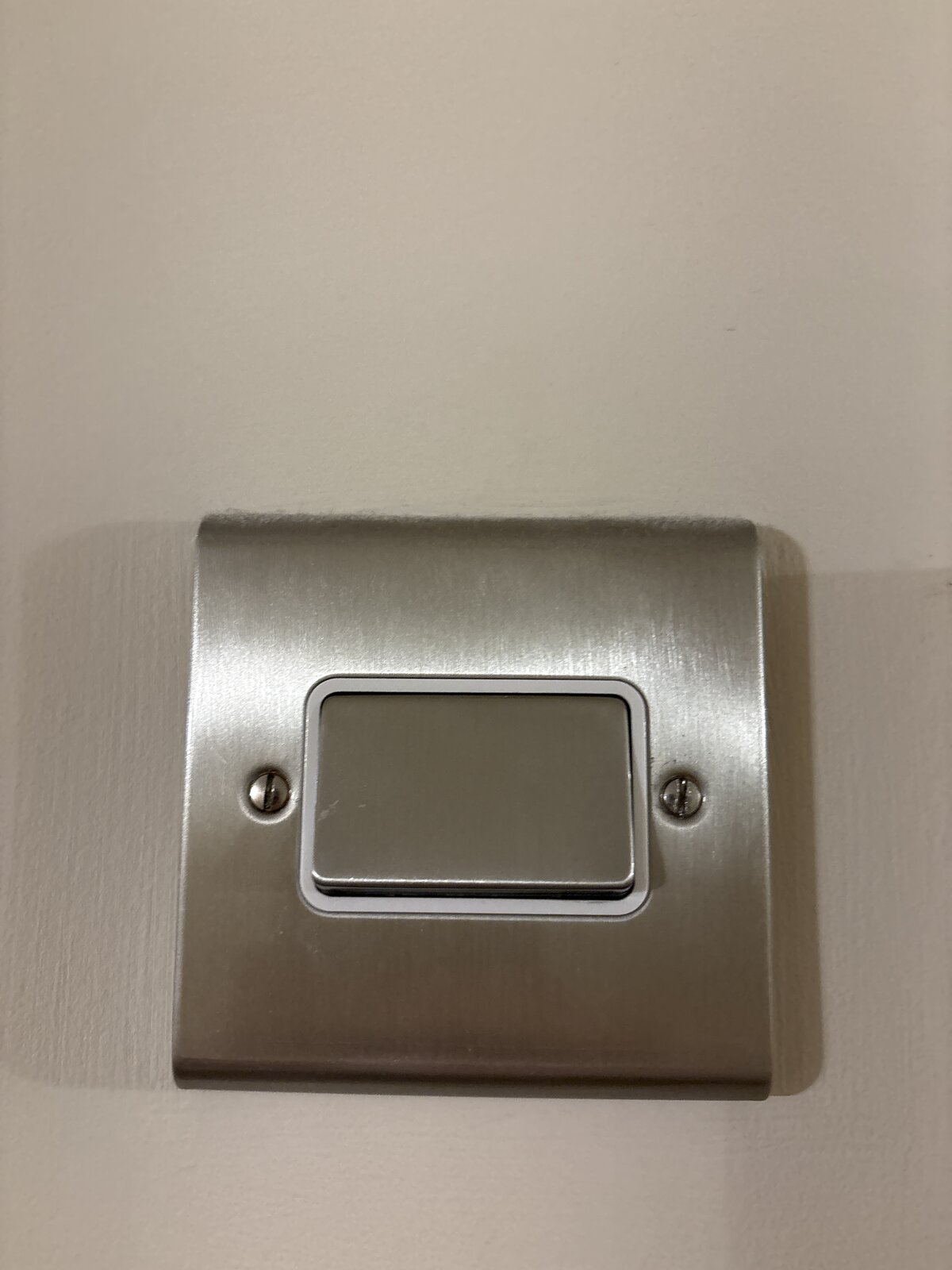

Thanks for the quick replies. So there’s an extractor fan switch above the light switch, what’s supposed to happen (and has for 9 years) is that if the extractor fan switch is on the the fan will run immediately when the light is switched on and will then continue to run for a short period after the light is switched off.

Is the fan switch a “fan isolator”, i.e. a very wide switch?

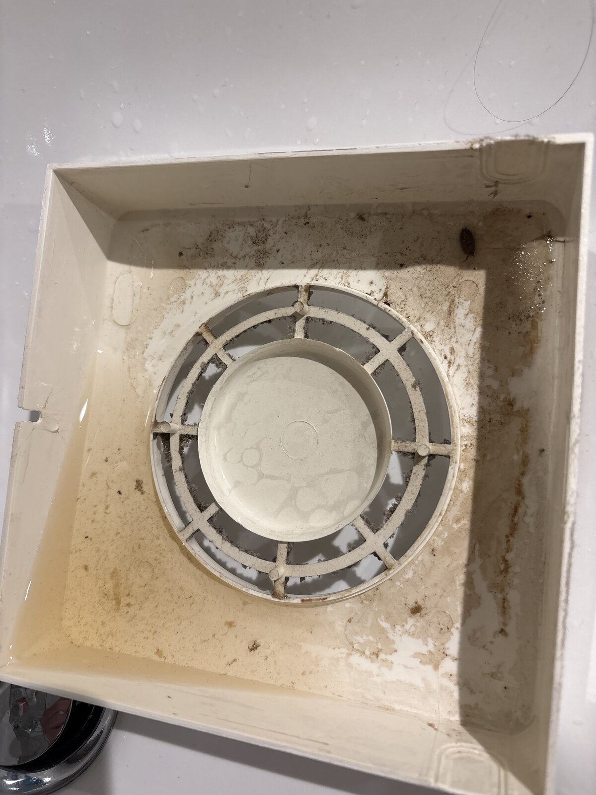

Yes that’s correct, and I just took off the fan cover and it’s full of water!!
Ceiling mounted, the water seems to just collect in the pipe above the ceiling which eventually floods the fan unit. Exact same thing happened a few years ago in other bathroom. Just a long period of condensation ending up in the pipe I guess.
I read somewhere, that you can buy, and fit condensate traps for these ceiling mounted ducted fans. Maybe worth investigating?
