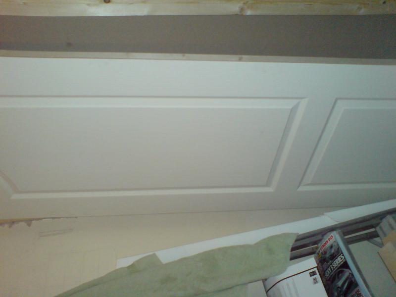

The cutout is actually a recess on the landing, housing a bookcase.
The airing cupboard is opposite this recess on the other side of the landing.
The recess intrudes on the corner of the bathroom, forming an alcove into which the bath fits neatly. On the other side of that naked plasterboard behind the pullcord is the bookcase.
That bare wood to the left is the door casing.
The door behind the cable reel is the airing cupboard.

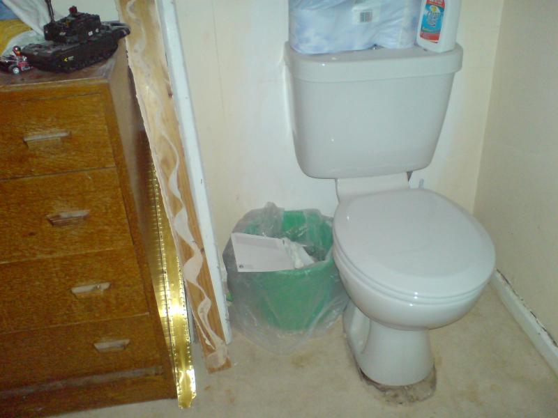

Two things:
1) Moving the soil stack might not be as simple as you think because, unless you want to start digging up your outside drains, you've still got to get it back to the same point outside. Then there's the holes in the wall to consider: a new one needed and an old one to block off. I would avoid moving the toilet if you can.
2) Running drains across joists is a pig.

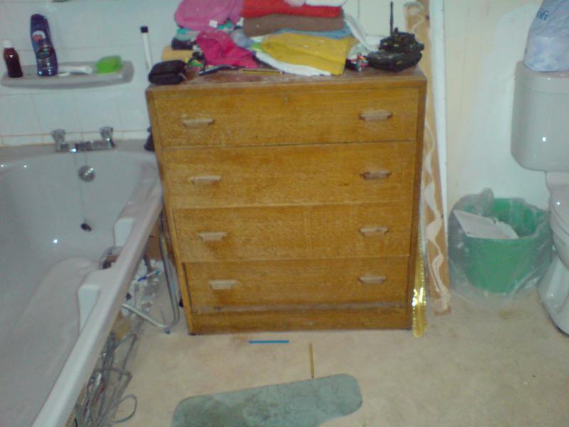

More bathroom photos:
The loo, fitted a while back.
The area where the shower is going, which is in front of you if you're sitting (yes, I did say sitting) on the loo. Edit: sorry, it's side-on. I did not edit it.
The basin unit is going here with a vanity unit so we can store towels etc...

Piccy:
:oops: Yes, I know it's somewhat of a pig's ear; I inherited it all from the previous owners.
EDIT: Looking at the photo now, can I raise the point at which the feeder pipe joins the soil pipe? Where it is at the moment looks distinctly dodgy...
