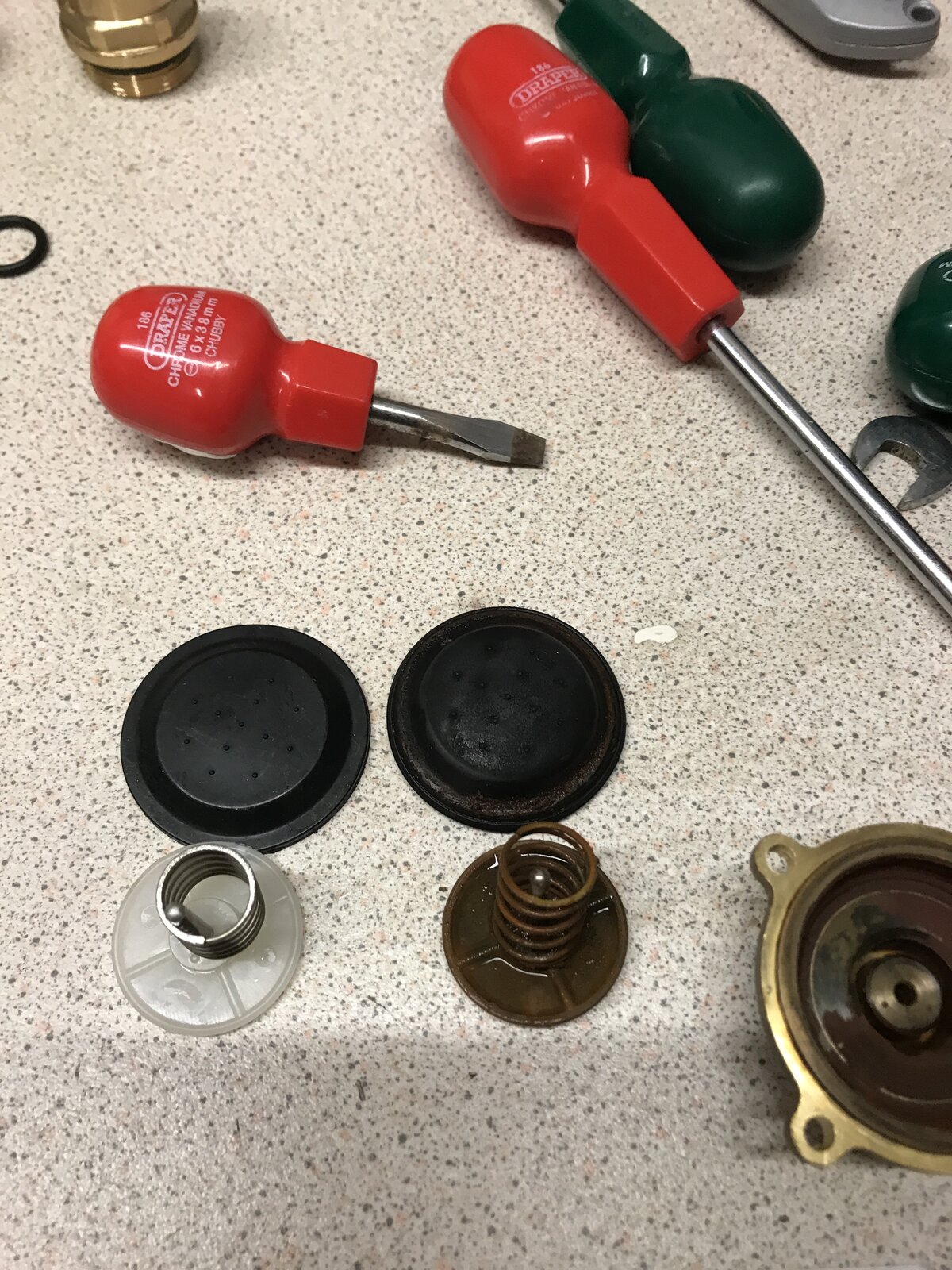

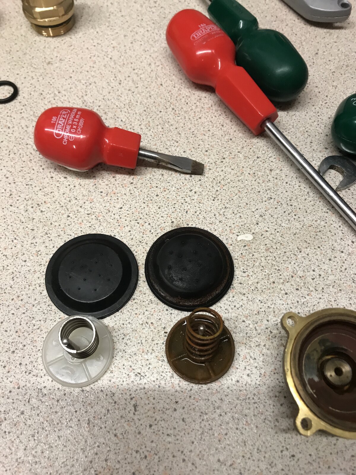

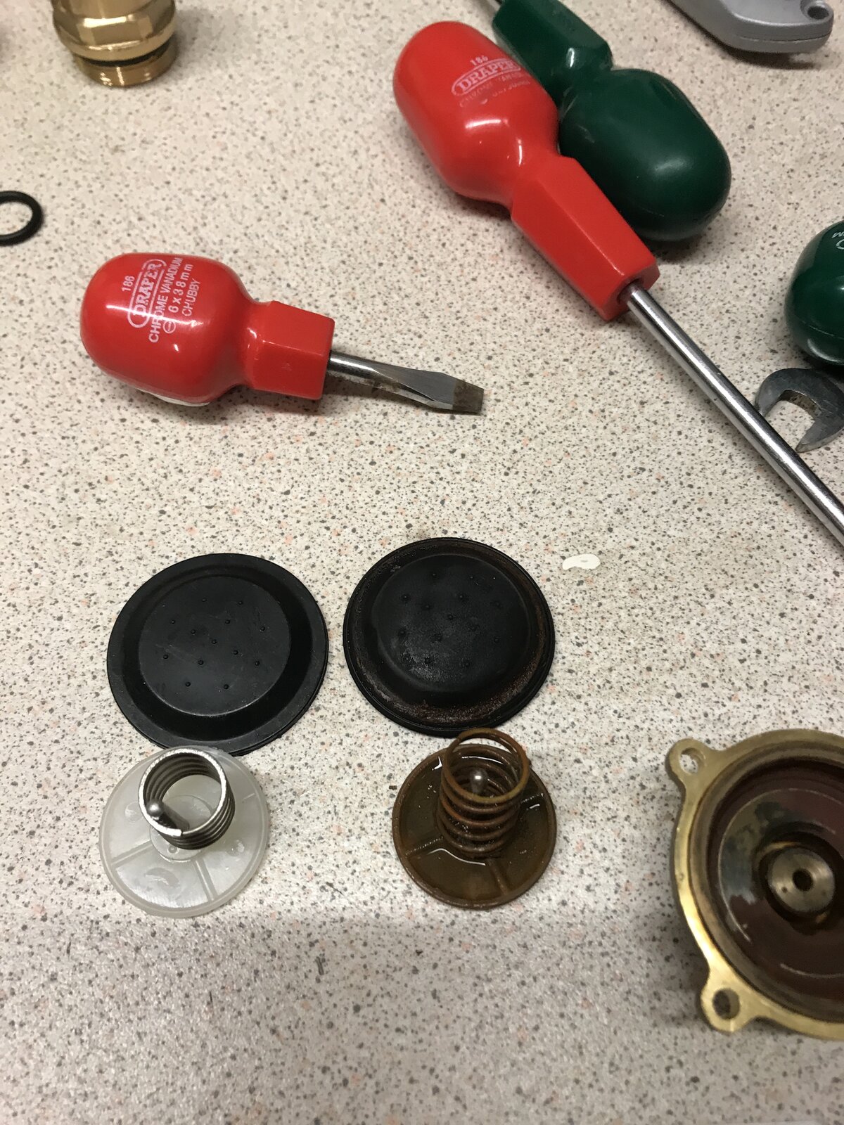

So I changed the diaphragms for the front and top bits, including the springs pin type things and the nuts.
The radiators are still getting warm when the hot water is running.

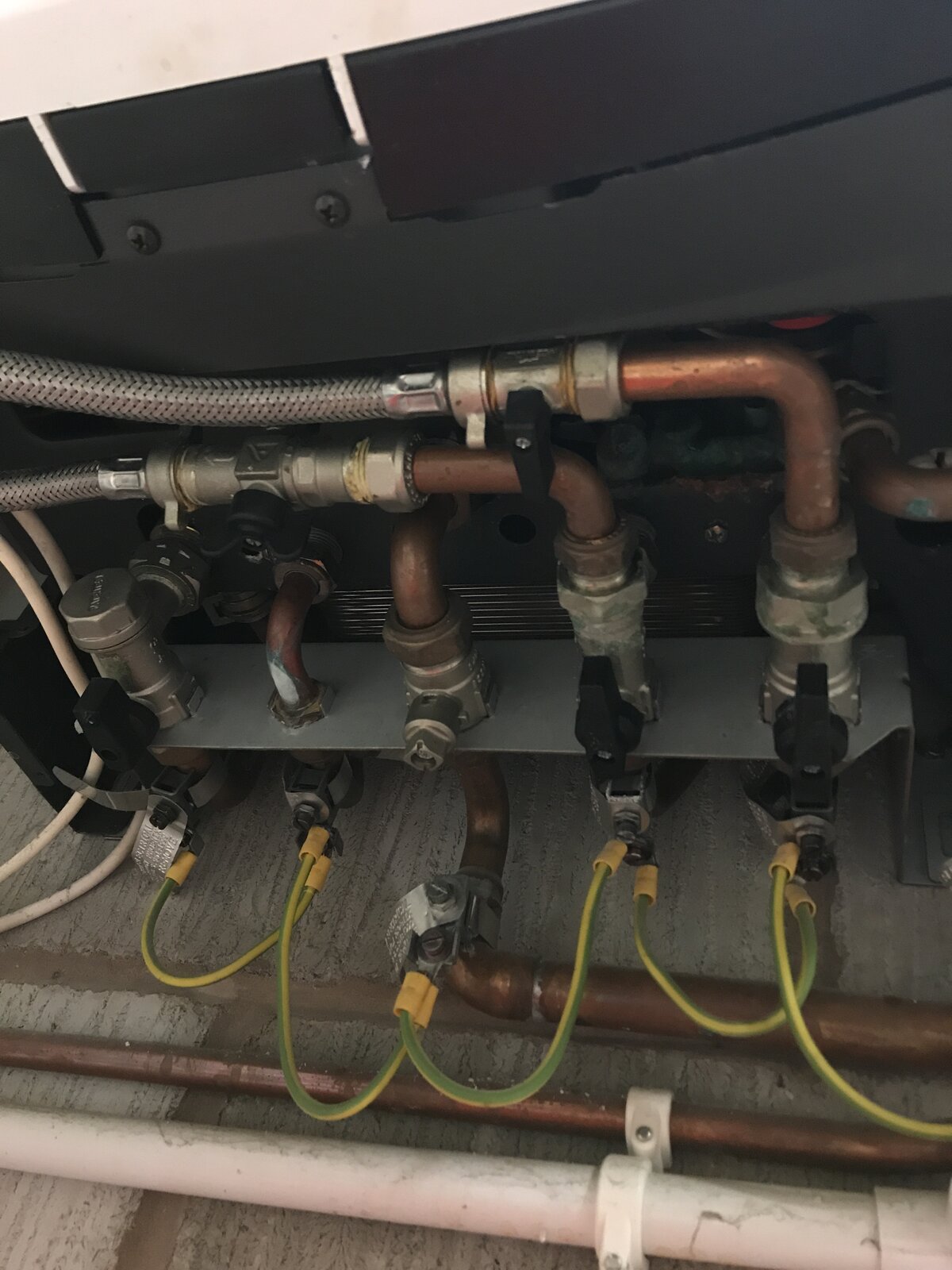

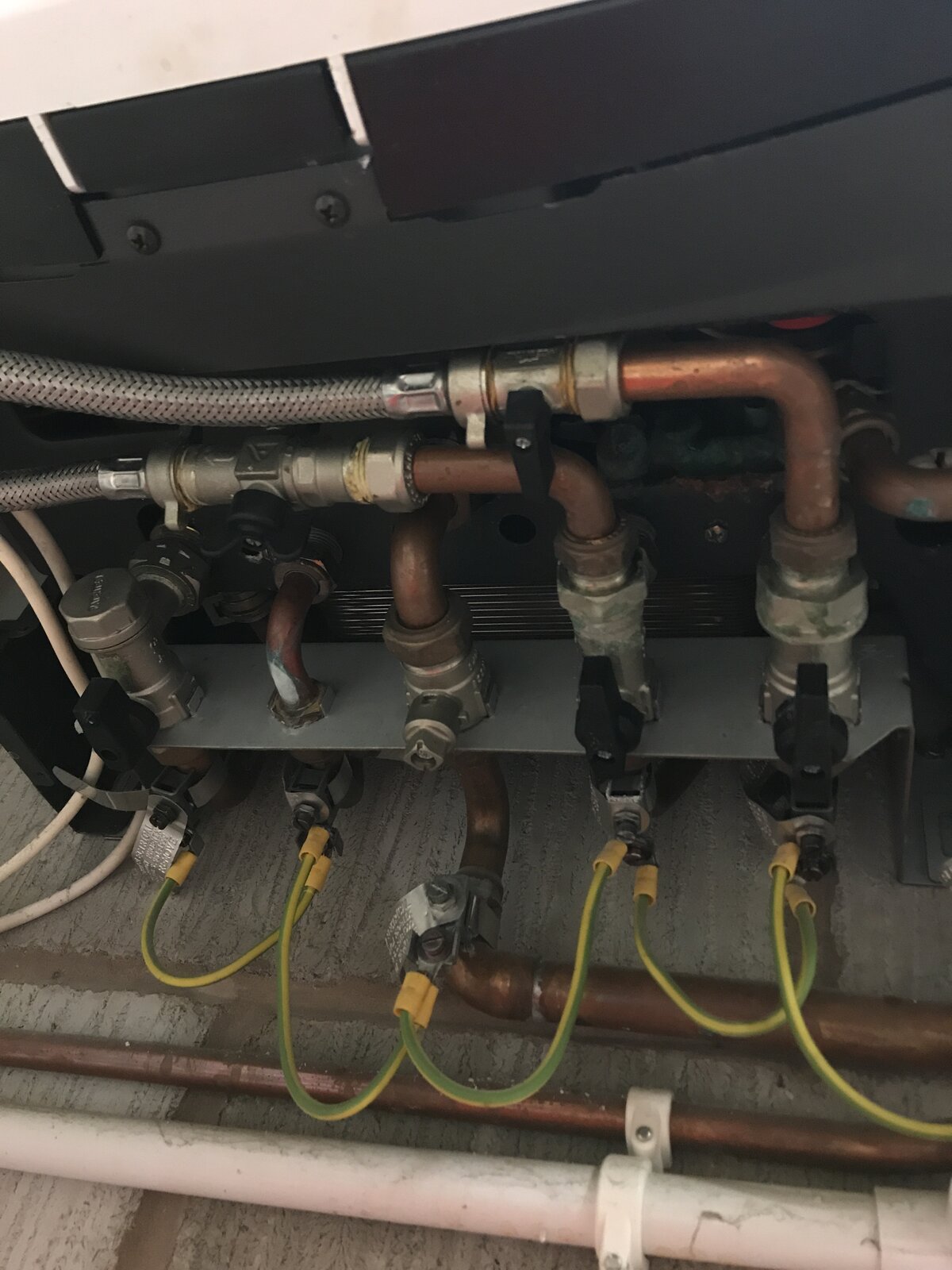

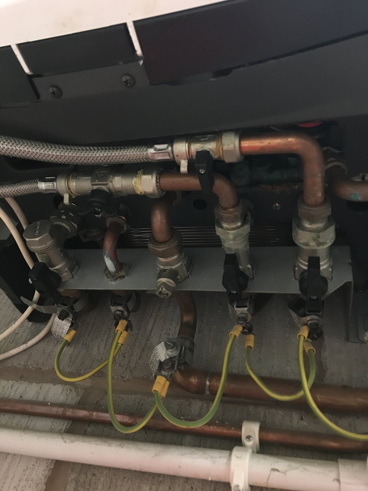

Also, could someone advise me what the positions the four valve taps should be in, in everyday use.
I should have taken a photo before beginning work on it.
Mine are set as in the photo attached.
Andy

The problem isn't the diaphragms.
Remove the front DHW brass section, unscrew the large "hex" gland screwed into the front of the rear diverter section.
Replace that bit (check the Teflon gland matches exactly with the replacement...they are sometimes wrongly supplied from the cheap ebay suppliers etc) and replace the spindles/discs etc that you can get too.
No need to remove the entire diverter.
