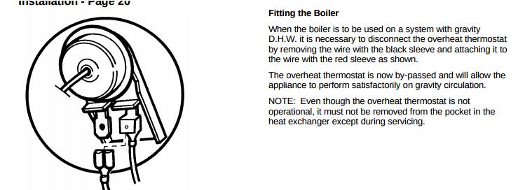

I have a problem with the above boiler used for water and heating, the water temp cannot be regulated it is always very hot even when set on lowest setting - my Gasafe installer/servicer has had too much on his plate with family issues and i need this sorting pronto.
So far i have replaced PCB board and main stat but no joy, when installed it is on Gravity fed so Overheat Stat has to be disconnected for it to run on Gravity. This confuses me as to how it should cut out in case of overtemp situation but wont solve the issue of very hot water, any help much appreciated

... it is on Gravity fed so Overheat Stat has to be disconnected for it to run on Gravity. This confuses me as to how it should cut out in case of overtemp situation ...
Not sure that disconnecting the boiler overheat 'stat is in any part of the manual, and would contravene the Gas Safety (Installation & Use) Regulations.
In general a boiler temperature 'stat (the control knob) will switch between 40C and 80C, so if working and set at minimum the domestic hot water should not be felt to be 'too hot', even on a gravity system.
Do you have an immersion heater?
Has it been left on?
If not then it's time to call in a pro. From what you've written I would be reluctant to advise further.
