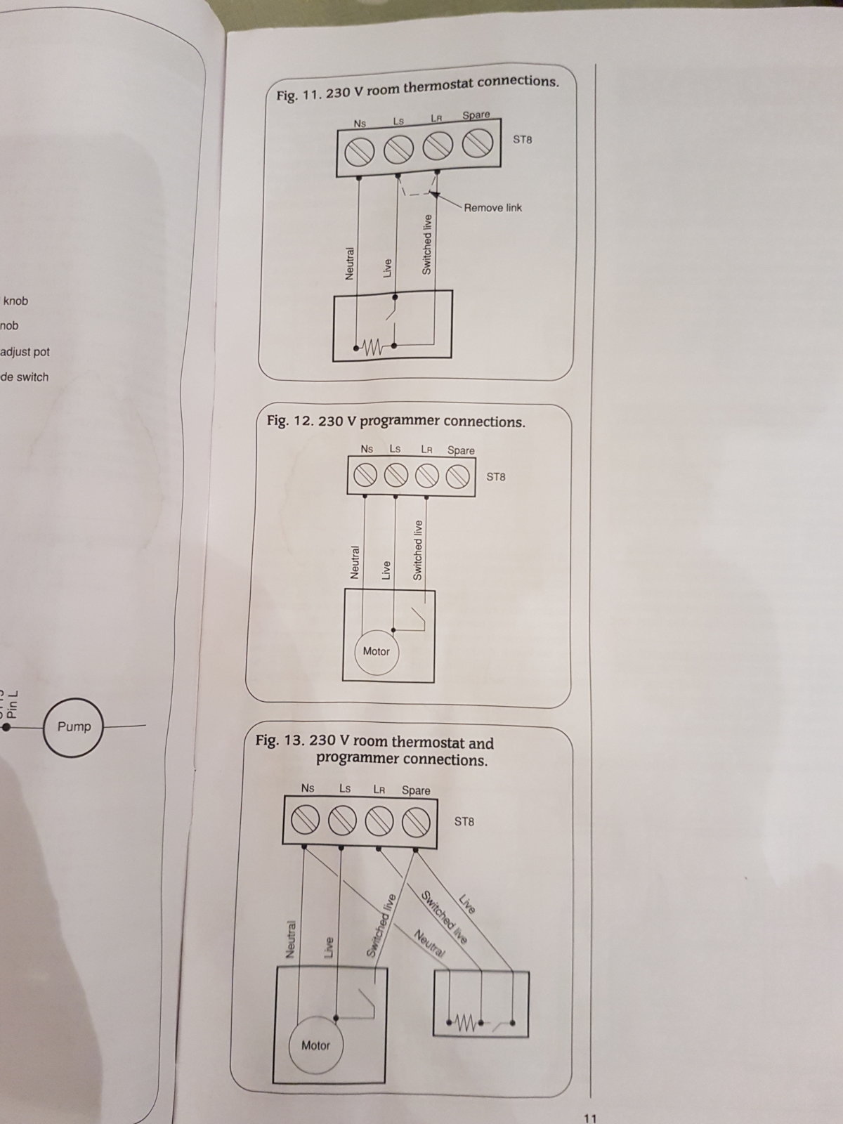

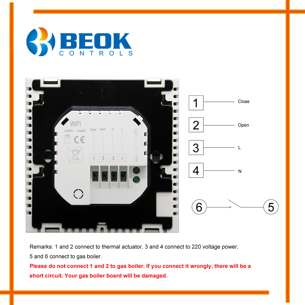

Installed a Beok WiFi product to the undefloor heating and thought I should get another WiFi-enabled controller for the combi boiler! :mrgreen:
Having both units on one 'app' would make it easy for the OH. ;)
Looking at the details the Beok has the following:
And my combi has:
What connects to what?
There's an instruction manual for the Beok here.
If the object is to switch the boiler on and off, then 5&6 in the Beok connect to Ls & Lr in the boiler.
It also needs power on L&N.

This is a totally separate unit and is electrically heated. I wanted to avoid the get this company's product suggestion as we don't want more apps to complicate things. :cautious:
The link is Dropbox. Apologies - didn't know it needed a login. :oops:
Yeah - even I knew the L and N....just wasn't sure on the rest. There are plenty of people's reviews to tell me it all works on the selling sites, but none of them seem to know how. o_O
Just wanted a thermostat - and an app driven one seemed easier?
