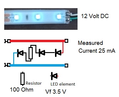

A driver designed to drive LED elements will have a current rated output that matches the current rating of the LED element(s).
What you have is a 12 volt DC power supply and lamps that each have an integral driver that controls the current through the LED element(s) in the lamp.
If a "driver" with a 12 volt DC output was connected to an LED element then the element would be destroyed by the unregulated current passing through it. If the power supply is regulated at 12 volts DC then a simple resistor can be used to control the current through the LED element(s),

You end up with the designed-for conditions, either way. Giving the same result. So where does extra life come from?
There's nothing I know of in the physics of LEDs which makes precise current control better, as long as they're not overrated. It's easier to use to dim one, but there's no analog dimming done... . There's no inrush like a wire bulb, no thermal runaway...
The current through the led is set by the incorporated resistor.
In a "bulb" There would be a full wave rec with a Vf of traditionally about 1.4V, the Vf of the LEDs - depending how many are in series, and a resistor and maybe nothing else. I'd like to know how dimmable bulbs are effectively different. I know they can flash etc, so there must be a difference. But what?
(The circuit above is incorrect somehow - no reverse polarity protection may be ok, but the current would be 15mA.)
I think you'll find that a lot depends upon what is coming out of your "DC" power supplies. It's generally far from true DC, which is why you will often see their output quotes as, say, "12 effective". That may sometimes mean that although the average of the output is 12V, it actually consists of pulses of appreciably more than 12V, so that the instantaneous current (during the pulses) may (if current is controlled just by a resistor) exceed the 'rating' of the LED element.
I agree. Mind you, since bernard wrote that the 25 mA was "measured", I wonder whether the Vf of his LED elements was perhaps not (as he has indicated) 3.5V but, rather something just under 3.2V ?
The Vf was taken from the data for the devices. I still have that strip. will check the current later.
