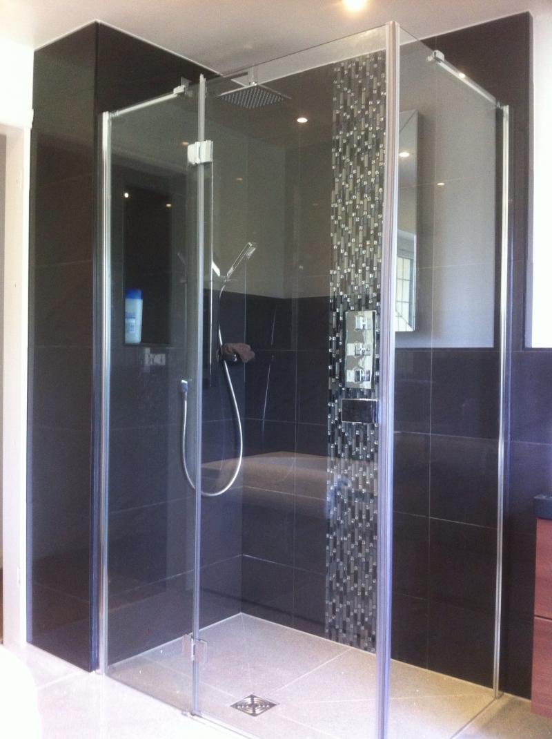

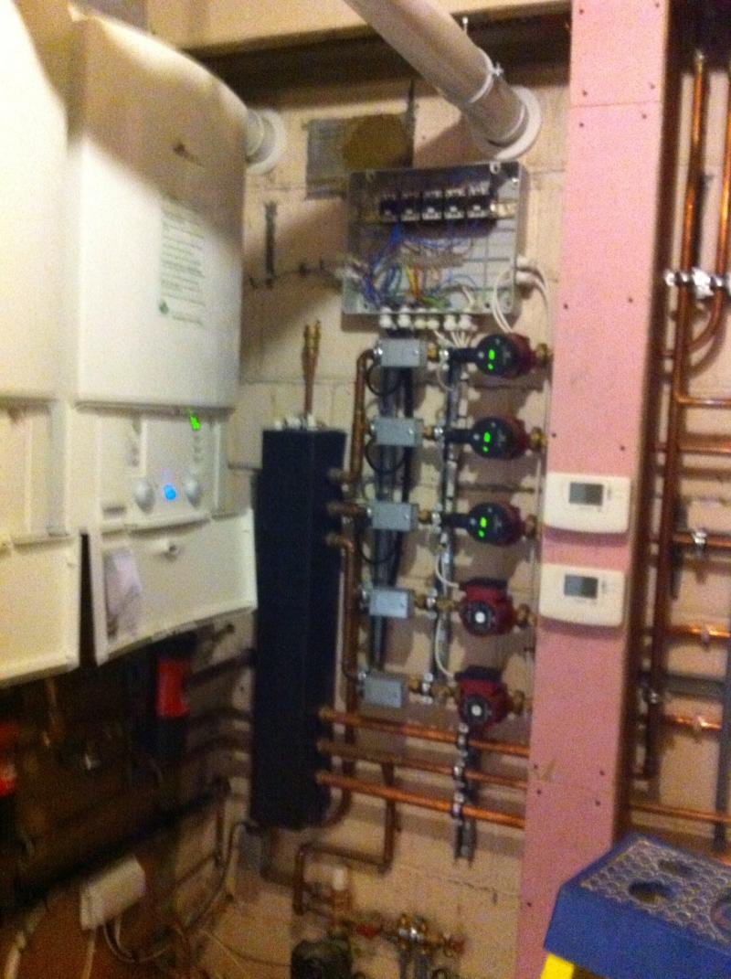

Does this look like the work of someone that doesn't care?
Come on nobend I have shown you my experience where is yours and what exactly do you do for a living?
