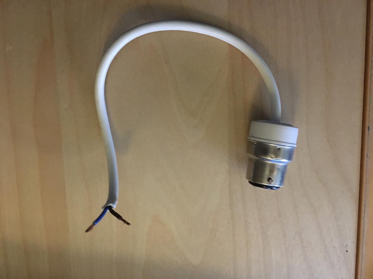

I wanted to know the best way to use my ceiling light fitting (which is a bayonet cap)
to connect an LED light strip that has a USB connector and typically plugs into a USB to mains plug adaptor (like the iPhone charger ones).
If I plug in a cable with a bayonet fitting ( as per image)
I want to hang about 3m of LED around a acoustic panel on the ceiling of my home studio and use the light fitting to power it, as its right next to it and I don't use the ceiling light.
What's the best way to connect to the USB light strip?
Is there a fitting that can safely run from the light to a USB socket that I can then plug the LED strip into?
Just trying to figure out how I can do this safely!
Many thanks
The best way is to forget this idea entirely!
It will go BANG! if you try connecting the bayonet lead to your USB lead.
USB is 5v DC, your lighting is 230v AC so the two need a power supply between them (that's the bit in the plug socket you push the USB lead into).
What does the instruction say it needs for a power supply? (whats in the small print on the one you use?).
5v at how many amps? (or is it 12v?)
You will also need to ensure that you have a fuse there somewhere.

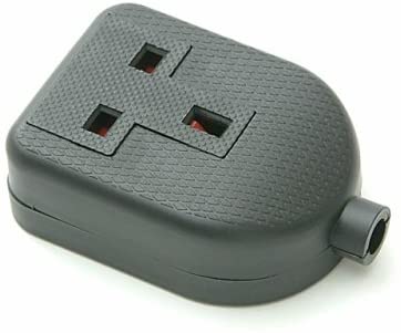

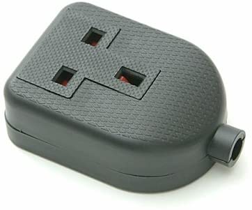

If I took the light pendant off and wired the cables to a plug socket like this >>

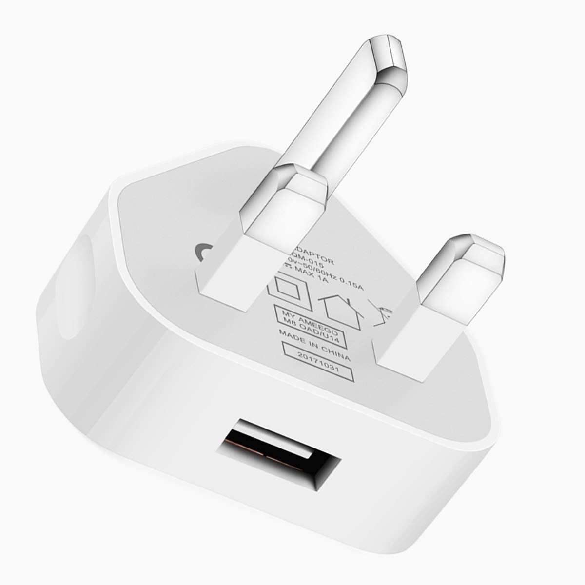

Then plugged the USB charger plug into it (as I would into a wall plug socket)
And the USB led into that, would this be a safe solution?
Thanks again!
The lights you show are for decoration, i.e. they look good, but light output is low.
1) You need alternative lighting to see with.
2) The socket would look ugly.
There has been many a debate as to having 13A sockets on the lighting circuit, seen it done many times in loft space to power an aerial amplifier, but the problem arises when some one plugs in some thing else. Be it a mobile phone dangling from ceiling or used as a table supply for the hot plate, sods law if you did that some one at some point would plug in some thing else and you would loose all the lights in the house.
At one point is was illegal, there were two meters one for lights and one for power and lights electric was cheaper, so up to the 50's there were adaptors to take the cheaper power from the lights, my granddads house only had two 15 amp sockets, when my dad in 1954 moved into a new house he was so proud of have 7 x 13A sockets in the house, there was one in every room plus landing, and a further dedicated 15 amp in airing cupboard for immersion heater.
The rules refer to dividing into circuits so failure of one does not effect another, so you don't loose lights, Jury-rigged. means something was assembled quickly with the materials on hand. Jerry-built. means it was cheaply or poorly built. Your idea falls into both, you should not need telling how daft it is, you just need to consider what it would look like.
Coincidentally I found a PSU for a similar set of LED lights that my daughter wanted to use last night, the adapter was 5v 1A and seemed to work OK.
However the little box that goes on the end with the IR sensor in was marked as 12V 6A so it needs to be a beefy power supply output.

i) The aesthetic.
  • I think there's a bit of a misunderstanding ericmark
  • The unit will be fixed to hang around a rectangular 4ft x 2ft acoustic treatment panel that is already suspended to the ceiling (its a recording studio space).
ii) Light Level
  • I already have other lights installed from mains plugs in the room, so light level not a problem.
  • I wanted to throw light onto the ceiling from the ceiling panel. The LEDs look good around other panels, and thought I could use the same remote control system as the other LED strips which are already set up via plugs around the room and work fine.
My logic was
  • Cable would be hidden
  • Lights would point to bounce off the ceiling
  • Would work with existing remote control unit
  • Current pendant/ light is not in use and is actually slightly in the way.
  • So I wondered if there was an option to use the light unit as a power source, rather than running about 10 ft of cable up the wall and across the ceiling from a light socket - which I think can look ugly.
Anyway hope that clears things up.
Guess the main thing is if it invalidates home insurance/ not legal to repurpose a light fitting as you say, then its an easy "No" / end of story.

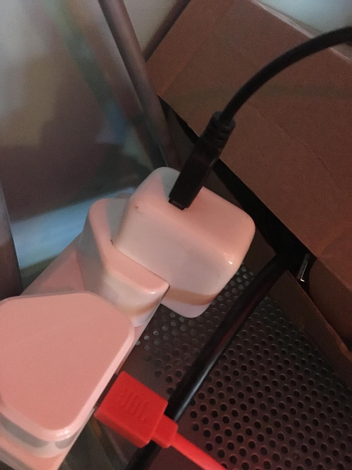

Thanks Plugwash. Was getting fed up with occupying up so many plug sockets for lights - the 4 port charges look like an option :)
