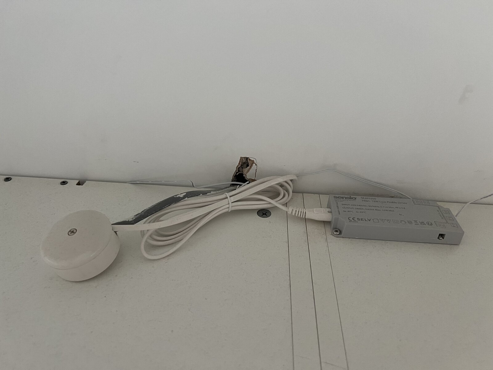

Hi, I would like to power a usb camera off this existing power source that drives my under unit kitchen lights. What is the best way to do this please?
Don't go anywhere near that PSU, it is 24v and probably not that stable (given it is designed for lighting).

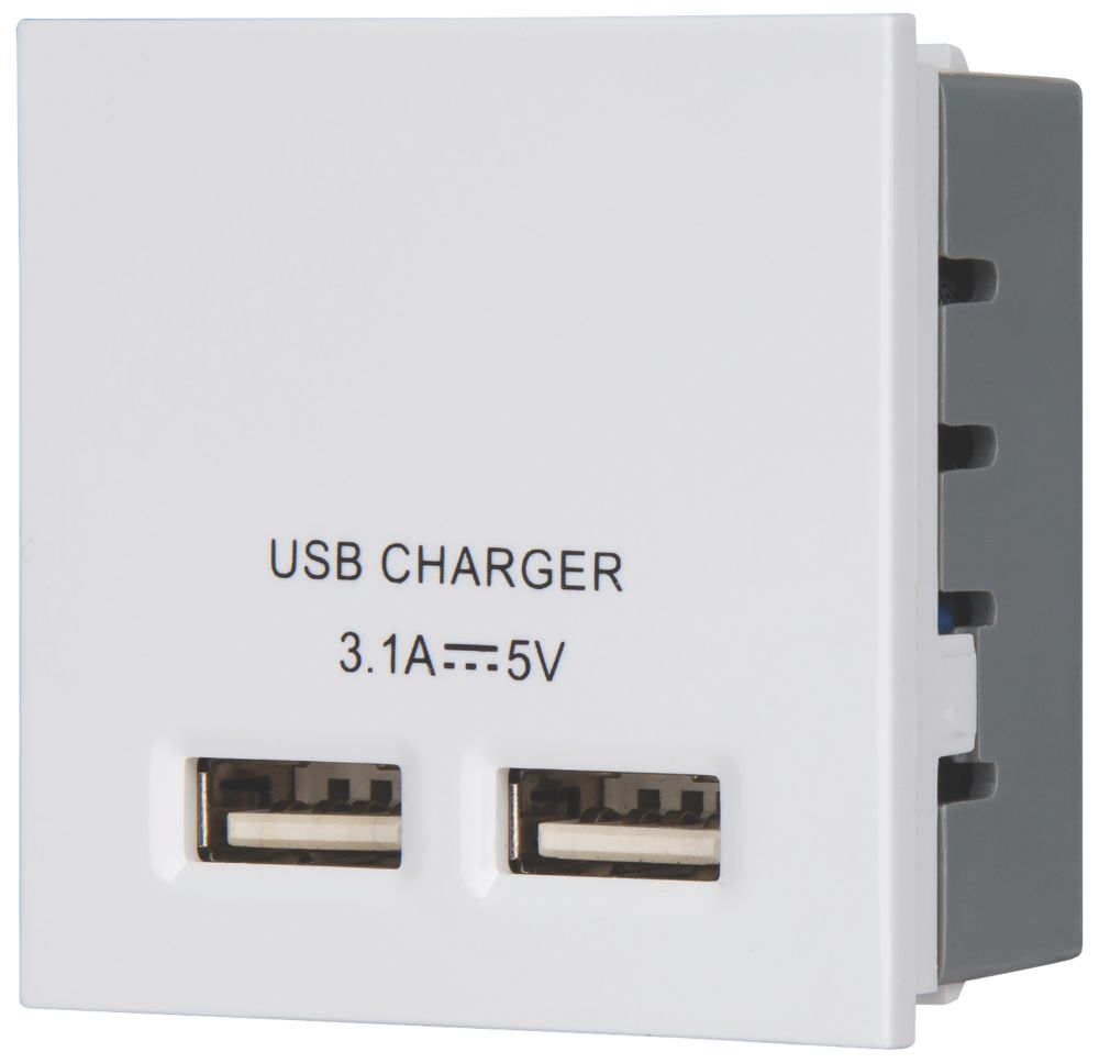

Easiest (assuming there's an earth in that JB) will be buy a 1 gang 13A USB socket and backbox, give it power from that JB and off you go.
Or a standard 1g socket with a USB adaptor plugged in
EDIT Make sure the circuit is appropriately fused and protected by an RCD. If there is no RCD then look for 240v USB power supply (the one I saw on Ebay RUWXNTU4 is American and will need enclosing cos no secondary insulation on the supply wires)

The cam would only then have power, when the light was turned on, but if that is acceptable....
Connect a 13amp socket, to the joint box, then plug a USB wallwart type PSU, into the socket.
