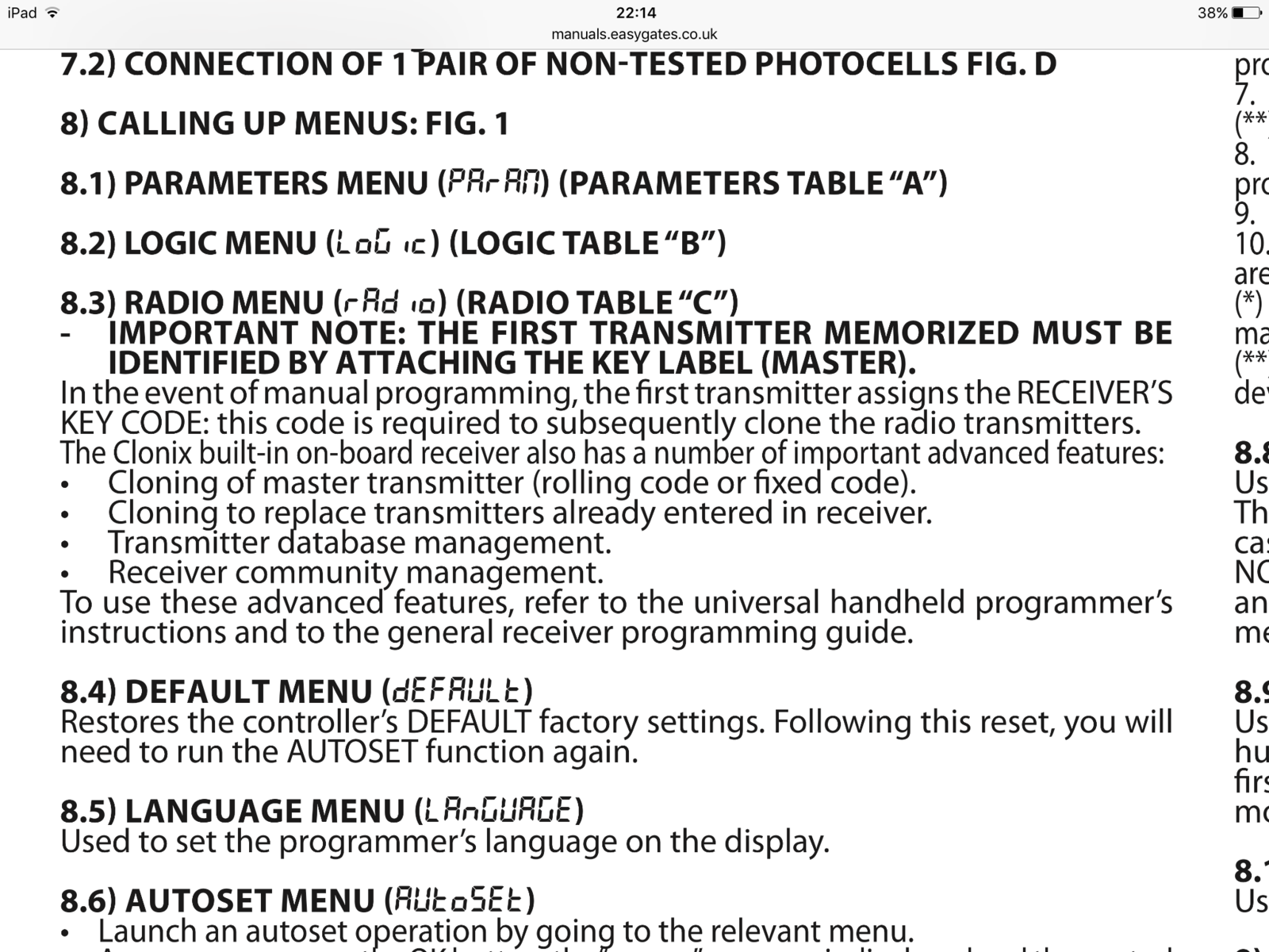

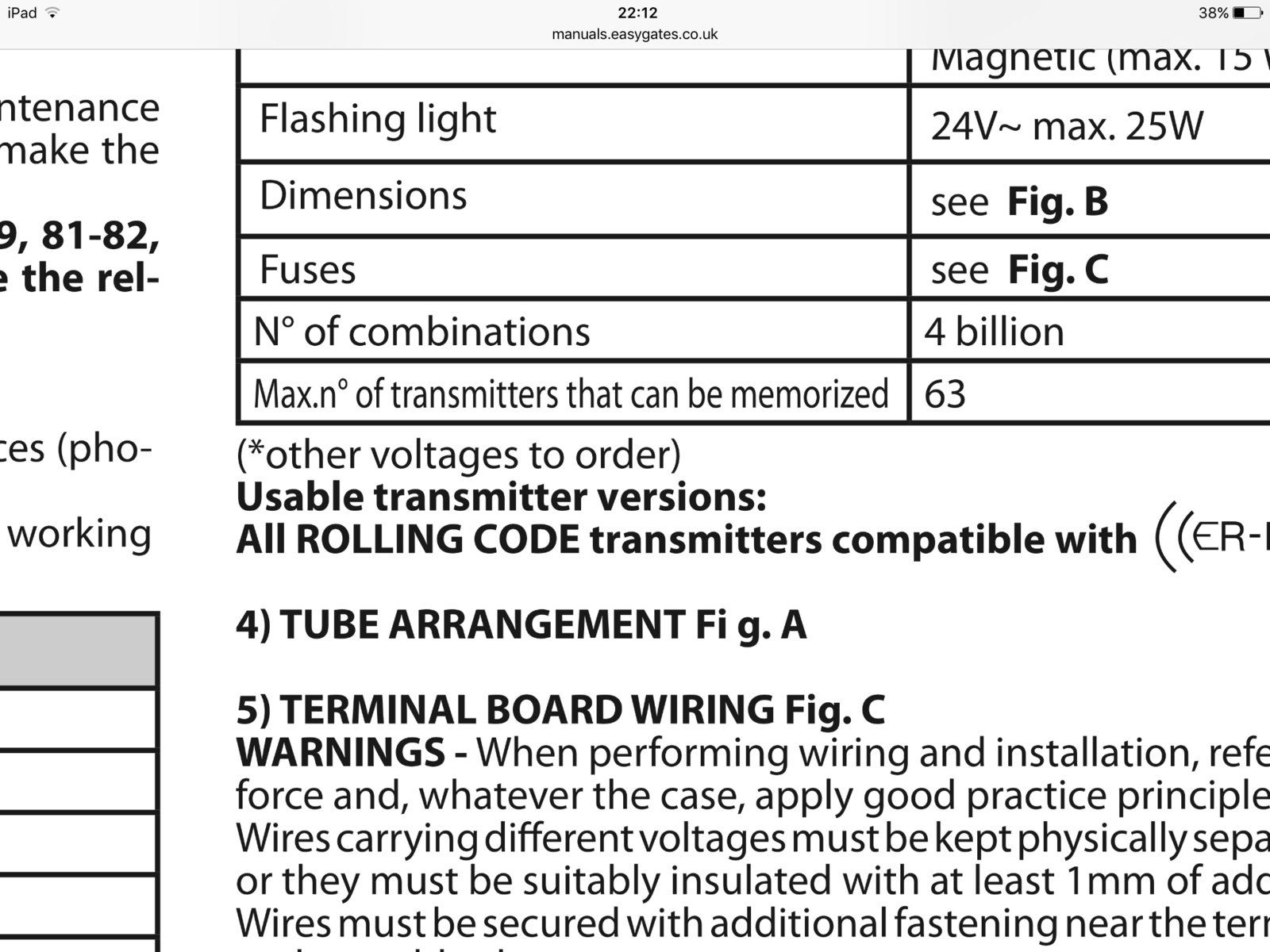

Hi,
We currently have a BFT control panel for the local residents that apparently is managing over 140 fobs.
We want to delete all fobs and reassign them as part of an audit process.
From reading the manual, it appears the function used on the control panel is erase64.
What does the 64 refer to? Does it mean the maximum number of fobs that can be programmed?
I don't want to delete all the fobs to find out only a max of 64 can be added, and to add more there's a hack or something.
Thanks in advance
IMG_1622.PNG IMG_1623.PNG Unless you have access to a programmer you should leave it !
Right, I've got it figured out. There's actually two controllers. One is the Thalia P model and acts as the master, the other is RTD 2048 which acts as the slave.
I need to programme against the slave which allows 2048 transmitters to be programmed.
Well, I know how to add remotes to the Thalia P, and from the manual for the RTD it doesn't look like rocket science.
I'm only deleting and adding transmitters. Nothing else
