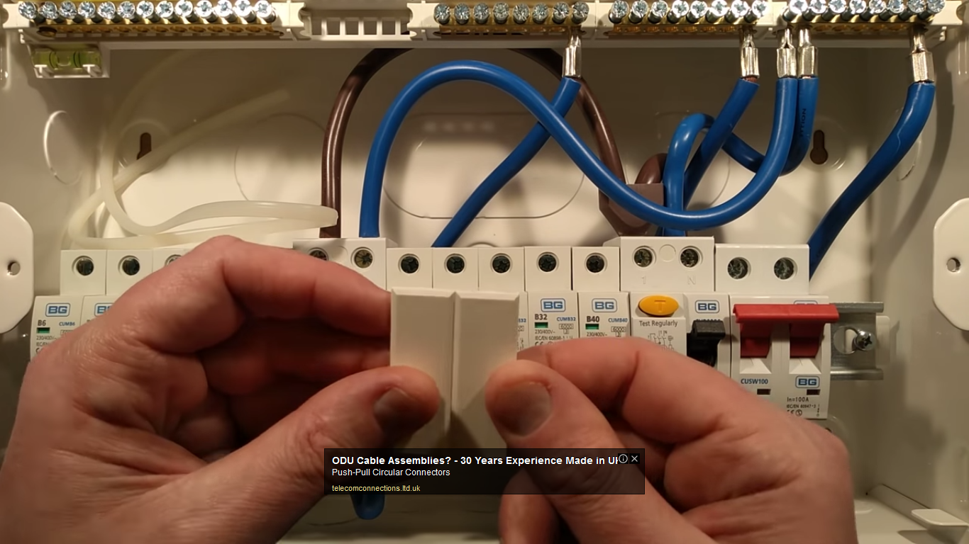

Sorry I am dyslexic and it seems I have not explained my thinking, what I was thinking about is if a manufacturer supplies a push in plastic blank, how can any inspector say this is wrong? The John Ward video showed what came with the BG consumer unit upload_2021-5-3_21-19-41.png and he shows the push in blanks, I can't see how any inspector can even issue a code C3 when clearly supplied by the manufacturer for that consumer unit.
On the other hand if the manufacturer recommends a more rigid type, using the cheap one may have issues.
Sorry I am dyslexic and it seems I have not explained my thinking, what I was thinking about is if a manufacturer supplies a push in plastic blank, how can any inspector say this is wrong? .... I can't see how any inspector can even issue a code C3 when clearly supplied by the manufacturer for that consumer unit.
Ah, I see. Thanks for clarifying, and my apologies for misunderstanding.
If that's the case then I don't necessarily agree with you, at least as a generalisation. ....
A non-compliance (or non-conformity) with BS7671 is a non-compliance with BS7671 and I don't think that, in general, a 'EICR inspector' can (or should) use "what the manufacturer supplied" as an excuse for 'overlooking' a non-compliance, and not coding it for that reason.
If a manufacturer supplies, say, a CU (or parts thereof) which does not satisfy BS7671's IP requirements, that is surely as much of a non-compliance if it relates to parts achieving the IP rating that can be removed without use of a tool as it would be if there were excessively large holes in it, isn't it? If so, an EICR inspector surely should code it (however he/she sees fit) as a non-compliance, shouldn't they?
