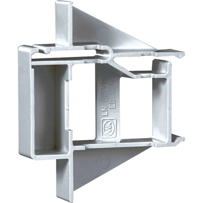

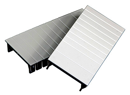

Also is it permitted to use random blanks found in ones tool box? Lets face it fitting these
is easy, but these
not so easy, so very temping to fit push in blanks, even if it is an MK CU.

Some of them don't actually just "push in".
They have to be rotated slightly and fitted to the cover before it is replaced so that when in place they cannot simply be pulled out.
That is the case for the metal blanks
But I have yet to find any of these in hard plastic, which would be useful for plastic CUs
