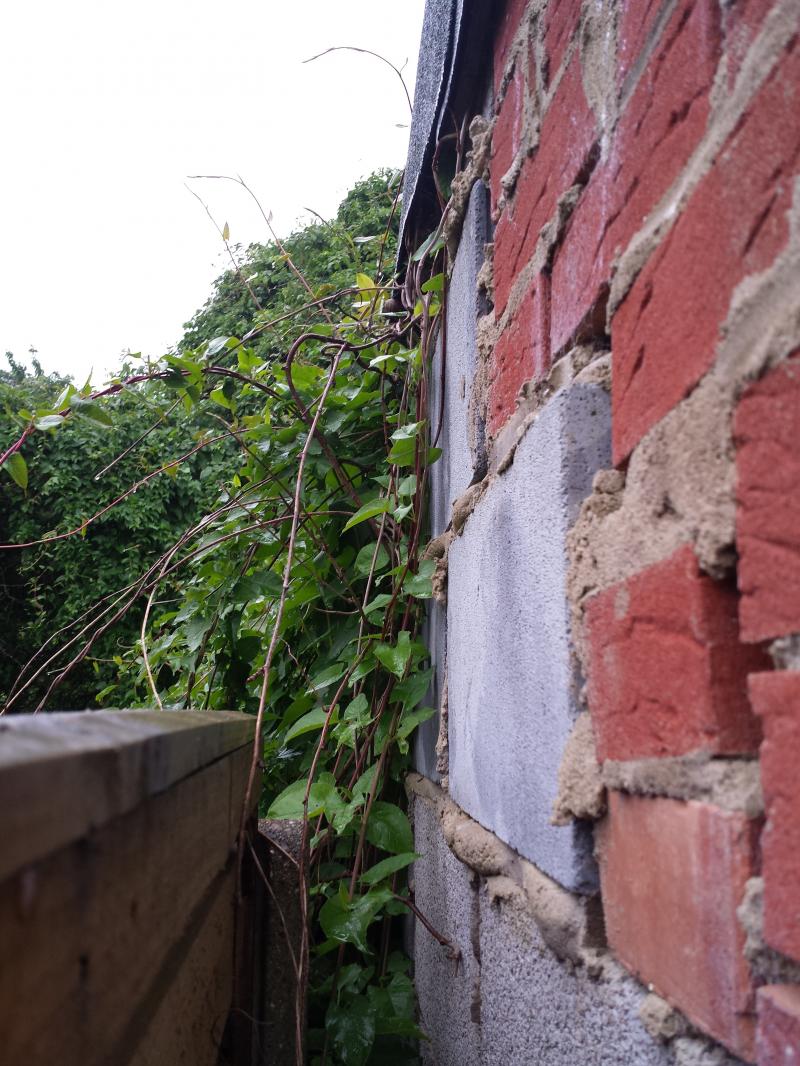

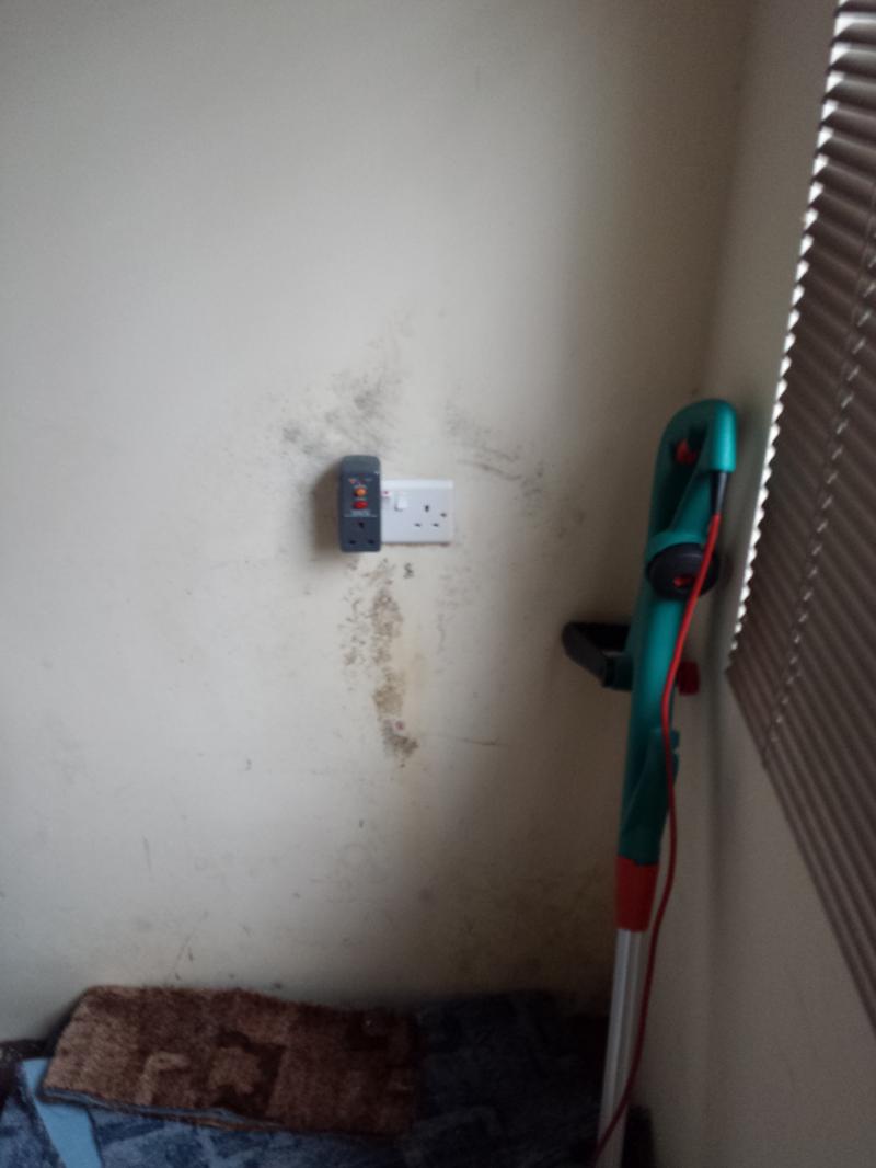

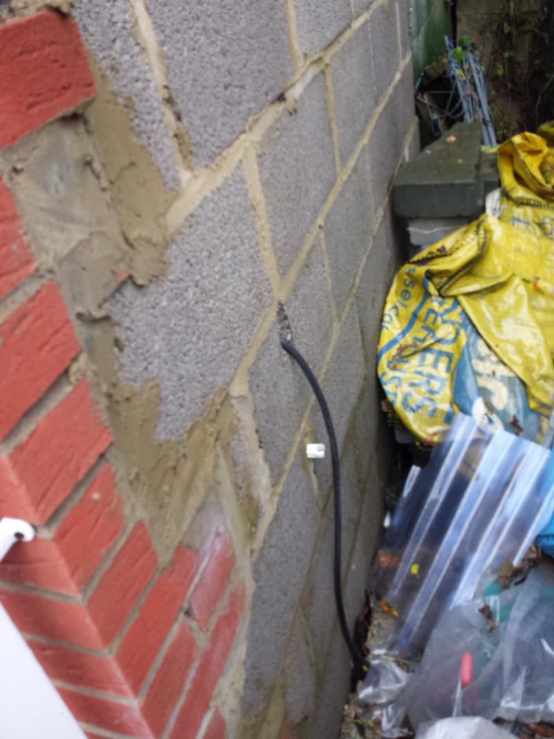

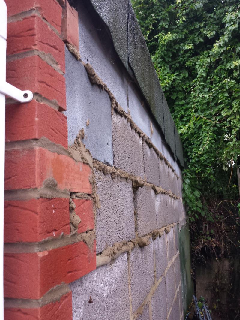

Hi,
We've recently moved into a new house which has a block built outbuilding/shed at the bottom of the garden, about 4m x 4m big. Its got a PVC door and a single PVC double glazed window and a flat felt roof.
Its currently used for a bit of storage (ok, a lot of storage) and is fine for that but I'd really like to use it as a studio/music room and it really needs some finishing off to make it suitable. When we first viewed the house in January it was really quite cold in there, and it smells a bit damp with an area of damp on one of the walls. I'm pretty much a novice DIYer and was hoping I might be able to pick some peoples brains as to what to do...
The front wall is brick, but the other 3 are exposed breeze blocks. The pointing in places in definitely a bit shoddy.
The damp on the inside seems to correspond with a hole where the power cable enters...
The floor is solid concrete and the rest of the walls seem to be plasterboard attached to the walls with some kind of gap, although im yet to really pull anything off to have a proper look. I cant see any evidence of a DPC and theres no ventilation (air brick etc).
My thoughts are that Im going to need to do something with the external walls. I was initially thinking of cladding it somehow but this seems rather expensive, especially seeing as the three exposed block walls arent really seen. Would painting be enough? Sealing the cable entry hole with expanding foam and covering I will definitely do.
The roof seems to be OK but doesnt really have an overhang on either side, is this something that might cause problems down the line? I'd rather do the thing properly once!
For the inside walls I was anticipating taking off the existing plasterboard and fitting new stuff with 50-75mm of insulation behind with a moisture proof membrane between the block work and the insulation.
Will the floor need some kind of insulation as well? I was planning on putting a cheap hard wearing carpet down.
Sorry for all the questions, I've been trying to research this as much as I can on my own but have got to the point where I need to ask people rather than google! :) My budget is £1K to £1.5K, I'd really like to do as much of this myself as possible as its a good opportunity to gain some life skills, but I wont be offended if anyone suggests that I might need a pro!

The black spot mold is indicative of cold bridging and is a typical symptom of the lack of insulation.
The metal back box and possibly metal capping are where the internal moisture is condensing.
As Jeds said, you need insulation to protect from the cold.
£1000 - £1500 is not a big budget for a 16m² space so spend wisely.

Given the internal is boarded and the external is pretty poor I would lean towards external insulation and cladding. Like a rendalath type system but you could make up your own from cheap seconds insulation panels and expamet. The floor really needs insulation as well. something like 40mm insulation with 22mm moisture resistant flooring would do.
Thanks for the reply, what you say makes a lot of sense, I hadnt considered putting the insulation on the outside, are there any downsides to that approach? Currently the roof felt just drops down the side of the wall, I guess that will need some attention? Theres also the front wall which is brick that I wasn't going to touch if insulating inside, is there anything wrong with insulating that wall on the inside and doing the others externally?

The only issue with external insulation really is the potential for impact damage and whether there is enough roof overhang to accommodate the extra thickness. But do all internal or all external. It doesn't really work to change half way around because of cold bridging issues. Having a good brick face worth keeping alters the balance slightly. For me it would probably come down to the current condition of the internal. If it's in really good nick it would be a shame to tear it out just to replace it - especially when the external is so rough and needs some sort of finish anyway. If the internal is a bit ropey and could do with tidying up I'd probably go internal and just render the three sides externally. Obviously the roof eaves will need attention.
http://www.google.co.uk/search?q=external+wall+insulation
Provision of mechanical protection - when houses are done they usually fix a mesh over the insulation and then render it. For your outbuilding timber cladding might be an option.
Replacing windowsills or installing oversills.
Roof overhang.
Upsides include no worries about a vapour control layer inside, or condensation on the walls, greater temperature stability because of the thermal mass of the walls, and (often of great utility in an outbuilding), freedom to screw any fixings anywhere on the walls inside.
