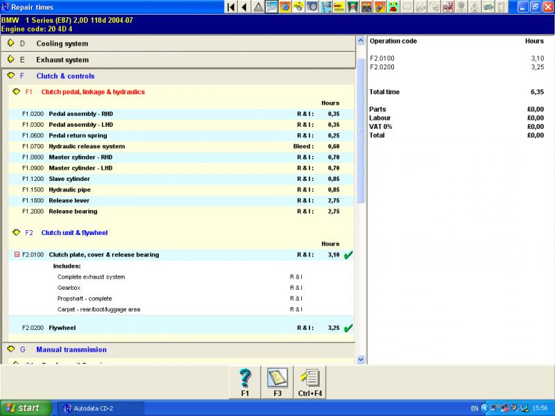

Just paid £140 labour for all three generally but this was 4.2 hrs labour looking at about 6.35hr hours labour to the book this is
You wouldn't get 6.35 hours to change clutch and flywheel, you would get 3.25 hours, the clutch has to be removed to replace the flywheel, so you would just get the flywheel replacement time (i.e. clutch replacement 3.10 + 0.15 to unbolt the flywheel = 3.25)
