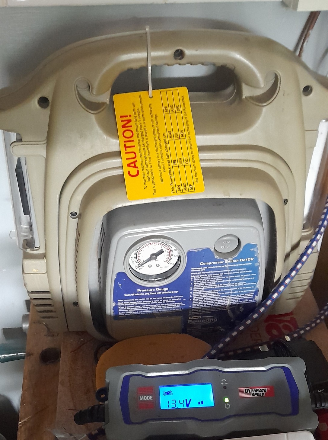

I don't fully understand, but the plug and socket arrangement could be anywhere. I have seen where a commando plug and socket powered a whole consumer unit, so with a power cut it was simply unplugged and plugged into a generator. Where one does the change, depends on the design of the house. We are hoping it will be rare, and having to leave a window open when it happens is not really a big deal.
I have a 1 kW induction hob, which I would not want to use, would prefer the camping stove, this design

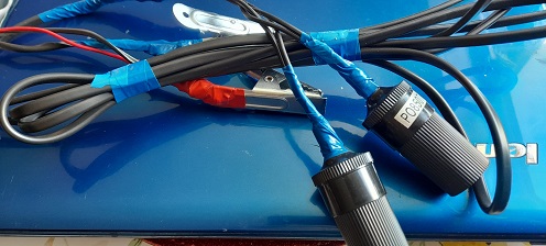

and I can't see how the induction would be any better to camping stove? The biggest problem would be to find it. The jump-starting battery, Battery pack and charger.jpg has a 150 watt 230 volt outlet, and a built-in torch, the compressor has failed, but that will power a light etc. The new version with a lithium battery is not so versatile. It may help start the car, and does have a small light, and USB outlets, but to use an internal inverter has to be running, so I made up a simple lead Emergancy power kit.jpg two crock clips one end, and to cig sockets the other end, be it an old car battery, or the actual car battery, or even the battery of the moblity scooter, it can be adapted to do a lot, including connecting the jump start until to another battery, the jump start unit comes with a lead with two cig sockets so it can be recharged from the car.
Cig lighter to USB means can recharge phone etc, or recharge USB torches.
