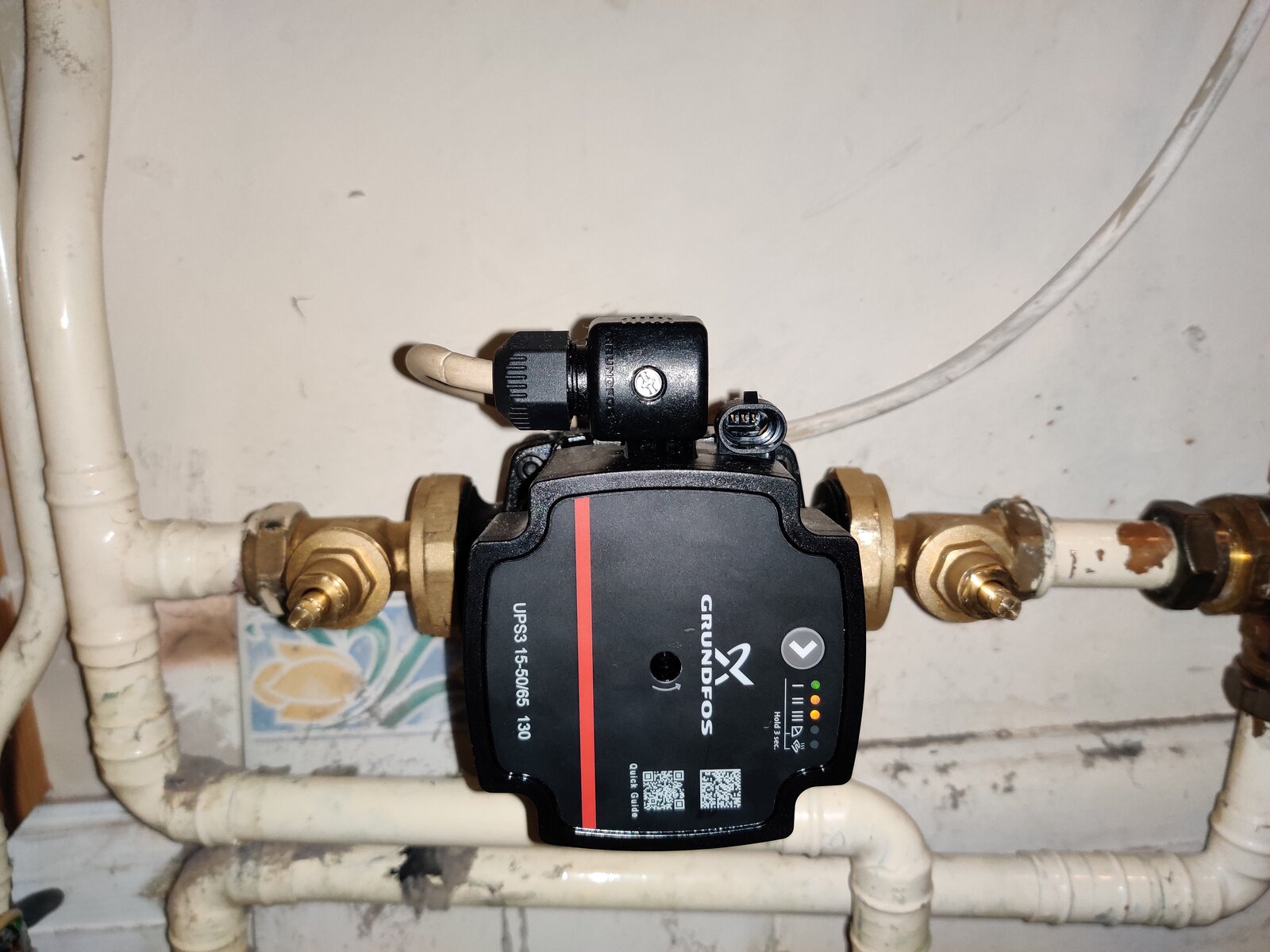

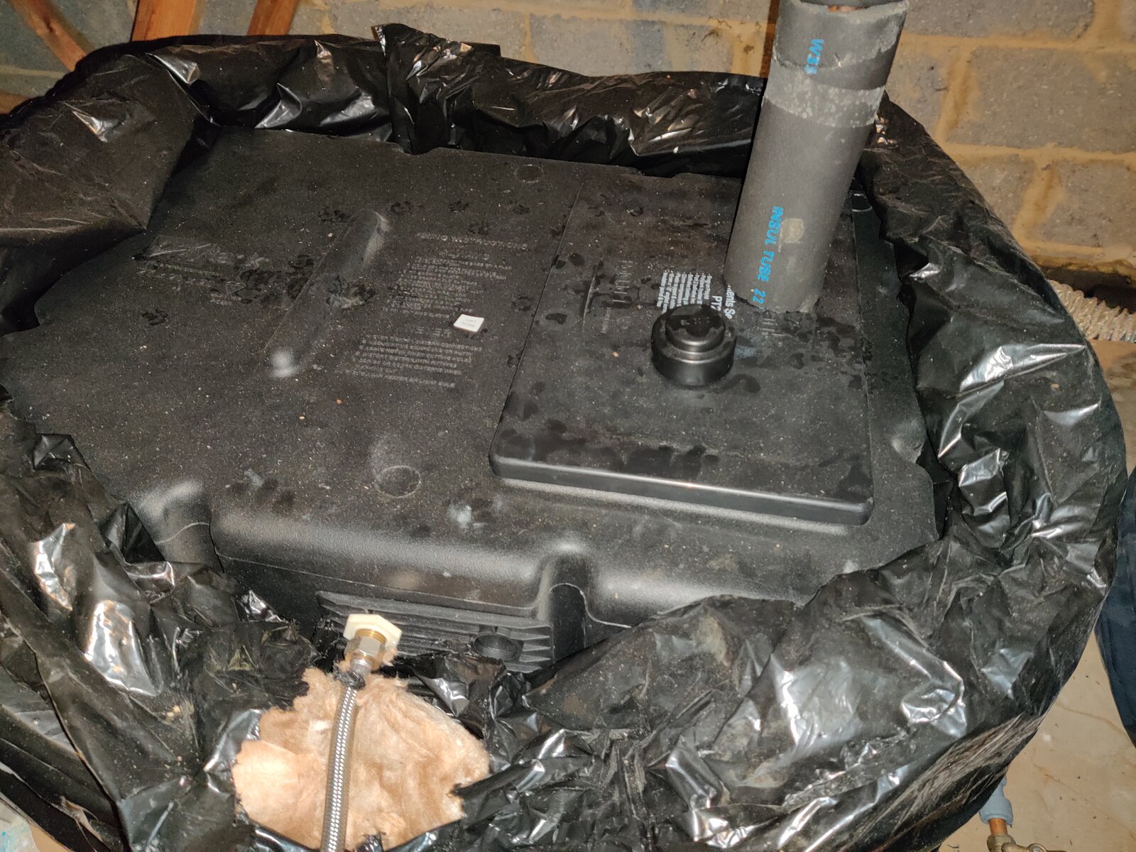

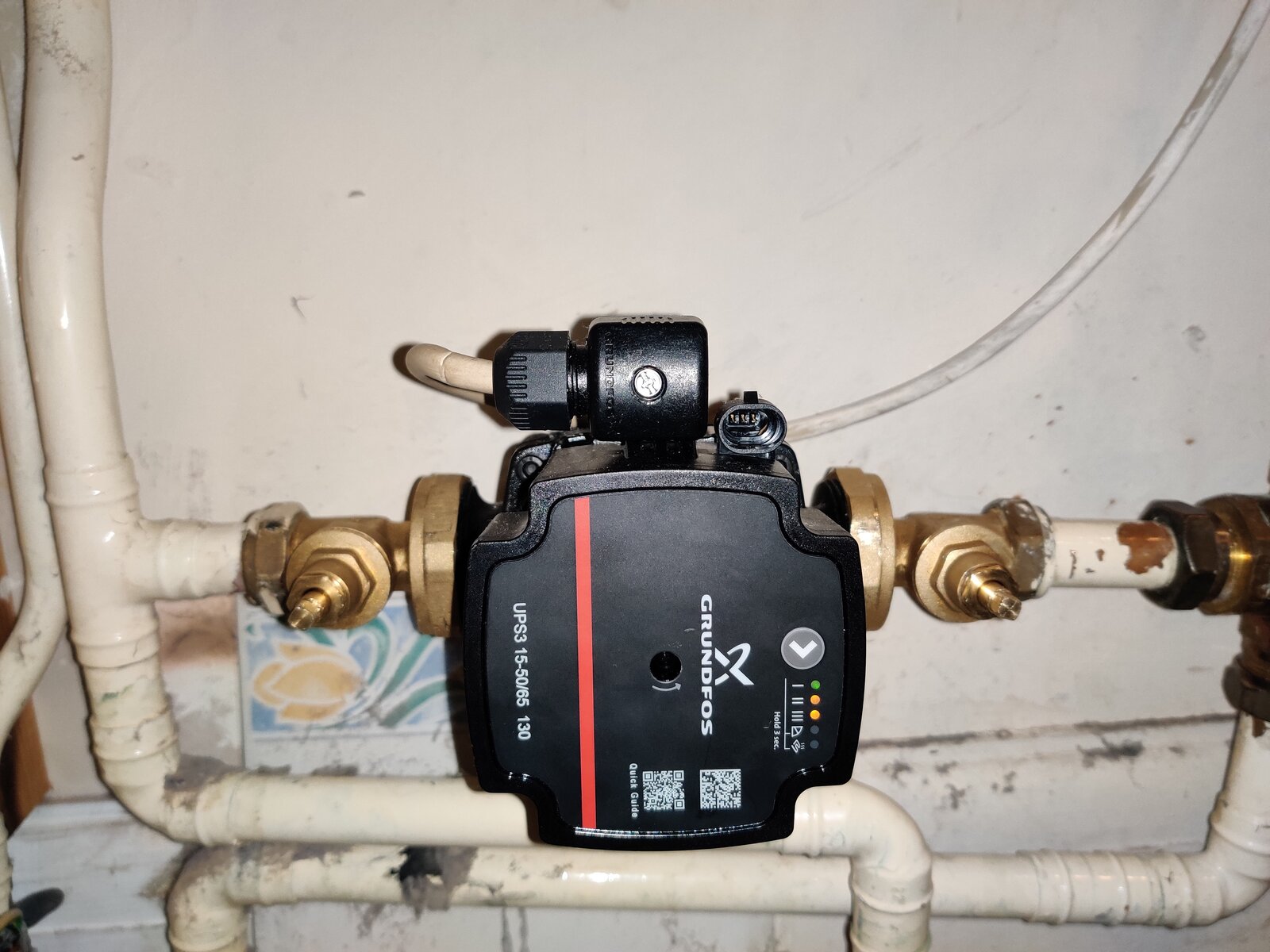

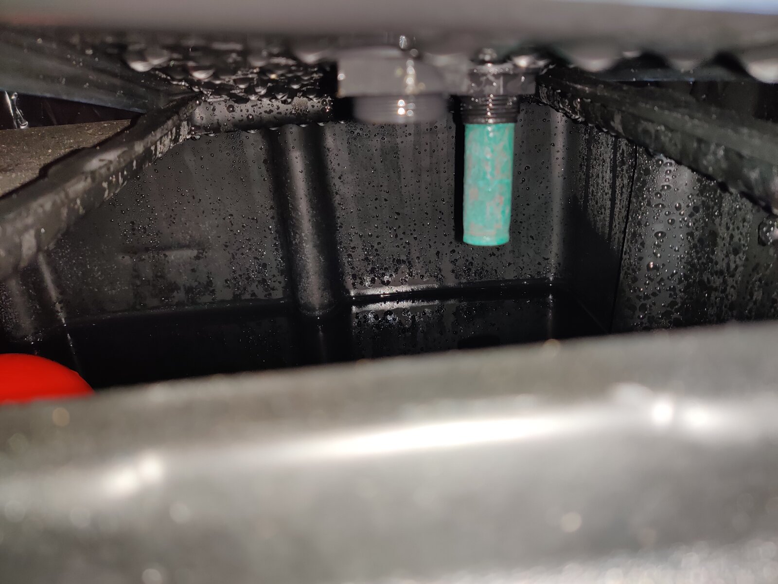

Take a picture of the new pump and include a bit if the piping around it
Take a picture of the new valve.

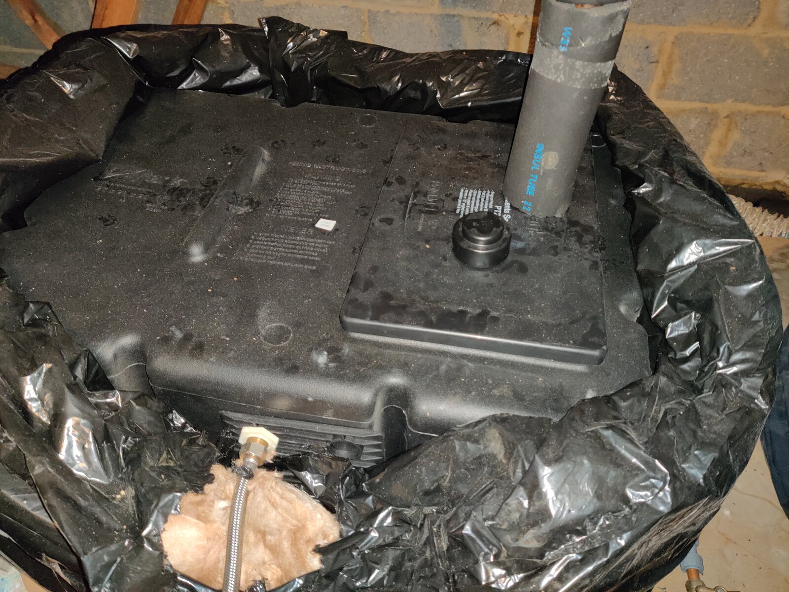

Take a picture of the head tank.

I am attaching the pics of:
The new pump
The tank (outside) - we changed the tank approx. 4 years ago as the old one started leaking
The level of the water - looks ok to me but not sure really.

The pump is a new variable speed pump.
Read the instructions.
Make a note of what it is currently set too, and then set it to max-fixed speed.
Run it for 1/2hr.
(Std commission as per the pump IOM).
This should get the system moving.
Then set the pump properly.
It is likely that this will be a fixed speed setting unless your old pump was also variable.

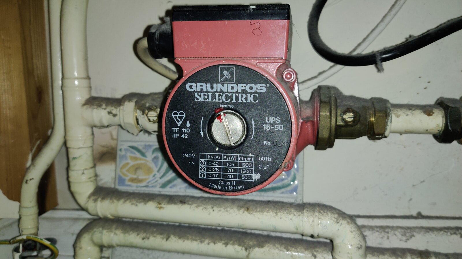

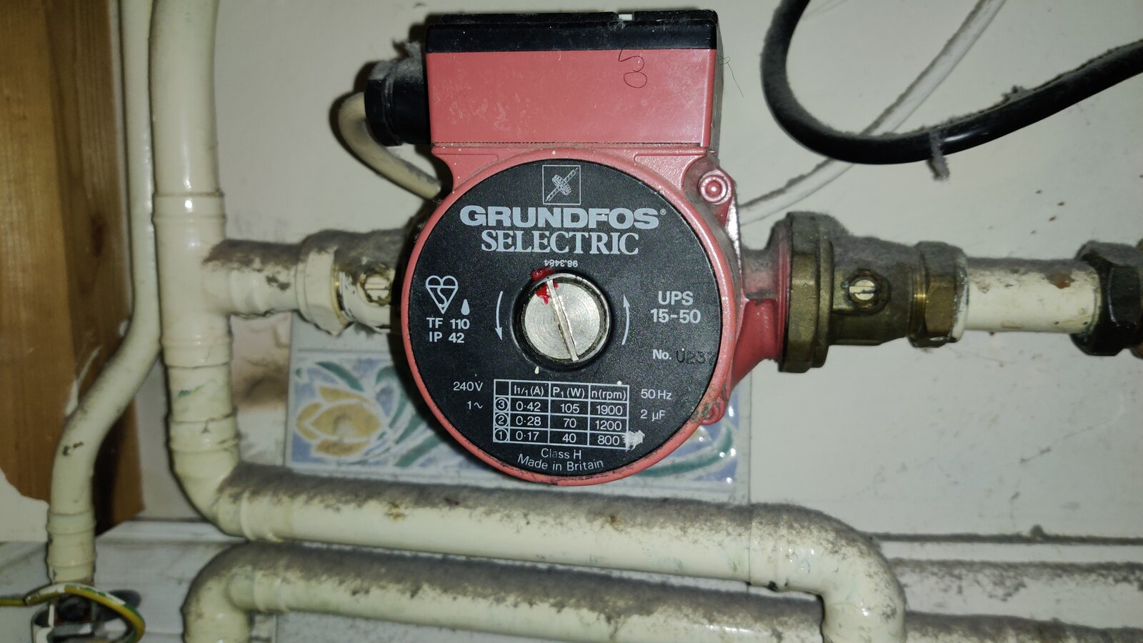

Don't suppose you have the old pump still?
Thanks a lot for the suggestion - I will try to do this in the late afternoon. I do not have the old pump with me anymore, but I am attaching the image I took a week ago.

Well that's a rare treat- a properly installed f & e tank. The blockage due to rubbish from tank scenario is far less likely than I'd originally thought...

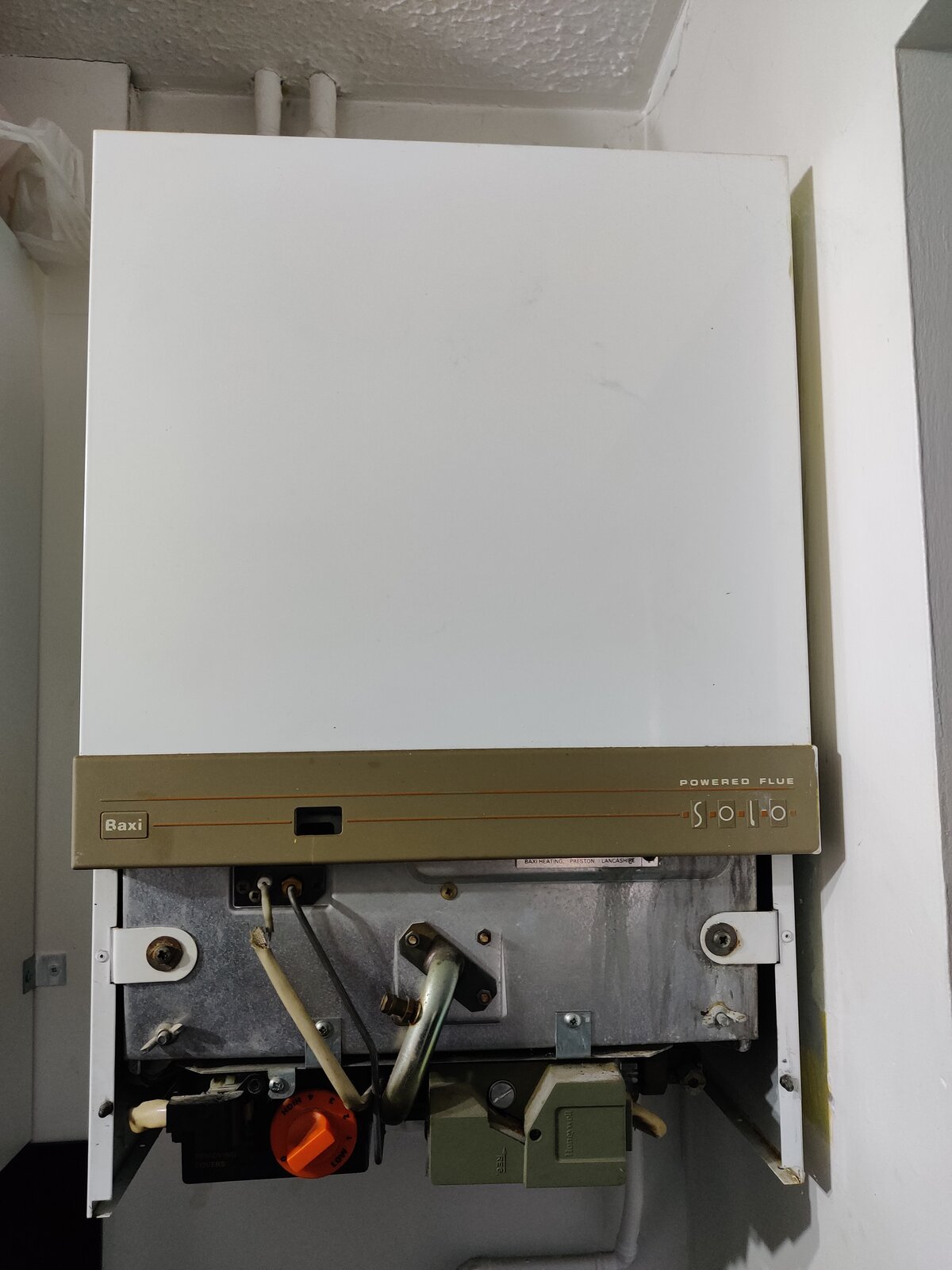

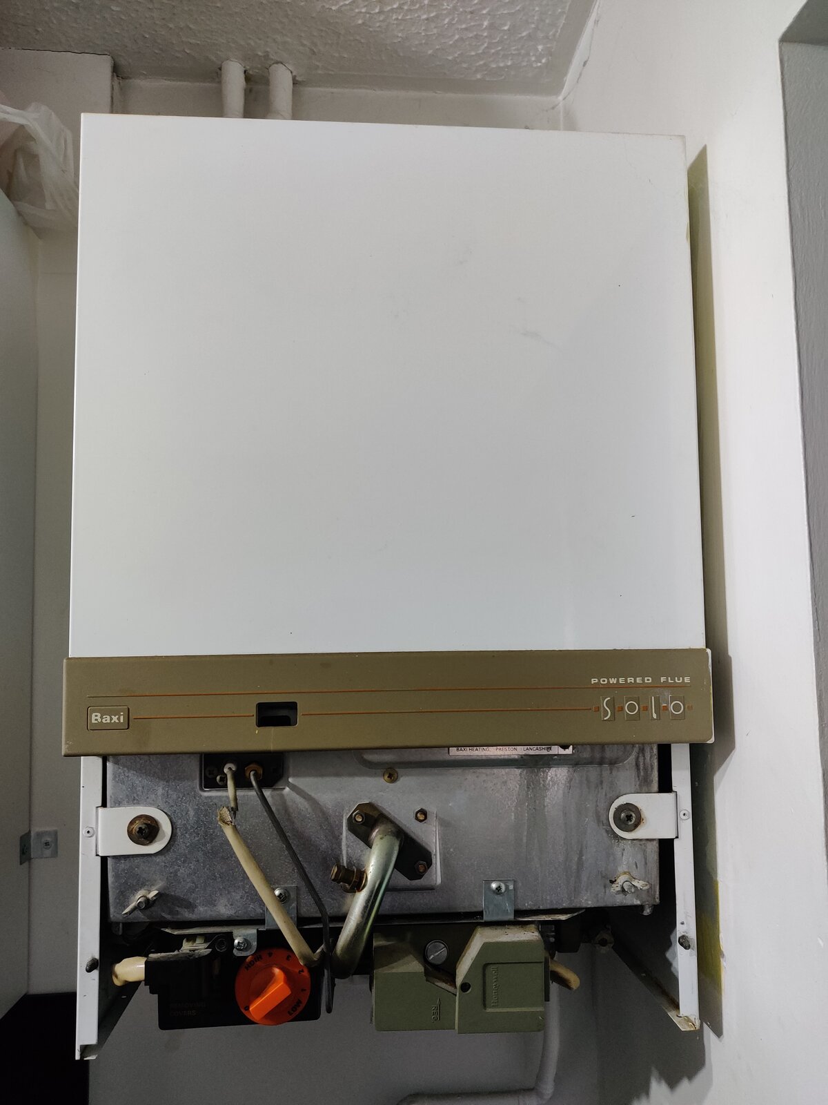

I am attaching the pic of the boiler and (forgive my ignorance) have a couple of questions I am not clear about:
- should both pipes above the boiler be hot? When the boiler starts, the left one is getting hot but I think the right one is just warm and not too hot.
- should the central heating pump be working 100% of the time or only when the boiler starts? The old pump kicked in only when the heating/hot water was being heated.

Those 2 pipes- one is flow (hot water leaving the boiler to heat rads/hot water), the other is return (cooler water coming back having heated rads/hot water).
With your setup the pump should be running whenever heating or cylinder thermostats are calling for heat. The boiler may cycle on and off (if circulation is poor so it is generating more heat than the system can distribute).
There's very little to go wrong with that boiler of yours and I wouldn't believe a word your 'engineers' said about boiler problems.
You need to start from the beginning. Check the pump valves are open. Check the pump is flowing in the correct direction (same as the old one, if you still have it there'll be an arrow cast into the casing showing flow direction, same with the new one).
Then check that the motorised valve is moving to the correct position when heating or dhw or both are calling for heat. Then check the pump is actually running when heat is called for (either heat or dhw demand). Then worry about the boiler.
Thanks a lot for this - I did now have a much closer look how the system is designed to work. In any case, here are the updates:
- checked the pump valves - open and as they should be;
- the pump was installed correctly (in terms of direction of the water flow);
- the motorised valve works fine and swithces when I change the settings on the controll panel;
- the pump seems to be working, I left it on for 1 hour at the high speed settnig. It cuts off when the valve switches to different options, then starts immediately when the switch has changed - seems absolutely fine comparing this to what used to happen before;

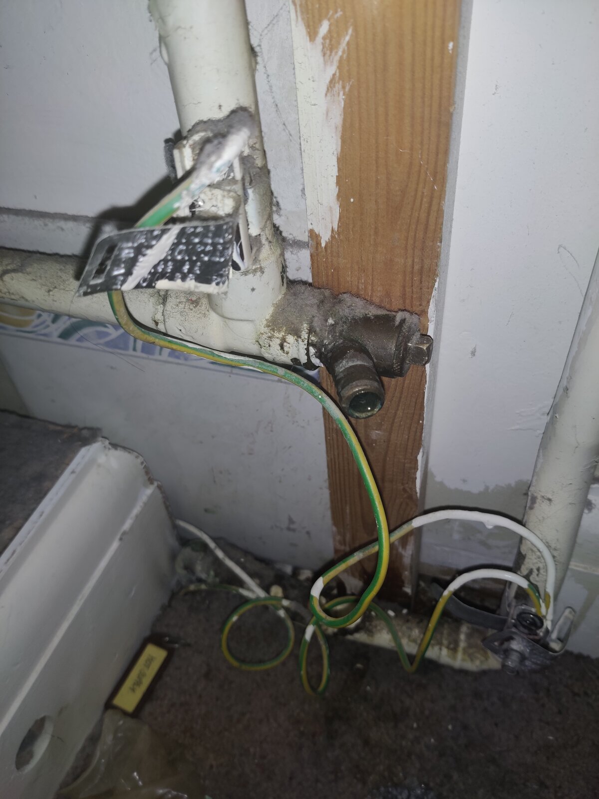

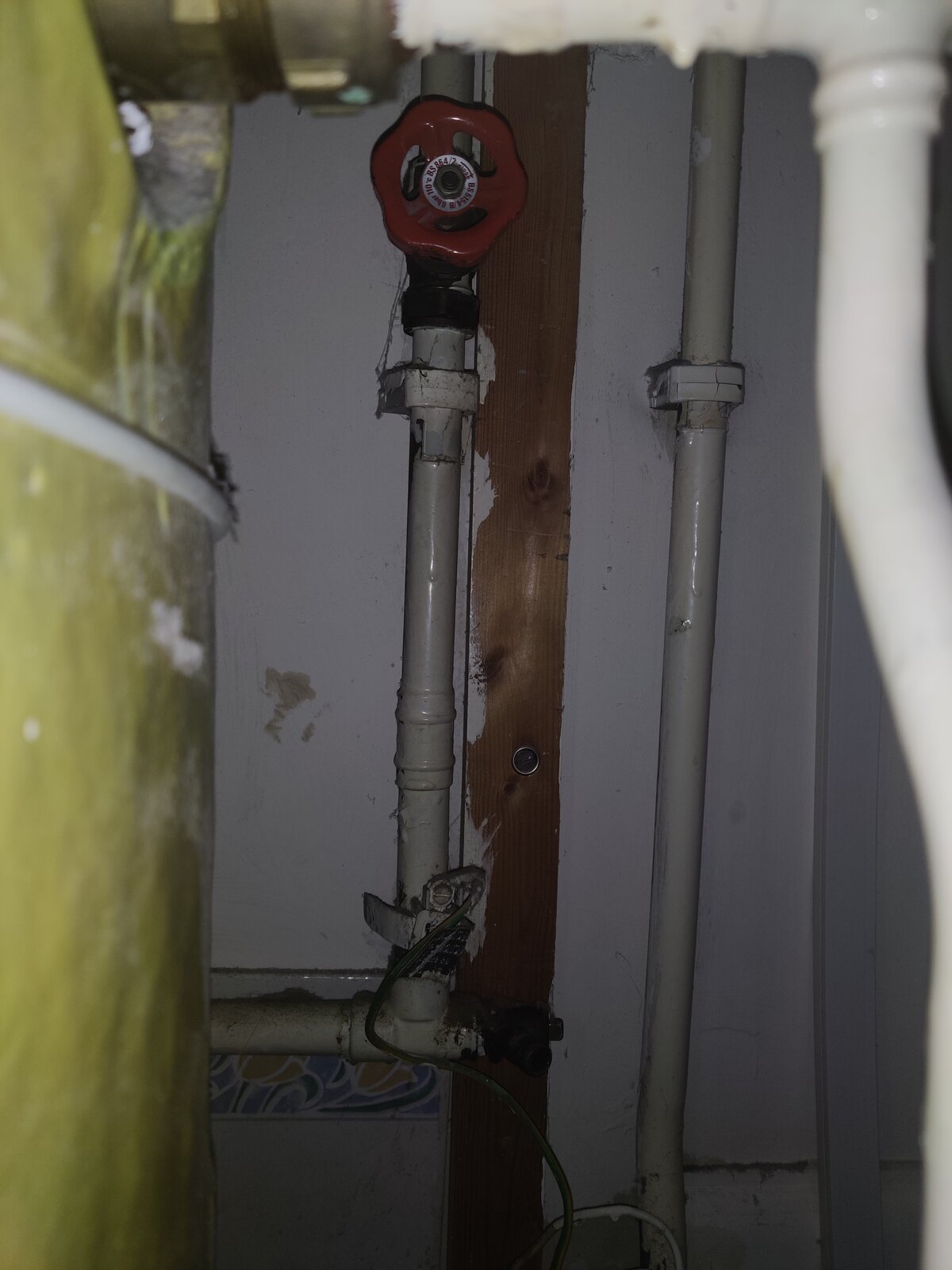

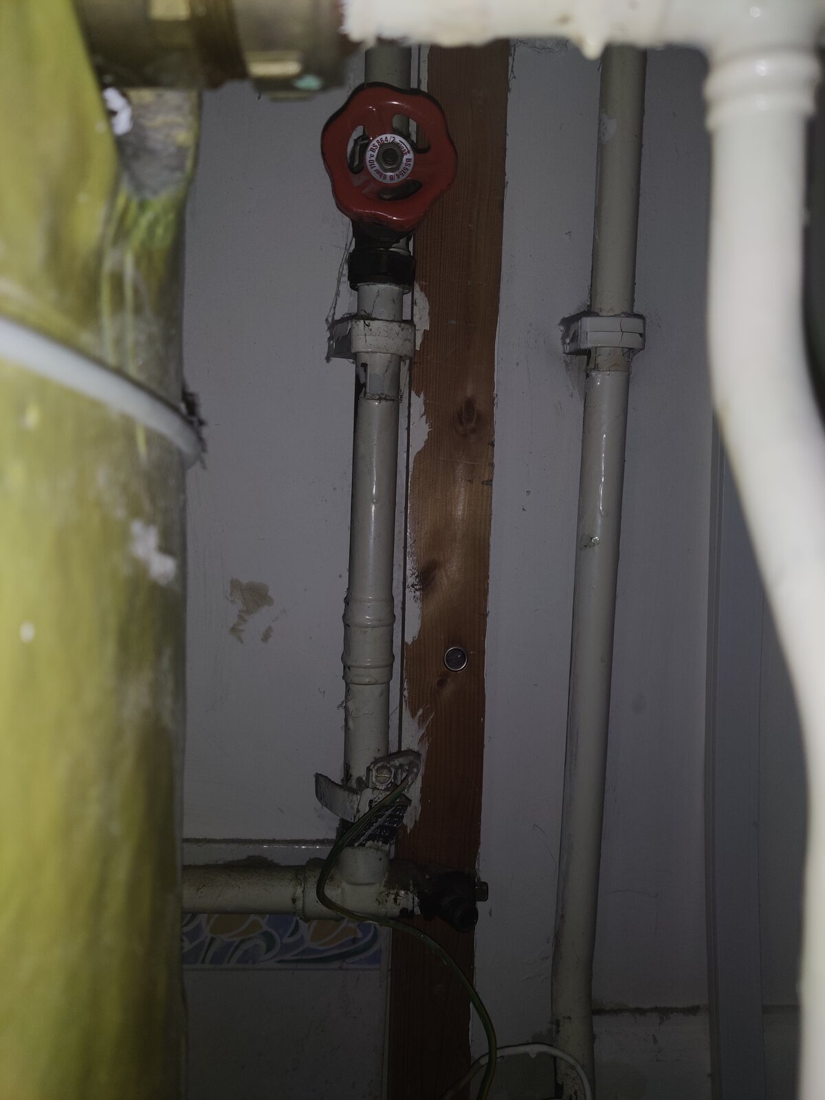

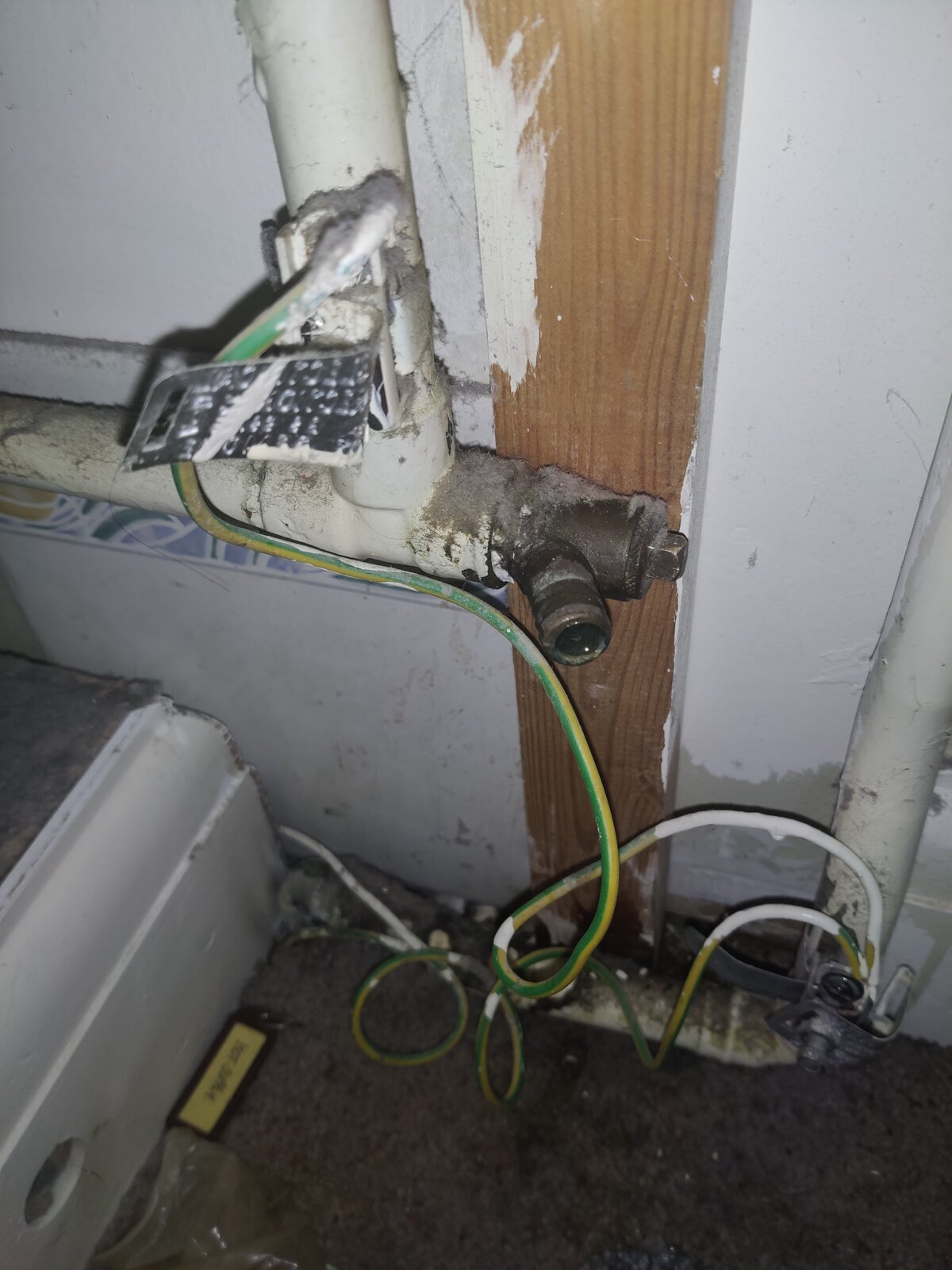

- I noticed that there is a small leak (please see the attached images) - not sure if this is the stopcock or anythin different and not sure if this has anything to do with the problem.
