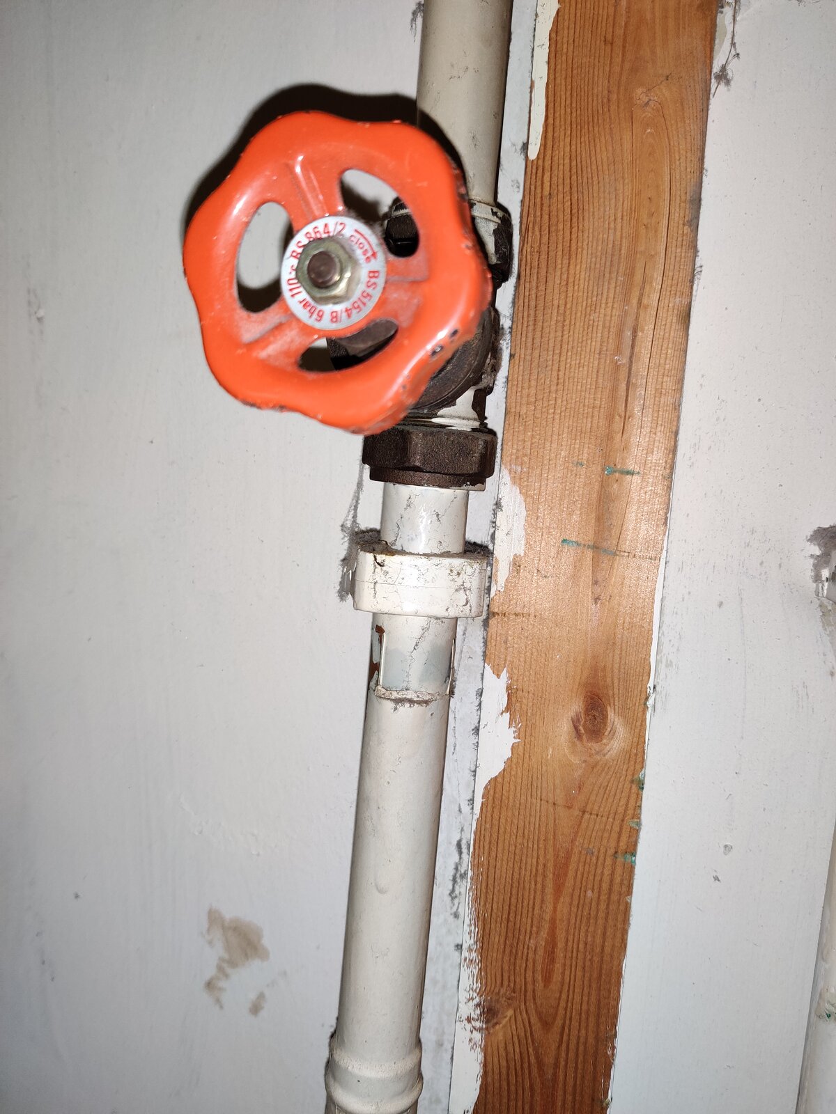

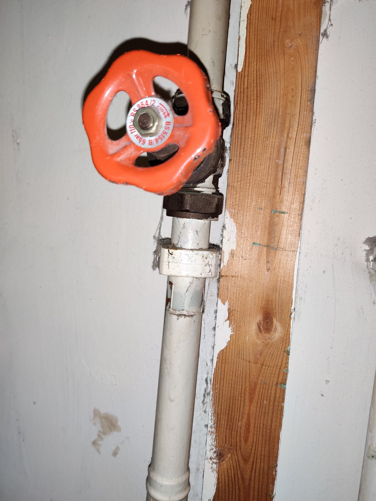

If the leak is from the drain cock (2nd pic in your last post) it's irritating but not to be worried about at the moment- it will not be causing your heating problems. The red valve in pic 1 in your last post is more of a concern- is that dripping from the stuffing gland? Has it been altered by your 'engineers'. Can you post a pic showing more of the pipework (trying to determine what that gate valve is doing and whether it should be open or closed).

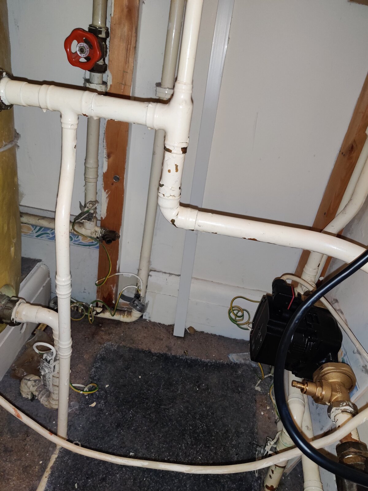

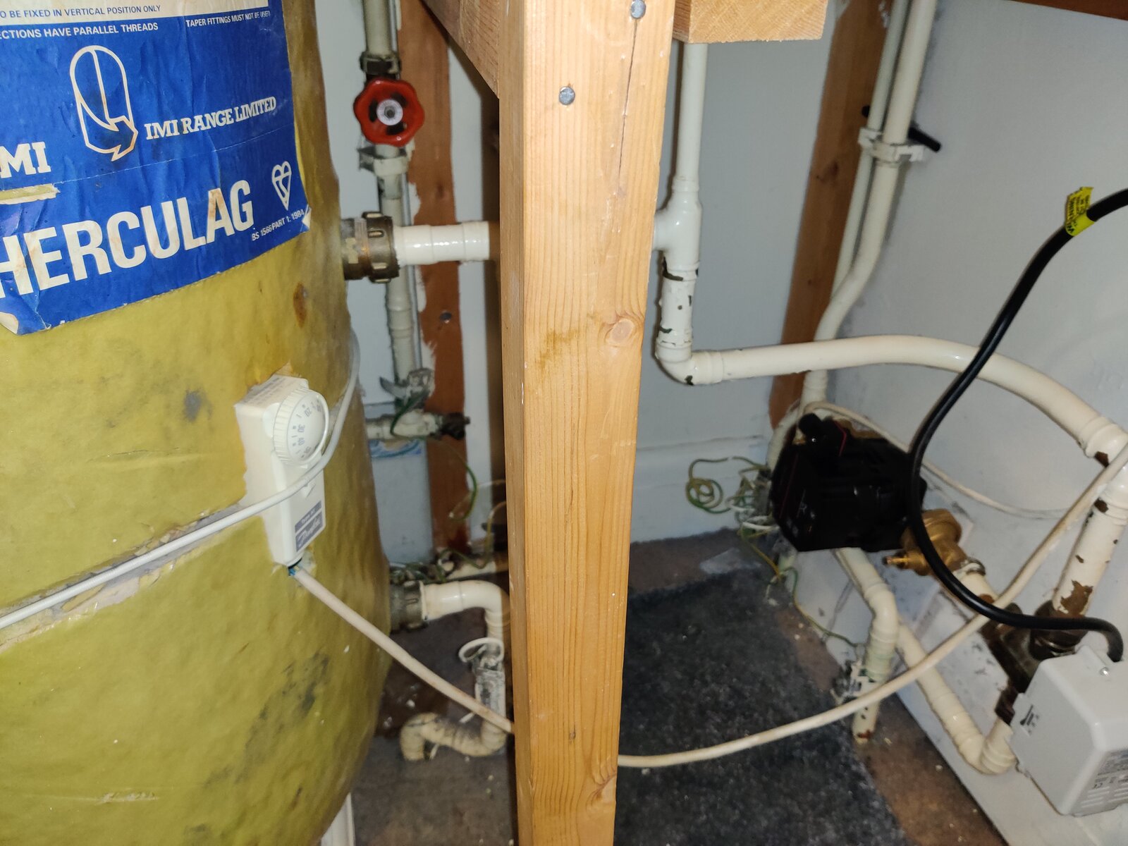

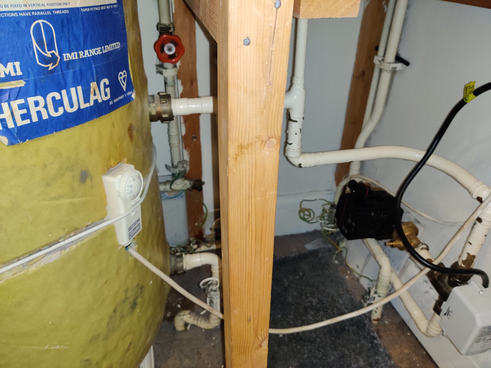

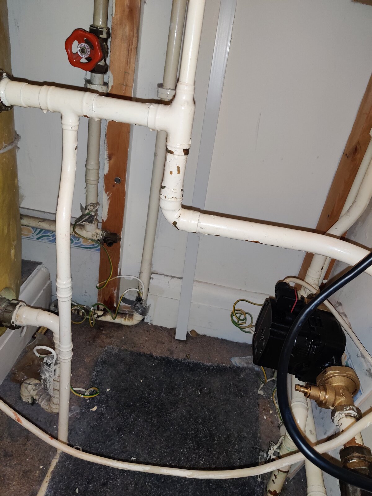

So perhaps the pics I uploaded may have been a bit unclear. On pic 1 on my previous post there is no leak/dripping from the red valve or anywhere nearby. The only leak is on pic 2 from my previous post (i.e. the drain cock). I will upload several pics here to try to show the system/pipes. I am not sure what the workers have done tbh, that is in terms of tempering with anything else apart from the parts they changed.

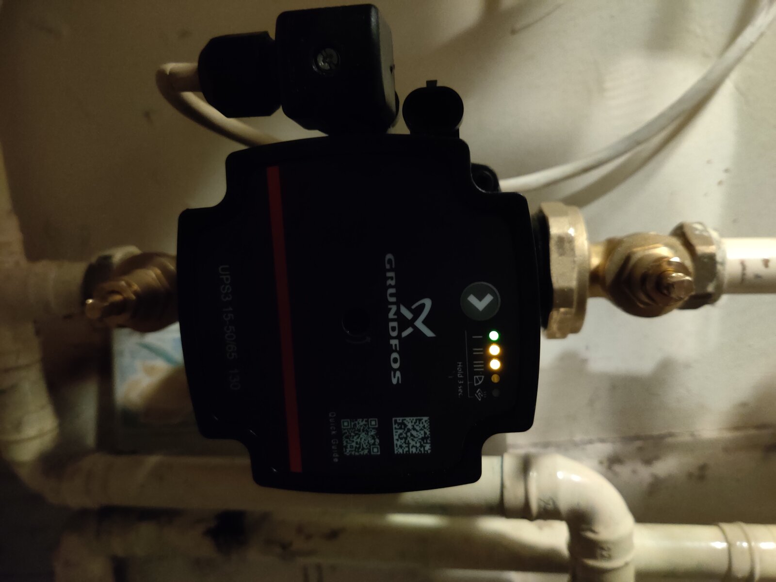

I suspect your system is the probably the earlier type, not that it makes much difference to your issue. If you room stat is calling for heat, the pump will be running anyway. I've not seen that pump before, but there is a hole, with a direction of rotation printed around it. You could try poking the end of a screwdriver though that hole, to confirm the pump is running. Usually, there is a large chromed brass plug to remove, to access the end of the pump shaft, but I guess not in this case?
One further thing I have just thought of - maybe the pump is air-locked. If it is air-locked, there will be no water in the pump, to be pumped. It will just spin quietly doing nothing. Have a look on the pump for maybe a bleed nipple, and/or look at the instructions if they have left you them.

I found a pump manual on the Grundfos site. Not many words, pictograms, but it seems to suggest a posidrive screwdriver can be poked in the hole to check for pump rotation/ spin the pump manually.
I wasn't sure whether the draincock itself was leaking or whether it was dripping down from the red gate valve. Still can't tell what that valve is doing, if it is in the primary heating pipework and it's been closed then that won't be helping matters. Yes when the pump is turning water should be moving through the boiler, the flow getting v hot and staying hot indicates that the water is not moving.

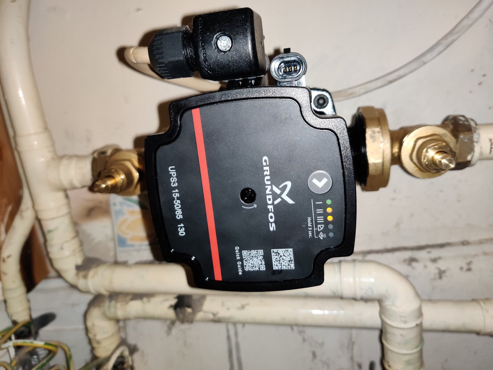

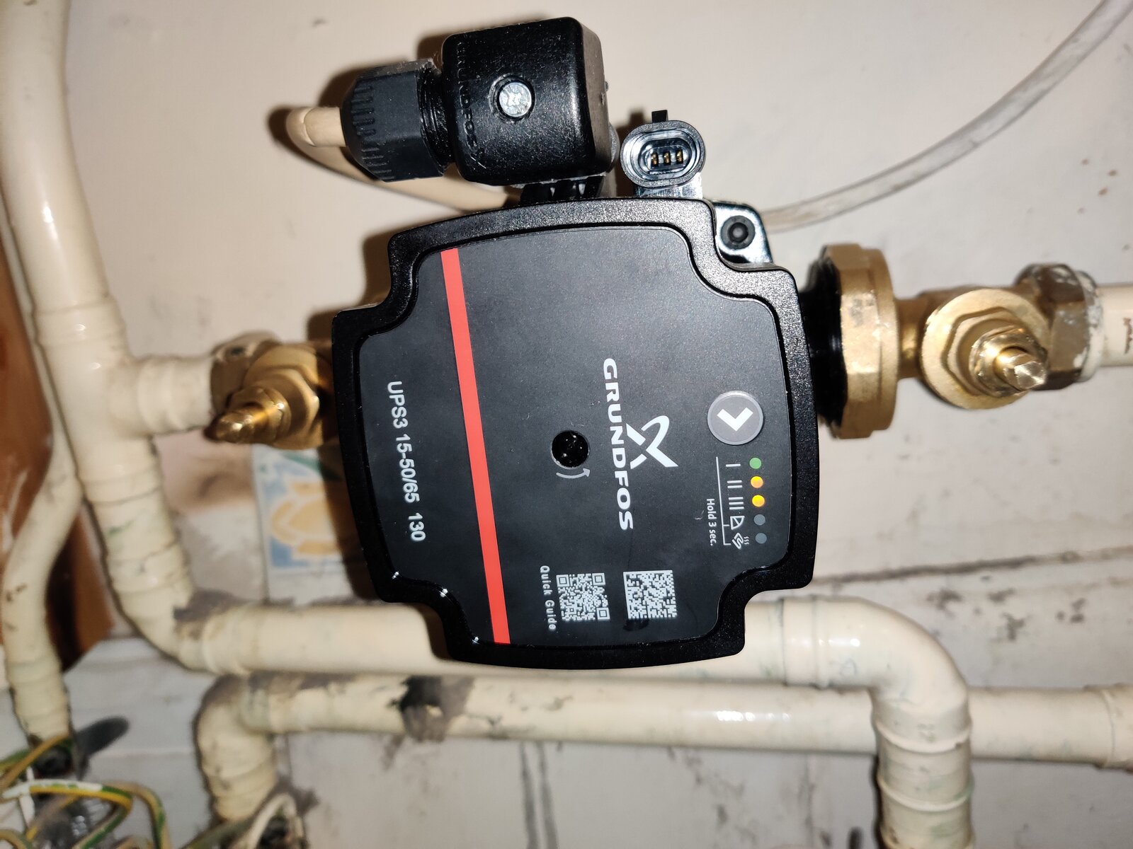

Pump running- what lights are lit on the front of the pump when it is running?
I am attching 2 pics showing the pump when working. This is how it looks when running, irrespective of the heating setting. The pump setting is at constant curve 3 (factory setting and also recommended for venting the pump).
Up until now I wasn't able to find a way to bleed the pump - as it is self venting I suspect there is no specific process for that apart from setting the mode to constant curve 3. In addition, the pump is not blocked - no error lights are flashing.

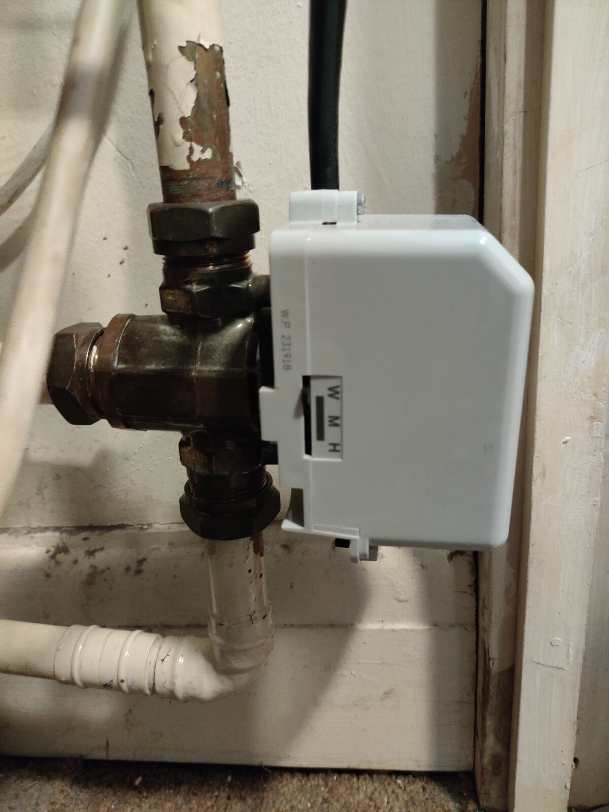

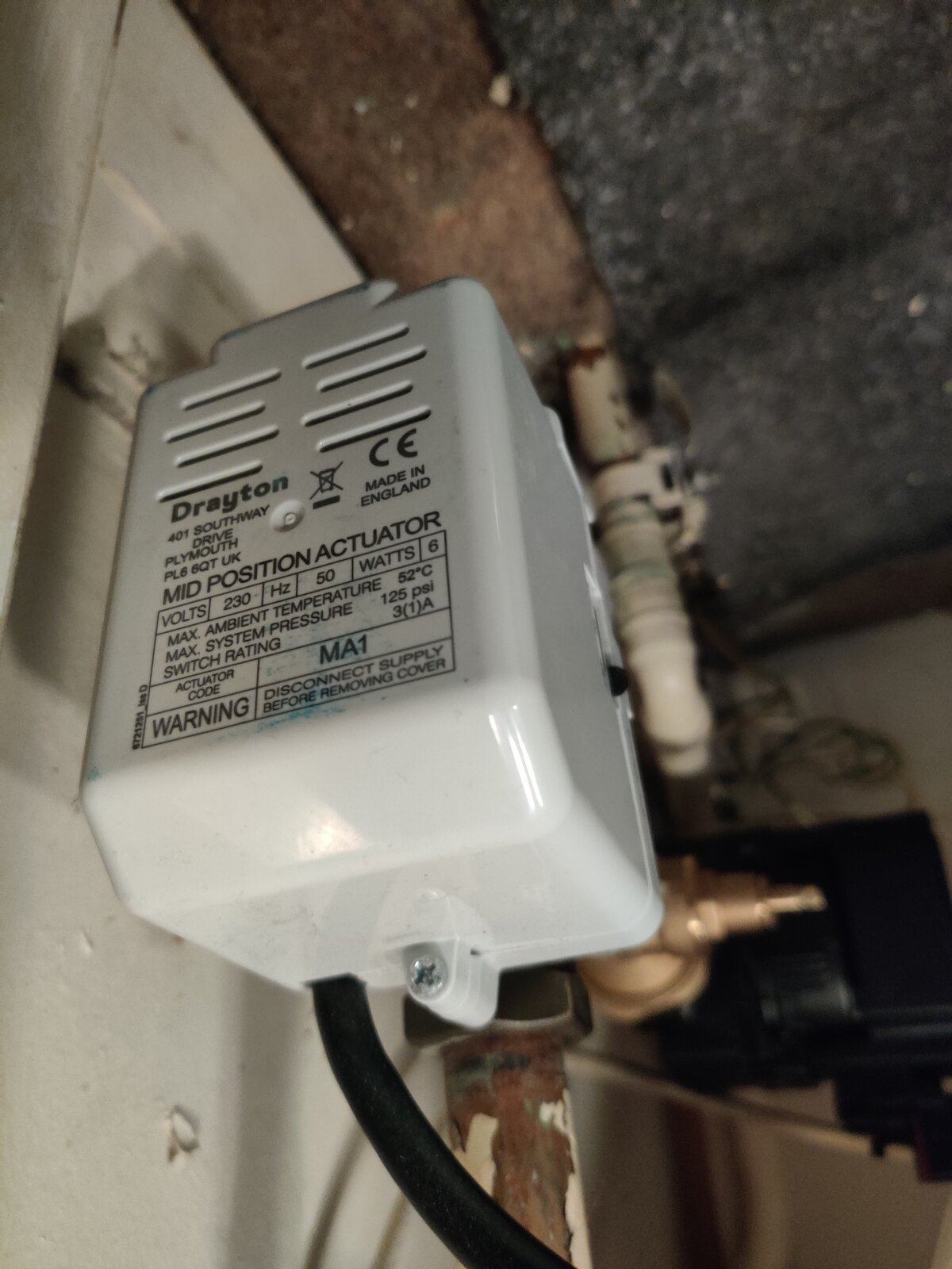

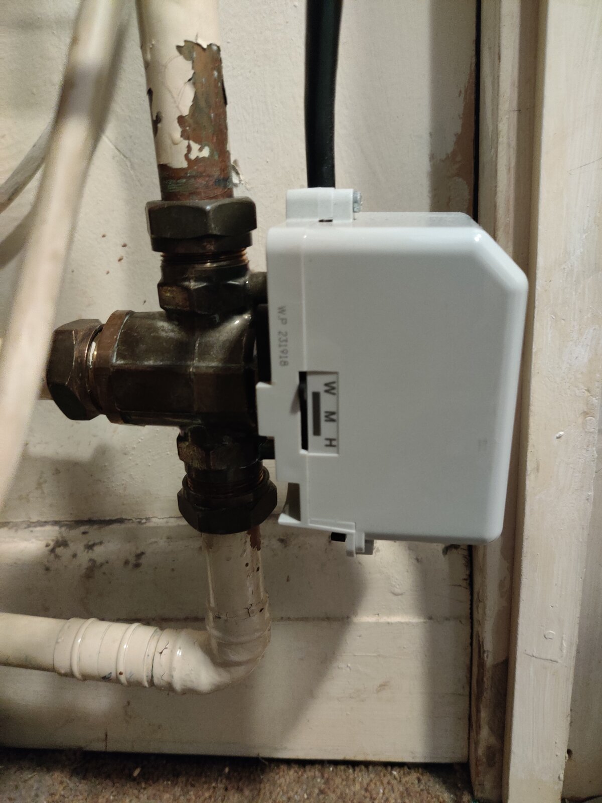

Fair enough, you've answered that possibility. That 3 port valve your 'engineers' fitted- what make is it? (Tried to ID it from the pic but couldn't get a match). Did they replace the whole valve or just the actuator?
I know you've checked that the actuator is responding to settings on the controller, I'm wondering if the actuator is actually moving the valve...

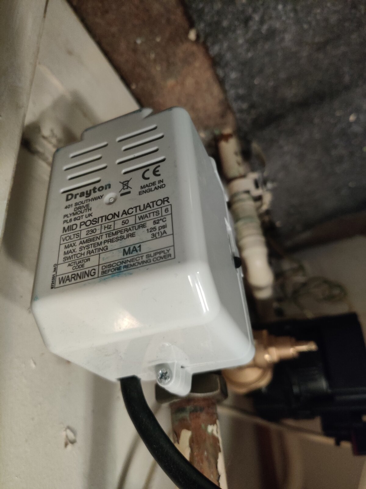

I was under the impression that the actuator was changed together with the valves. Upon closer inspection it looks like the valves are not new (they do look different/newer than the other piping so that may have confused me that these were changed). I am attaching 2 pics of the actuator and the valves.

The motorised valve issue I saw with my eyes, the valve was only able to go to 2 out of 3 positions irrespective of the call from the programmer. But it worked fine prior to installation of the pump so I am assuming that this was somehow caused by what work was carried out.
