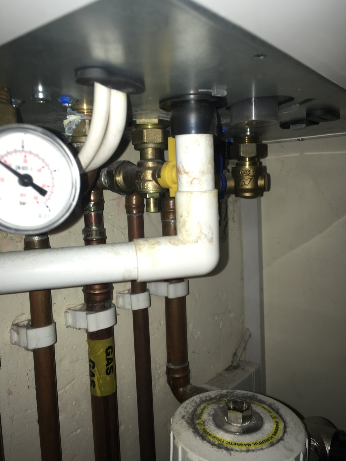

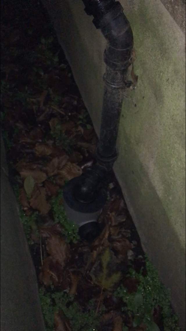

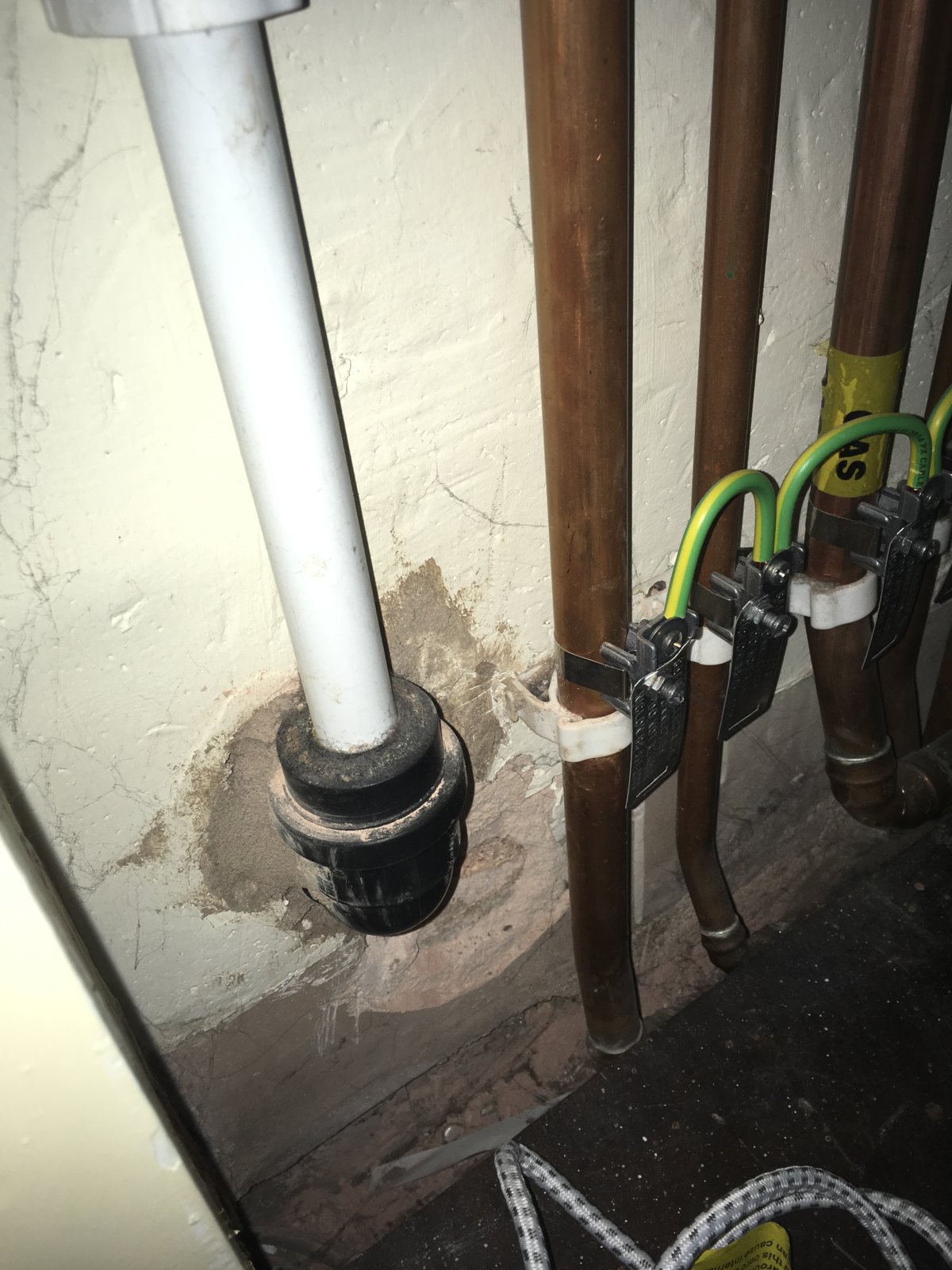

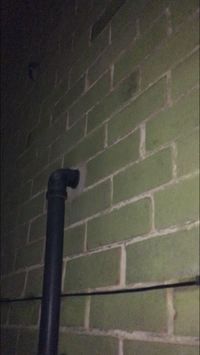

Hello can anyone help me identify what this pipe is outside of my property coming from my boiler? Thank-you

Just to follow on it’s the big grey pipe

It produces about a bucket full if the boiler is run flat out for 24hours...cannot see how that would ever be classed a flood.only slightly acidic so not dangerous...
It goes straight outside underneath your boiler...You would see it dripping under your boiler if it leaked

What is the box on the bottom of the pipe at the base? I’m not sure if there’s a drain there you see so surely it shouldn’t have been placed there if there is no drainage?
Wow all that pipe work just for a pints of water or two a day. Can the white condensate pipe not just stick out the wall 30cm or so and drip off or is it a legal requirement maybe? :confused:
It’s very confusing when it’s light tomorrow I will go back out and have a little dig and see if there is a drain or not as it can’t be just going no where!
It is your condensate pipe.carries slightly acidic water away from your condensing boiler.Into a soakaway by the look of it

Possibly the box is a "soakaway" filled with calcium carbonate granules or similair that neutralises the acidity.The volumes are very small.
The area outside doesn’t smell at all from what I noticed. Oh so the soakaway box doesn’t have to be connected to a drain then just free standing?
Iv Googled it! Yes that’s definitely what it looks like so by slow releasing the acidity into the ground could this do damage to a building if it’s close to the wall over time? Or like you said with it been so minimal is that not an option and maybe there flood downstairs was purely just from the floods last week also I would like to add we are on a water plane with a stream running though the gardens so purely a flood is possible and it’s just saturated and gone into their flat though the concrete flooring.
