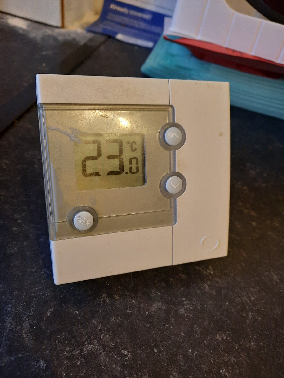

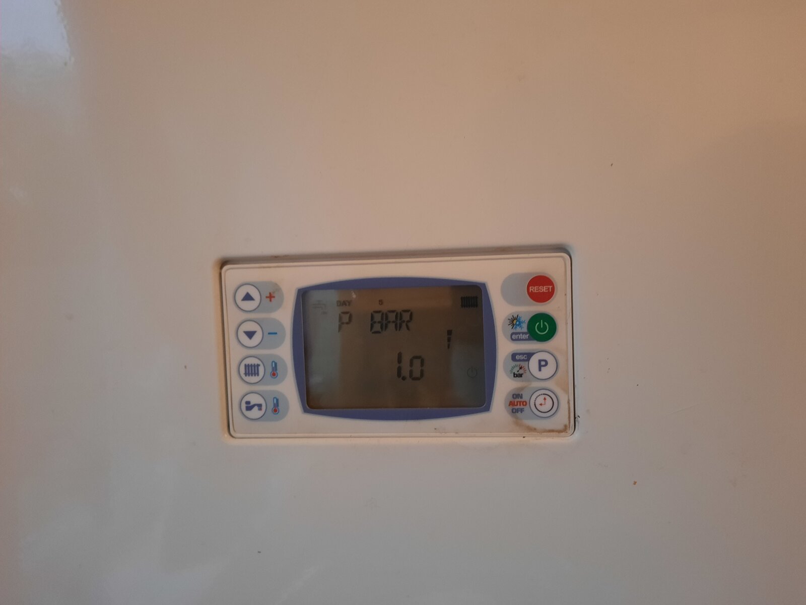

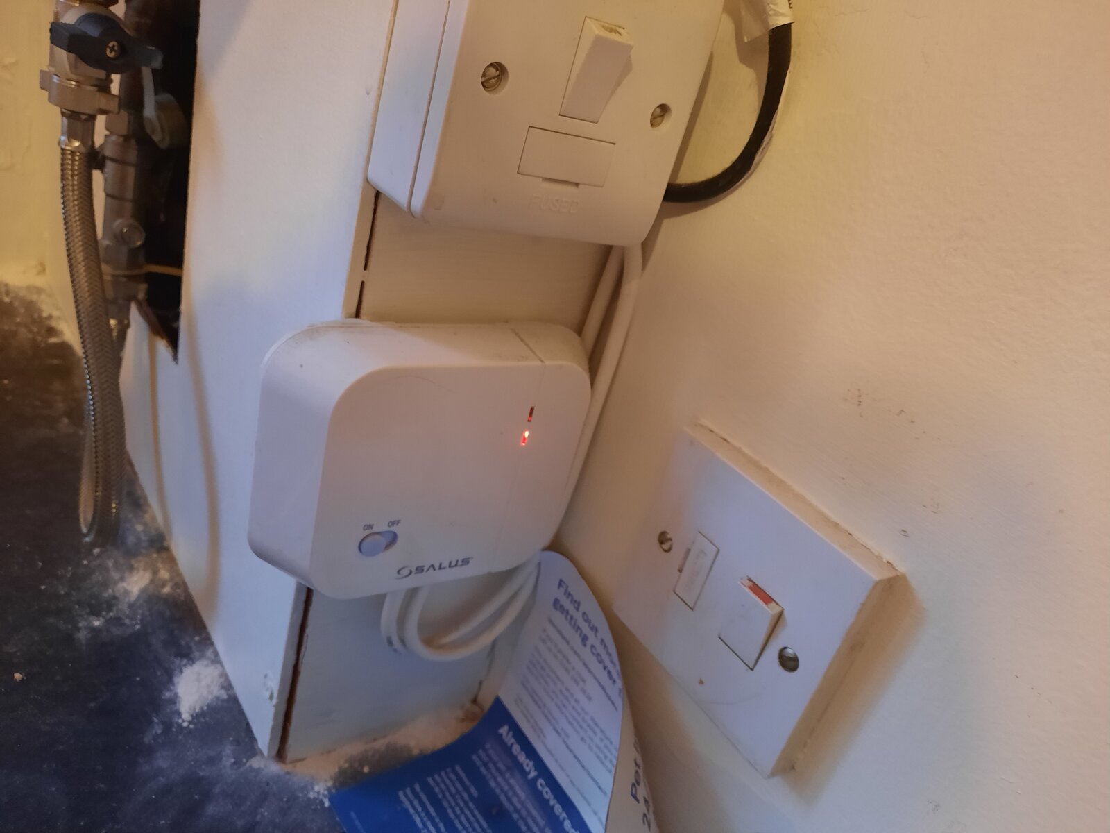

Basically, My Gas turned off duebto the meter running out. I go out, put gas on the card, Put it on my meter and come back in to see this. I won't lie, I have turned the Salus box this on and off and tried to see if that fix it. It did not. Any help.
Oh, And I really have no idea about this stuff so any help is gonna be better in real simple English and easily explained steps. Thanks.

Have you pressed the reset button ( press and hold pressed for 3 seconds)??
Please tell us the boiler make / model I.d.
Looks like the temperature set on the thermostat is exceeded, so the Salus isn't switching the heating on.

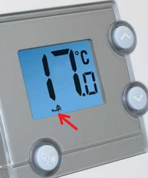

When the thermostat is 'calling for heat' this little flame symbol shows:
I don't see that showing on your thermostat:
So I'm assuming the temperature is set to a lower value, 20 or 21 would be typical, and as the current room temperature is 23, the Salus isn't turning the heating on.
