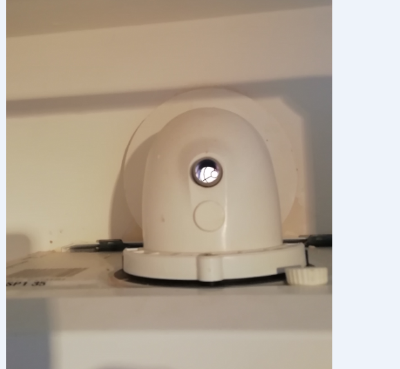

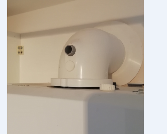

Hi, I'm just at my partner's (rented) house and was looking to install a Hive system but noticed what looks like an uncapped hole in the flue on her combi boiler (I deal Logic ESP1 35). I can feel air movement, including warm air when the boiler is running and taking a photo looks like it's open to the outside. I'm sure I can smell fumes when the boiler kicks in too. Am I being paranoid or is this wrong? Have added a picture or two, hopefully.
Oh, there is a CO alarm fitted to the ceiling a few feet from the boiler but I've just checked and it appears to be dead!

To the front right if the turret, on top of the boiler case is the cap that should be screwed on to the thread of the hole.

Email the picture to the service guy who should be very mortified.
That little white cap to the right of the flue needs to be screwed to the hole.
It is very naughty, but easily done.

That is the sample port where the service technician can sample the flue gases.
The cap has to be fitted, without it fitted flue gases, including carbon dioxide and carbon monoxide will escape into the house. Serious risk to health and possibly fatal consequences.

Thanks for the replies - since posting the pictures I've seen the cap you're talking about. Can't see it normally as it's above eye height. Service was November last year which means it's been like that for best part of a year.
Gas man coming round as an emergency - hopefully the same one who did the service!
