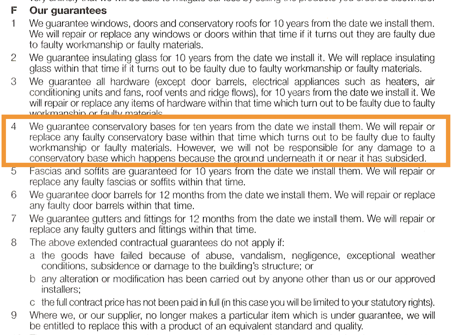

I've contacted the company. They said the tiling was subcontracted but obviously we paid the full amount to the orangery company. The attached contract is all we have. It refers to conservatory base 10 years but doesn't specifically mention tiling anywhere so they say we're not covered? Would that be your understanding too? Thanks.

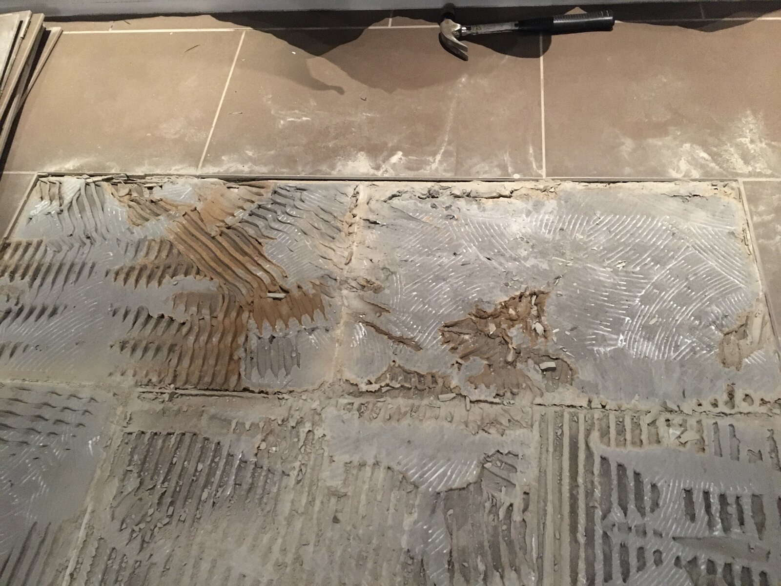

Really appreciate the comments on here - it has been a big help! Def no joy with getting anyone out but I've started to lift up some tiles just by removing the grout. Years back when installed, they were supposed to move a manhole as part of build but in the end said it wasn't possible and covered it instead.
Where the manhole is located, the cement looks a copperish colour and there are cracks which run even deeper than the concrete slab (I imagine if I kept pulling chunks up I would reach the manhole ...?
Could this also be the reason the tiles have unbonded? And whether it is or isn't - should this now become part of the guarantee because anything that affects the actual concrete slab is classed as a problem with the base?

Wouldn't they normally fit a sealed manhole? Is it possible that the seal was damaged- leading to a small flood under the tiles? Or they used an unsealed manhole?
Quite possibly. It looks as though the concrete would pretty much crumble away above where the manhole is but if I can get them out to check that part I don't want to mess around with it too much in case they try sating I've caused it ...
I think tomorrow I'll get all the tiles lifted and hopefully that will shed more light. So if sealed, should it just be a set bed of concrete on top (same height as the rest of the floor?) What happens if unsealed? Concrete just poured over manhole cover??

In the post you made it clearly states that the guarantee covers "faulty workmanship and faulty materials " as regards the "Base"
It is clear that the "Main Contractor" has used his "Approved Installers" to lay your tiles.
Given you did not appoint the tiler, the "Main Contractor" did that in turn means ALL aspects of this "Slab" must include the tiling and it follows that there is a 10 year Guarantee for the Piles, Slab, Manholes, and Tiling.

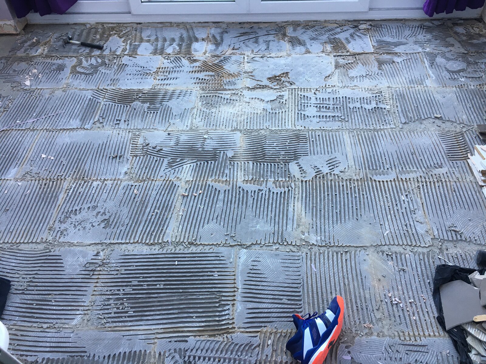

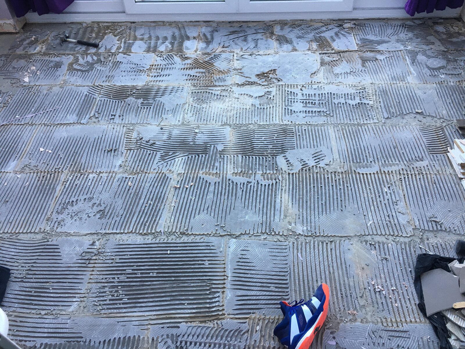

I’ve managed to get all tiles up. 36/44 had no cement on the back and came up whole.
They still say tiles & installation are not covered but they are sending someone out to check the base layer / concrete slab as there are some small holes present. Some are above where the manhole is/was - and some in the corner of the room (one is an inch wide and 5inches deep ...).
As the base is under guarantee, should I be able to request that they make the concrete slab whole again or do you expect holes to appear over time?
Also, is it reasonable to suggest that the holes could be the reason for air/moisture causing the tiles to debond over Christmas in which case I should be able to claim replacing the tiles/installation as well??
