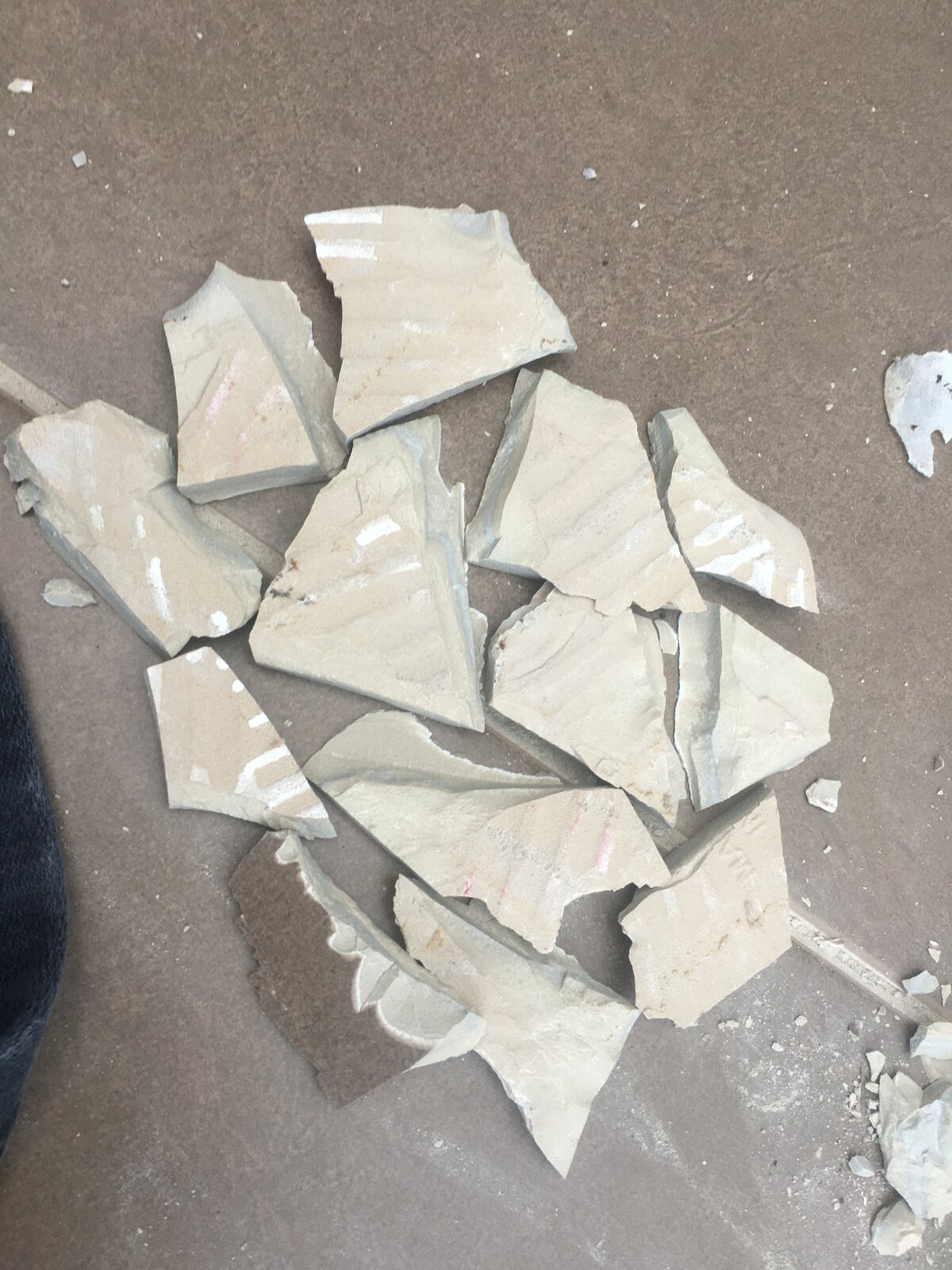

No, nothing has gotten indoors ... may well be tile adhesive but I would never imagined the loudness of multiple ‘cracks’ would be that. When I walk on the tiles now they creak - almost like a large piece of ice that is about to give way ....
I’ve partially lifted one tile. The back of the tile appears smooth - no cement attached.
The concrete floor appears in tact and still has ridged cement lines stuck to it ...
Does this mean the tiles were never properly installed? Is it worth calling the people who installed the orangery as it’s under a 10 year warranty - although maybe the tiles aren’t ...

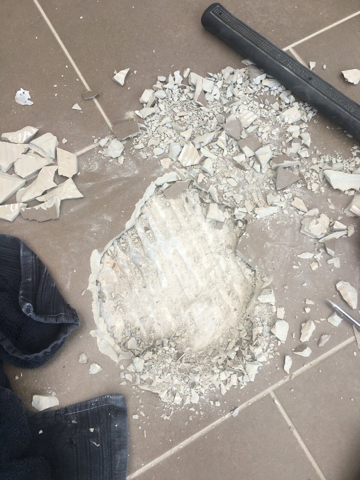

Our ceramic floor tiles have always been rock solid, but Christmas Day we heard loud popping/cracking sounds.
Visually the tiles look the same as does the grout, but the floor creaks when walking on it and every tile sounds hollow.
We’ve tried to lift part of a tile. The ground underneath sounds solid and you can see where the original cement ridges are.
The bottom parts of the tile pieces are effectively clean. No cement / residue or anything. They could be new!
Is it likely the entire floor has debonded? Can this be easily rectified? Should this be under guarantee?
To make matters worse we are due to have a replacement roof installed in 2 weeks. Can this now go ahead?
Thanks for any replies.

First port of call is the Guarantee.
Looks as if the grout used was in some way wrong? possibly too hard ? or wrong type of grout? or? tiles have simply not been layed correctly it is not uncommon to find small areas of the rear of a previously laid tile to have little adhesive adhering.
Ken.

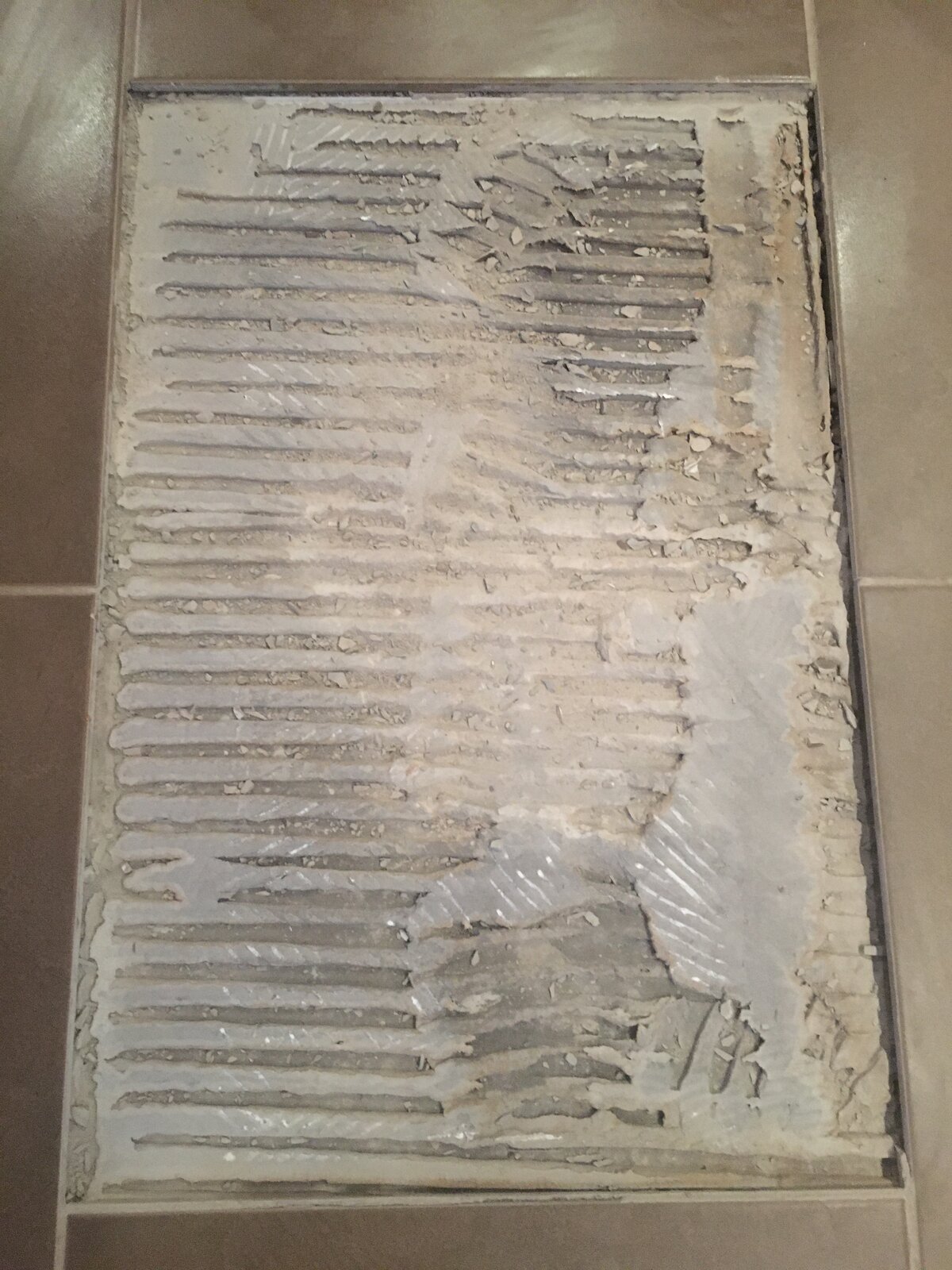

I’ve managed to lift up a complete tile - once the surrounding grout was removed the tile lifted straight up!
This is what the ground looks like underneath (with nothing stuck to the back of the tile).
does this shed any light on the problem or the installation?
thanks
That tile looks to have been loose and secured again with silicon, floor probably bodged, may have used wrong tile cement or room has flooded in past breaking the bond.
It’s never been touched since installation 8 years ago but the hollow-sounding issue + cracking & popping sound across all tiles has only just started
So is that shiny stuff silicon ?
No, they’re just chalk marks that are on the back of the tiles. I’ve still got one of the original unused tiles and that has the chalk marks on too
Concrete expands and contracts with temperature. Over 40 degree temperature range thermal expansion/contraction can be ~2mm over 5m. Obviously if the ceramics have a different coefficient thermal expansion something has to give. This is what decoupling membranes are made for. If a large temperature range is expected, it should have been installed using this. https://www.schluter.co.uk/ditra-25.aspx
