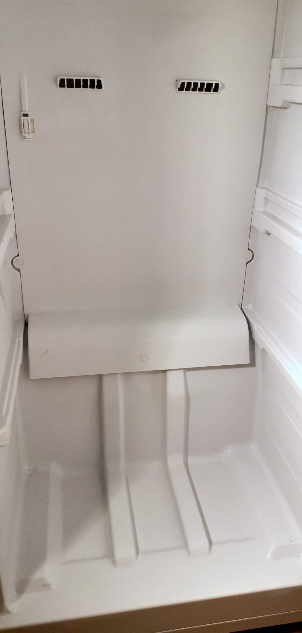

Starting to lose the will to live now as this issue is robbing us of days with no conclusion. I got to 5 degrees for some time on fully cold on the dial (to be honest, in the 2 years of owning it I have always had it set about 3/4 fully cold) and turned it down to about 3/4 and it still stayed at 5. My wife then sought advice from Google AI and had me turn it to halfway and left overnight. It was 10 in the morning. This is so frustrating as we have lost days, not to mention the inconvenience of not being able to replenish food until we know it's working properly.
It can't be the thermostat as it manages to get down to 5 when it wants to. The only other logical step I can think of which we haven't tried is another (sigh) defrost with the panel off and hairdryer pointing at the evaporator coils (if there is any ice on them at all)
So if someone can advise how I begin to remove this panel without breaking it I would be most grateful. The only other option is to book a Bosch engineer. Thanks.

It looks like there are 3 plastic caps hiding 3 screws on the backplate. 2 at the side bulges and 1 at the bottom.

I can't help feeling that if you had given it a longer defrost it would have melted the blockage out well before now.

Yes I think you are correct but I genuinely thought an overnight defrost + fan would have done it. That said it is now getting down to as low as 3 degrees (not the group) after it was 8 first thing in the morning. I have since found out that the cold dial should be halfway but i've always had it 3/4 turned in the 2 years owning it.

No because I am afraid I might damage the inside if ice is welded to the panel.
Not my area of expertise... but.. on the occasion that I had to remove the cover, it came off without issue. That said, the door had been let open for an hour or two.
The ice on the condenser was caked in ice. The cover came away with no issue. I was then able to use the heat gun to melt the ice.
Did you leave it open until it stopped dripping?
If you turn it back on while the ducts are still blocked you have wasted your time. You can't see inside the ducts and there is no airflow through them when they are blocked.

There wasn't any dripping at all in the whole defrost. Tonight I have had temp swings between 3 and 10 degrees with the door hardly opened. If it can get as low as 3 this surely proves ice has gone ?
