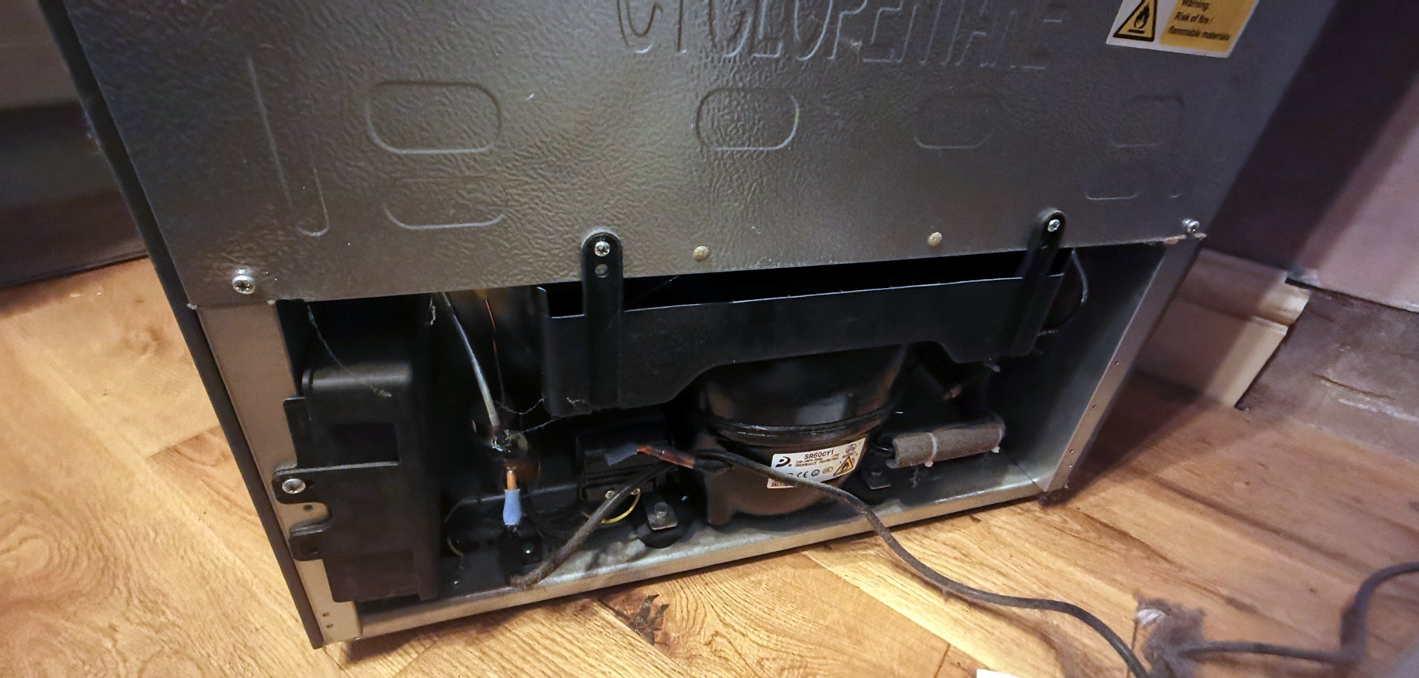

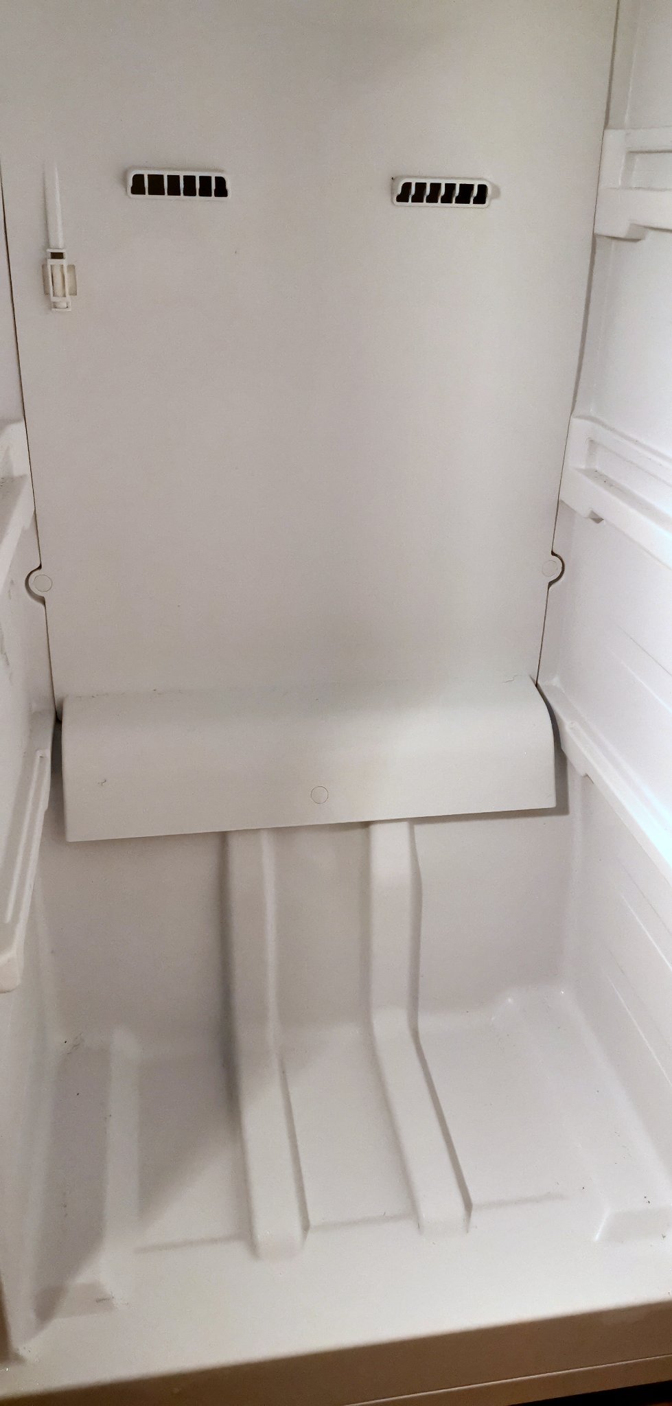

Ok, I can't see any drip tray at the back and I can't pull off the panel to see if ice is on the evaporator but leaving a fan blowing towards the inside should do it.

The drip tray is usually on top of the motor assembly where waste heat will help the water to evaporate.
It's been defrosting overnight for about 11.5 hours with a fan pointing inside the freezer. Both doors open. I have just turned it back on and now hoping that has fixed it.

Did you leave it open until it stopped dripping?
If you turn it back on while the ducts are still blocked you have wasted your time. You can't see inside the ducts and there is no airflow through them when they are blocked.

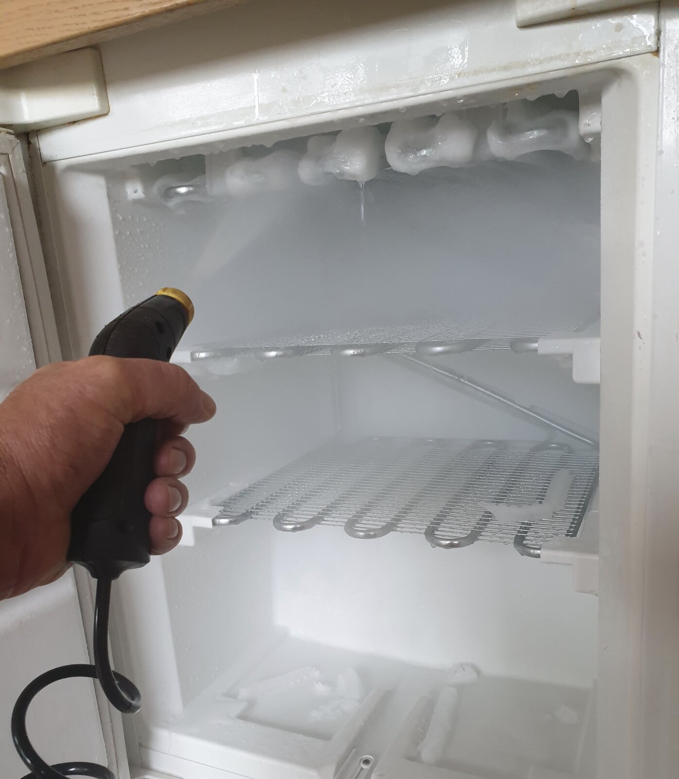

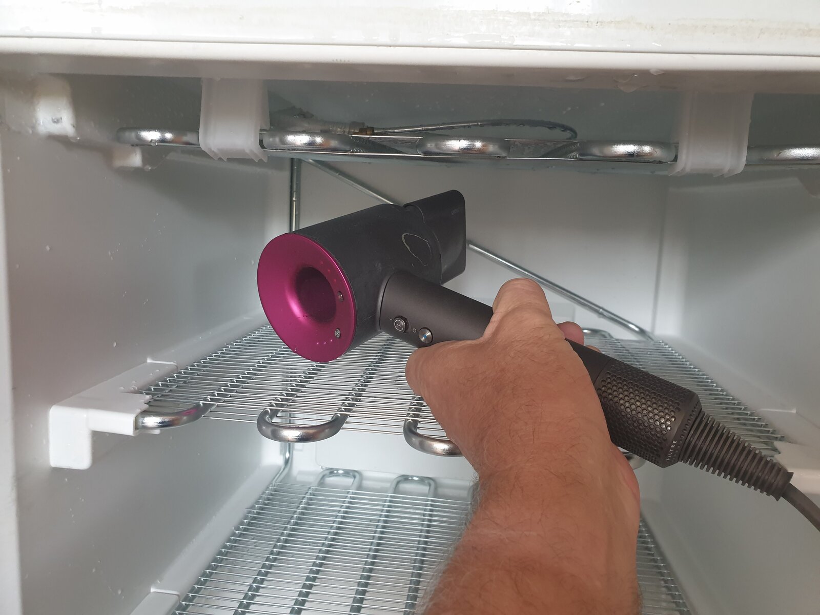

I use my Karcher OC3 portable washer with some warm water in to defrost my freezers. I just place a shallow baking tray under the drain-off to catch the thawed ice. Takes less than 15 minutes. I dry them off with Mrs Motties hairdryer. I remove the drawers with the frozen food in them, stack them outside and just just chuck a few towels over them to keep them cool.
It's a frost free freezer but again, after leaving the fridge to recover for 6 hours the temp at best is 9 degrees. Gutted! I can't see ice stiil on the element after 11.5 hours defrost in Summer with a fan blowing into it. And the fact that it hasn't made an iota of difference to the temp is astonishing. I don't even know how to take the panel off to see the element.

Ok, thanks for that and simple enough. My cool dial just says Cold and colder with a graphic thickening line to indicate (clockwise colder) having said that I have checked the temp on coldest and it's getting as low as 5 degrees and fluctuating to 9 after opening. To me this shows the thermostat is working but the airflow is probably still inhibited somewhat.
