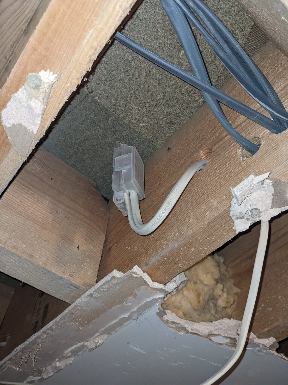

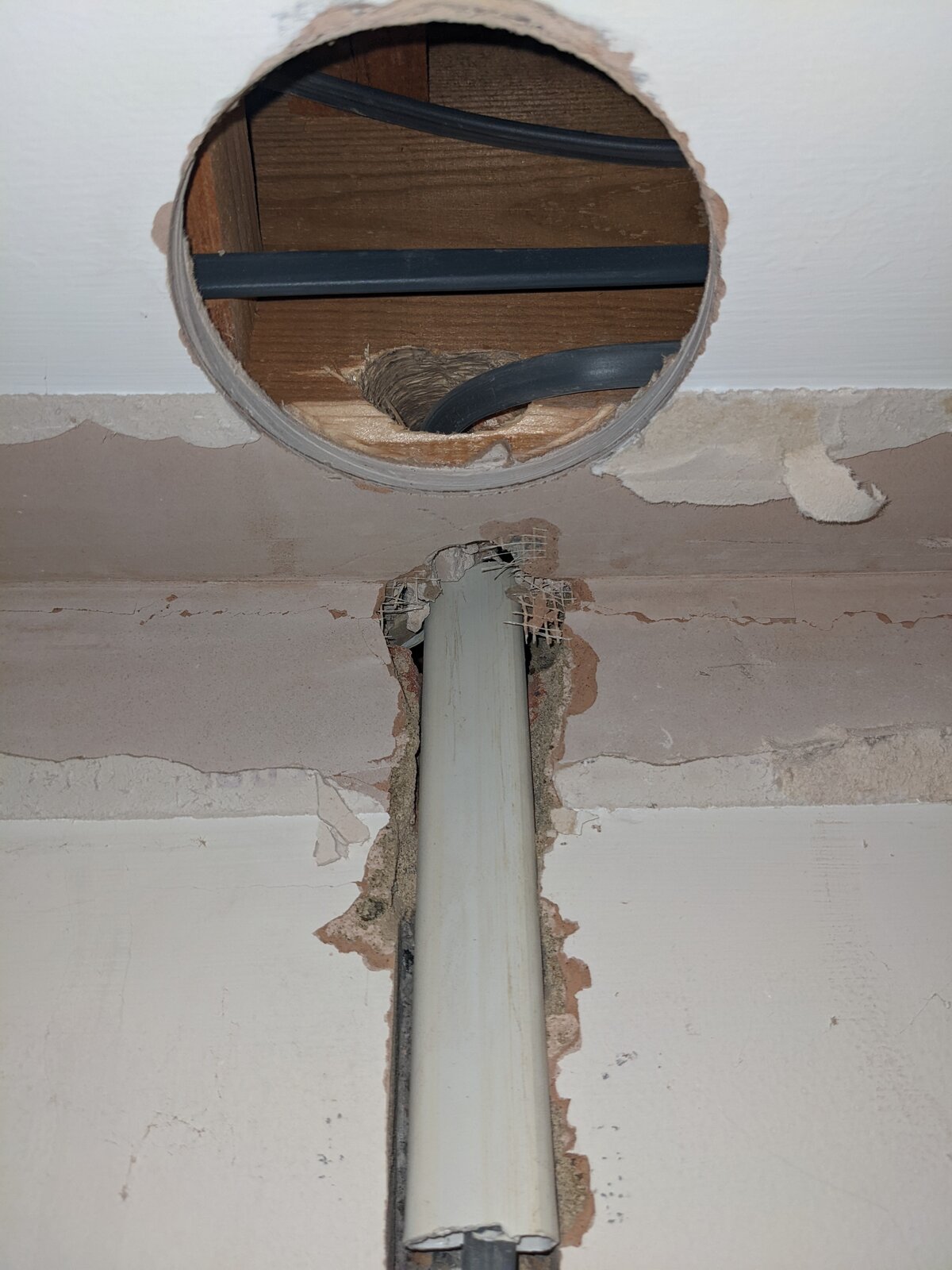

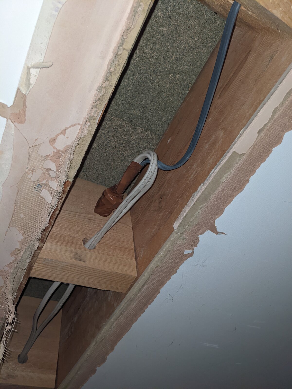

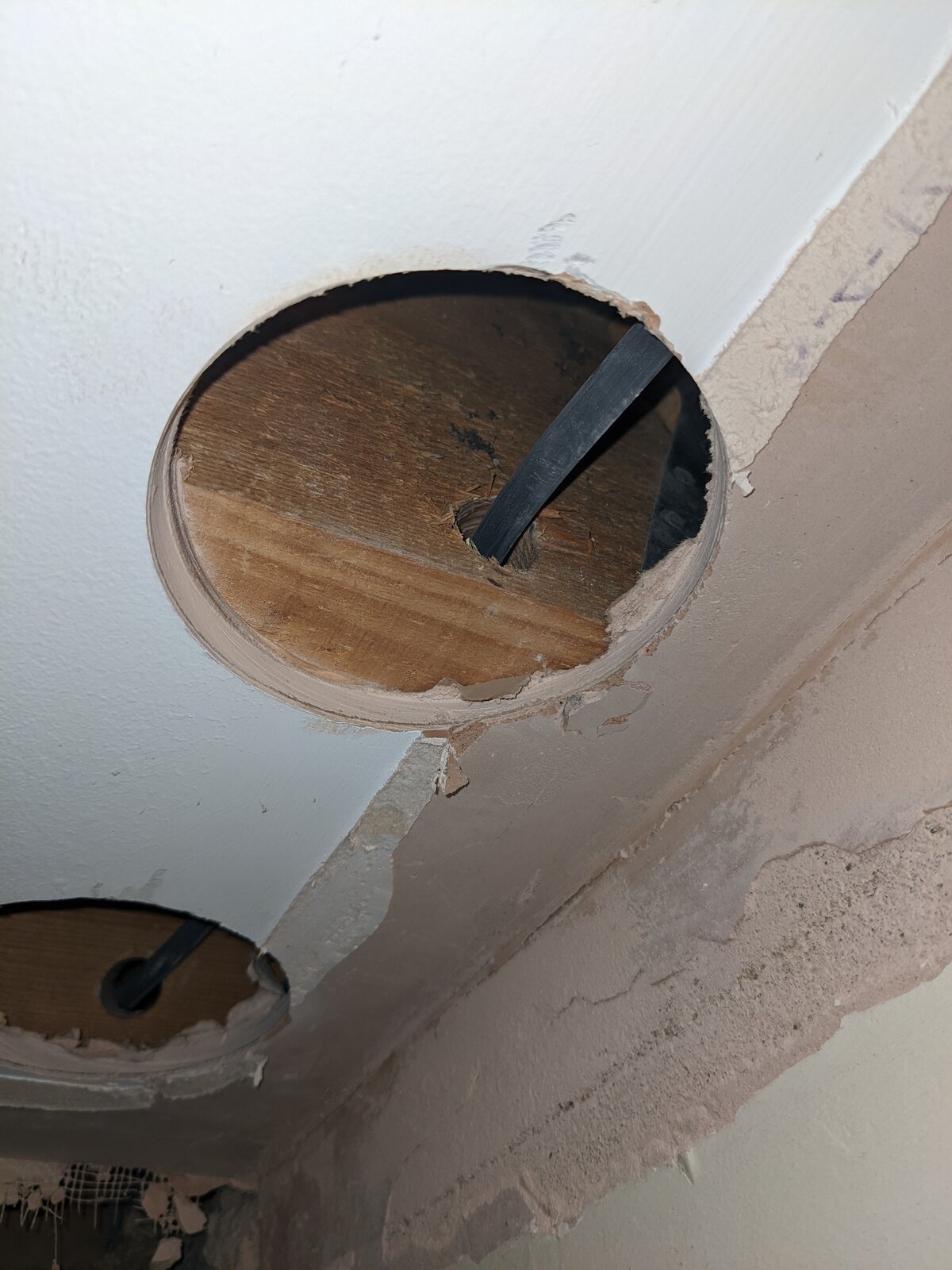

We've just had an electrician in today to install some new sockets and a new ring for the kitchen and I'm a bit disappointed with the work. After my brief look, I've seen that they've done some of the following and would love your thoughts:
- Drilled through the bottom of multiple long spanning joists right at the ends
- Extended off an existing ring using a taped up wagos above a ceiling and below a stud wall
- One double socket is a single cable spur that's about 5m long - I think this is fine, but I have no idea why they didn't bother extending the ring
- Where they have used maintenance free joints, they've been left hanging (I thought they were meant to be screwed to a joist to be maintenance free?)
Obviously I'm not an electrician (which is why I hired an electrician who had lots of recommendations on our local facebook group), so would appreciate if you think what they've done is fine. I'm really not happy about the joist drilling, as they could have gone a slightly longer route using existing holes. The owner of the company is coming over for a look tomorrow.
Photos attached.

I can't see the photos, choc block taped up? Might be temporary? I'd expect the MF junction boxes to be fixed if possible though the cables do have clamping bars are they for downlights?

On their way out they said let us know when ready for second fix, and they're happy for us to board the ceiling. The pictures are all of the mains rings. I was also under the assumption that MF boxes had to be fixed when possible (and even cable tied shut).

i can see them, if that choc block isn't temporary then it needs a maintenance free box. are there wagos inside those boxes? There's no reason why the could fix them to the joist as you say! see what boss man has to say?

I completely agree! I'll have to double check on the wagos on the box.

Personally I would have drilled those holes slightly higher up if it's possible to get a drill in there but all you're going to do is maybe put a drawing pin to hold Christmas decorations at the most and they won't even penetrate the plaster board.

I think the op is more concerned with the integrity of the joists.

Indeed I am. I'm not really sure what to do about it. I imagine it will be fine, the joists are from the 90s, so hopefully have some structural integrity unlike today's wood
centre drilling is more to do with compression and tension of the joists which is minimal in the centre of a joist
That's what I thought, with the bottom tension part being the most important
Though with bigger joists i feel its less of a concern, while the holes are in the ceiling maybe worth checking there dimensions, the holes do not look that big to worry about, when you see how much plumbers cut out for pipes sometimes.
They're 22mm holes in 220x44 joists over a 4.2m span (max span for such a joist is 4.5m). So there is a slight bit of tolerance I guess. At least the holes are drilled at an angle, so they're more central on the other side.
I told them multiple times the ceiling is being over boarded so they can make much bigger holes.
