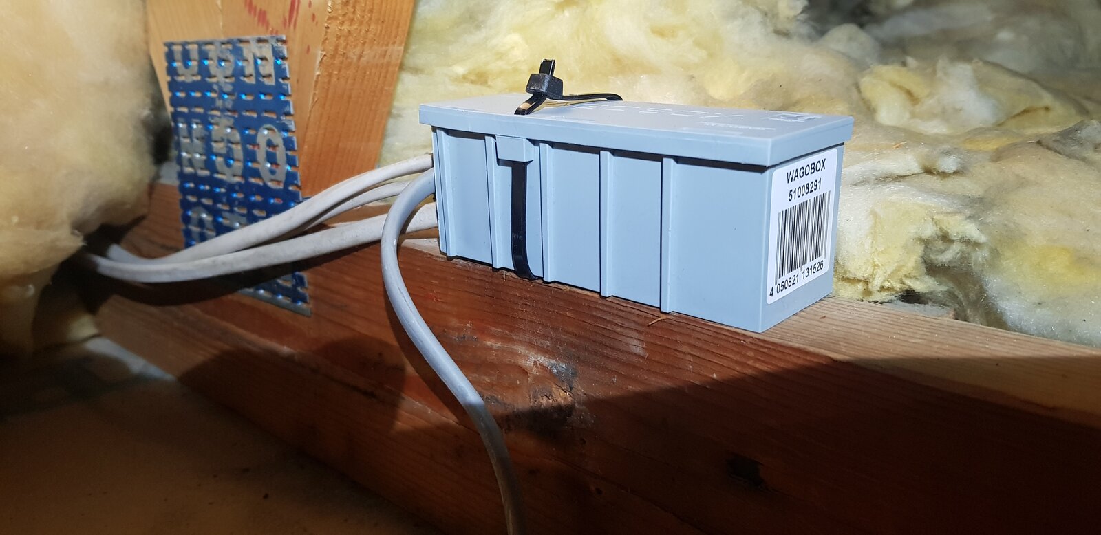

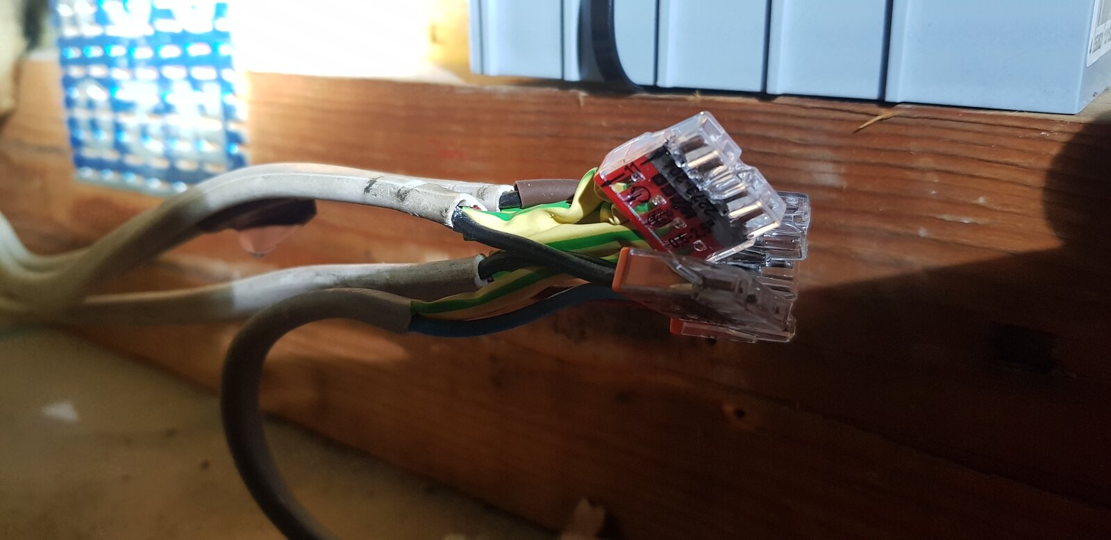

Bottom of joists drilled and taped up wagos
I see the oval conduit doesn't appear to have many (or any) nails holding it back.
Also not sure if it's set back enough to avoid plaster cracking.
Not an electrician, but i laboured for a good electrician many times.
He drill the joists in the middle to avoid weakening them, no matter how small the hole.
He uses maintenance free junction boxes if not accessible and wago boxes (screwed and secured with cable tie) when accessible.
He never used the filmsy connectors since wago came in.
He secures all wires (or conduits) regardless of where they are.

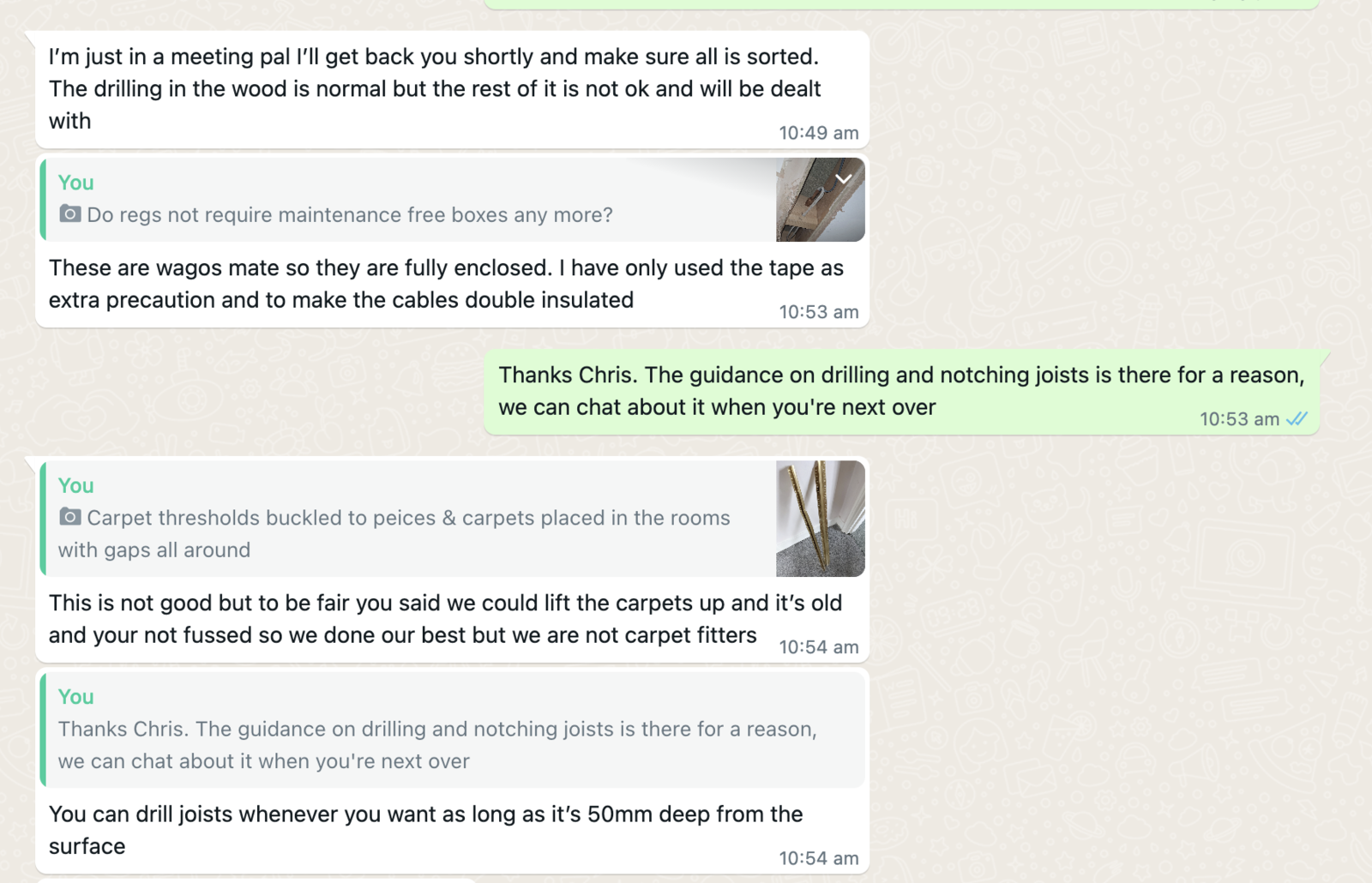

Unfortunately this is a reply I've recieved from the owner. It seems like I'm not going to be able to get through to him. What he is saying is just worrying to me.
What's the next port of call? NICEIC?
I also worry about the future work they need to do, and if I try to find someone else they'll think I'm an over fussy customer. Would a good electrician look at the work and know it's not up to scratch?

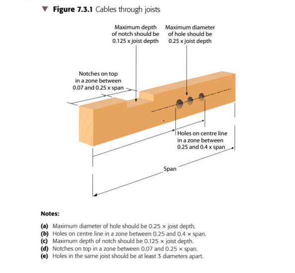

The holes being that close to the bottom of the joists will significantly weaken the joists.
Impossible to say that unless you know what the span is, the holes near the edge of the joists are well outside the influence of the bending moment diagram and whilst they will have a bearing on the ultimate shear value within this area, shear is usually more than catered for.
I take it that the boss and the person you spoke to are one and the same?
You need to show him the stuff I posted about where you can drill.
As for the Wagos, it is only MF rated if they are enclosed in the correct enclosure, fixed and closed with a tiewrap.
Tape does NOT form double insulation.

Indeed, that was the company owner. I've sent him a bunch of resources for him to learn from regarding the joists, but is this stuff not taught as part of training and tested with assesments?
It's even more frustrating that he won't admit the work isn't up to scratch. If he'd held his hands up I'd have been alright with him. But now I don't know what route to go down.
